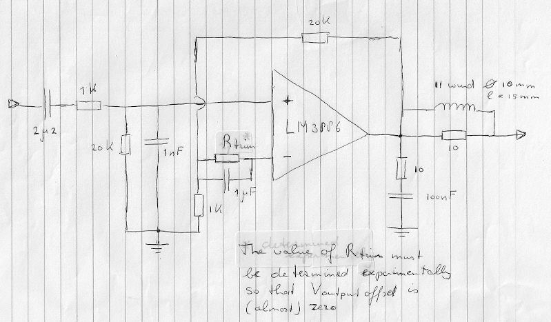

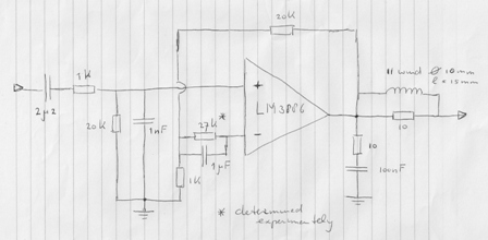

Hereby the schematic of the LM3886 without an electrolytric feedback capacitor. Such electrolytic capacitor may introduce distortion and therefor it is better to drop it.
But how to prevent a (multiplied) DC offset voltage at the output?
By inserting an extra resistor to the negative input, you can balance out the offset voltage. This extra resistor is short-circuited for AC signals by a capacitor, but this capacitor can be a MKT/MKP type of lets say 1 microF.
The value of the resistor is determined experimentely and I found 27 Kohm for one (see the schematic) and 18 Kohm for the other amplifier. The offset voltage is then only 0,9 milliVolt respectively 0,2 miliVolt !! This offsetvoltage doesn't run away through varied circumstances, like power, temperature etc.
I am very suprised that this method is not applied more often. Please give your comments.

Nice idea with some demerit. You simply made better symmetry of input bias currents paths. But the thermal drift of input voltage and current offsets will be still multiplied by 20. Electrolytic C makes this factor to be 1.
In your circuit I wouldn't put the shunt C at all.
Thanks ddd,
I do agree that the thermal drift of input voltage and current offsets will be still multiplied by 20. But how much will that be in reality? All the components are closely to each other on one chip.
I made the chip clipping and oscillating with a high voltage and high frequency input signal, so it got warm. Directly after that I measured the output offset voltage. The difference was in the range of less than 1 milliVolt.

1. The C shunt (in my schematic the C parallel to the resistor of 27 K) doesn't cause oscillations: on the contrary!
Of course I measured without the C shunt and then you see some overshoot on the edges of blocksignals of 50 kHz and more. With the C shunt the blocksignals have smooth edges but it doesn't change the slew rate. I measured almost 15 V/microsec.
If you put a high signal (more than 3 V p-p) which a high frequency (more then 200 kHz) on the input (without an input filter), the amplifier will clip. If you make the input voltage higher and higher, you force the amplifier to oscillate. The C shunt makes that the amplifier will oscillate a little bit later.
2. Indeed the data of the offsets are given in the datasheet within broad limits. In practice all examples of the LM3886 have different input offset voltages and currents. What you do is adjusting the value of the resistor (in my schematic the resistor with the value 27K) in such way untill the output offset voltage is 0,00 V. For one amplifier I found a value of 27 K and for the other a value of 18 K. The output offset voltage is then only 1 - 2 millivolt!! And this output offset voltage hardly drifts when the amplifier gets hot.
So with only this extra resistor and by - experimentely - adjusting its value, you can tune out the effects of the (differences in) input offset voltages and currents.

Indeed in the datasheet the input offset voltages and currents vary 10 times but that is between different examples. Within one example, the offset voltage and current will vary much less.
My experience is that the typical value applies to the most examples following the Gausse curve. See note 10 in the datasheet. The limit value is the guaranteed value for a single example. See note 11.
By adjusting the value of the resistor, you can cancel the difference between different examples.

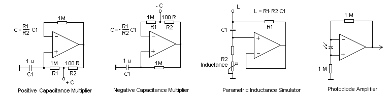

Say, while we are on the subject (hope that this is not thread hikacking), why don't people use a capacitance multiplier in place of the electro? The cap has a grounded terminal, so I believe that type of circuit can be used...
For example, substitute the terminal marked +C in the left most circuit in the figure in place of the usual grounded electrolytic, use a 1uF film for C1 and then select the resistor ratio to give you 100uF or 1000uF or whatever you need.

...why don't people use a capacitance multiplier in place of the electro? The cap has a grounded terminal, so I believe that type of circuit can be used...

I think it's mistake to try this.
The point +C has the offset of the new OpAmp, which could be significant (with 1MOhm resistors). And you connect it to very sensitive point, multiplying its DCV by 20. Instead of benefit you'll get harm. Not mentioning several new elements in comparison with simple resistor.
These circuits are gyrators (Wiki).

I am gussing that zeroing out any DC offset is a simple thing to do in the circuit, and as long as the capacitance scaling resistor is small compared to 1M the input impedances will be relatively well balanced anyway.
