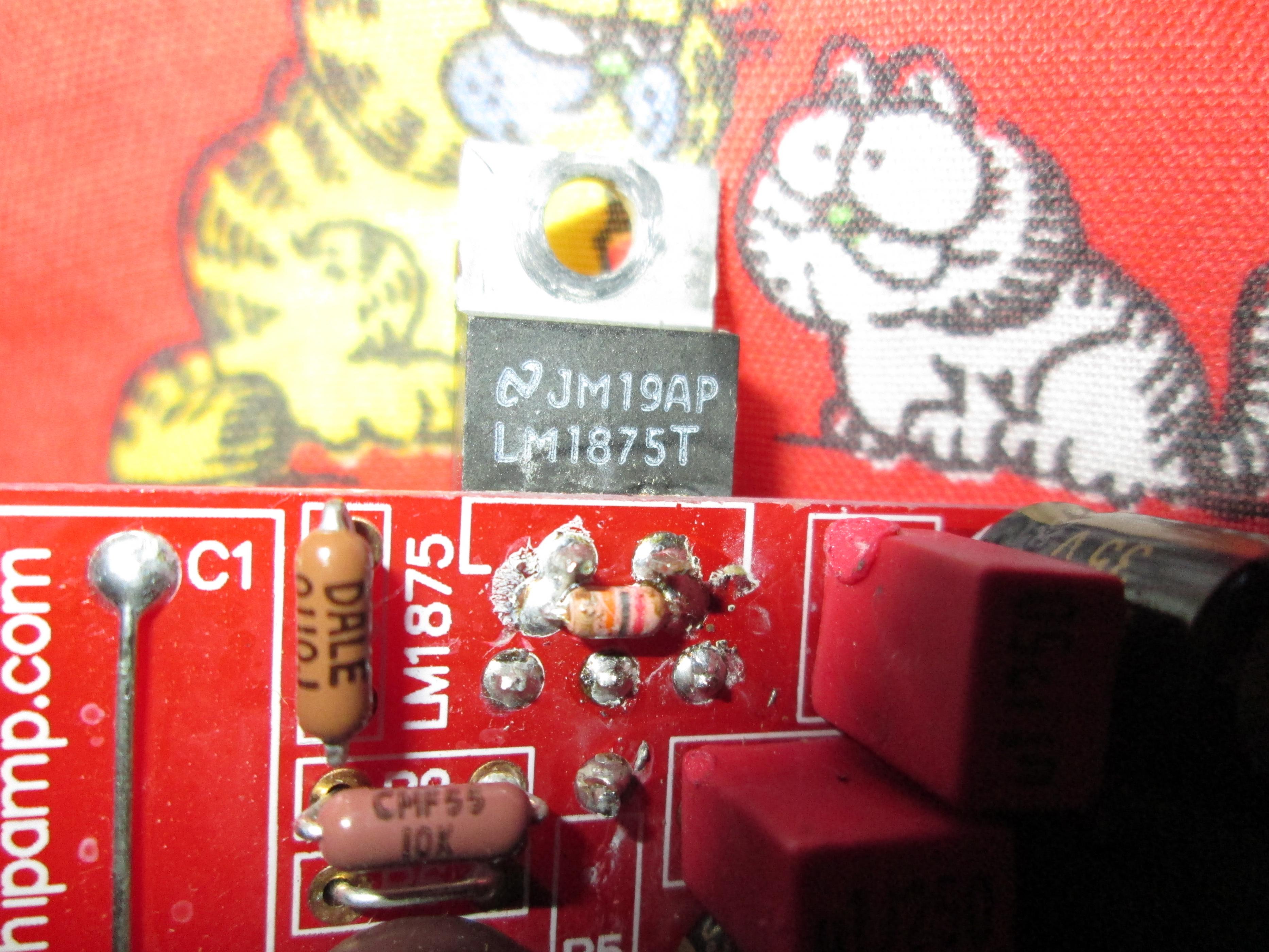

I'm going to go with 1875

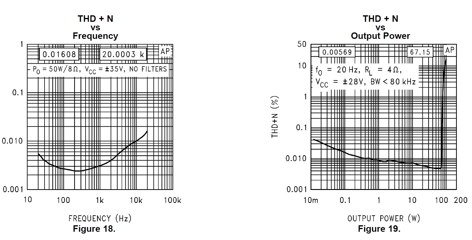

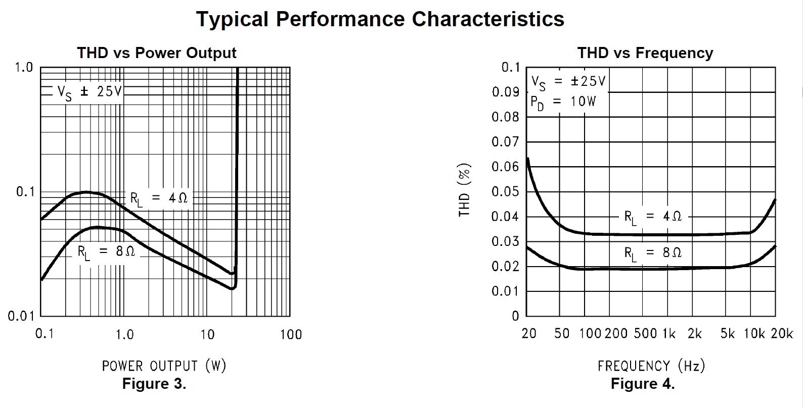

1) It has a different 'clipping' system than the SPIKE of the 3875/6, 3886, etc... Those in the know could say more...
2) It has more overall distortion than the others but it's flat over most of the audio range.
Vs the 3886, etc..., which has rising distortion over the audio range.
3) And given Tom's recent work with the 3886, we know how important it is to get the fb res close to the chip, with 1875 that's way easier. (especially if you get radical and put it right on the pins!, or shorten the pins ...)
And even with no fancy mute, the 1875 doesn't seem to generate much turn on/off pops/noise.

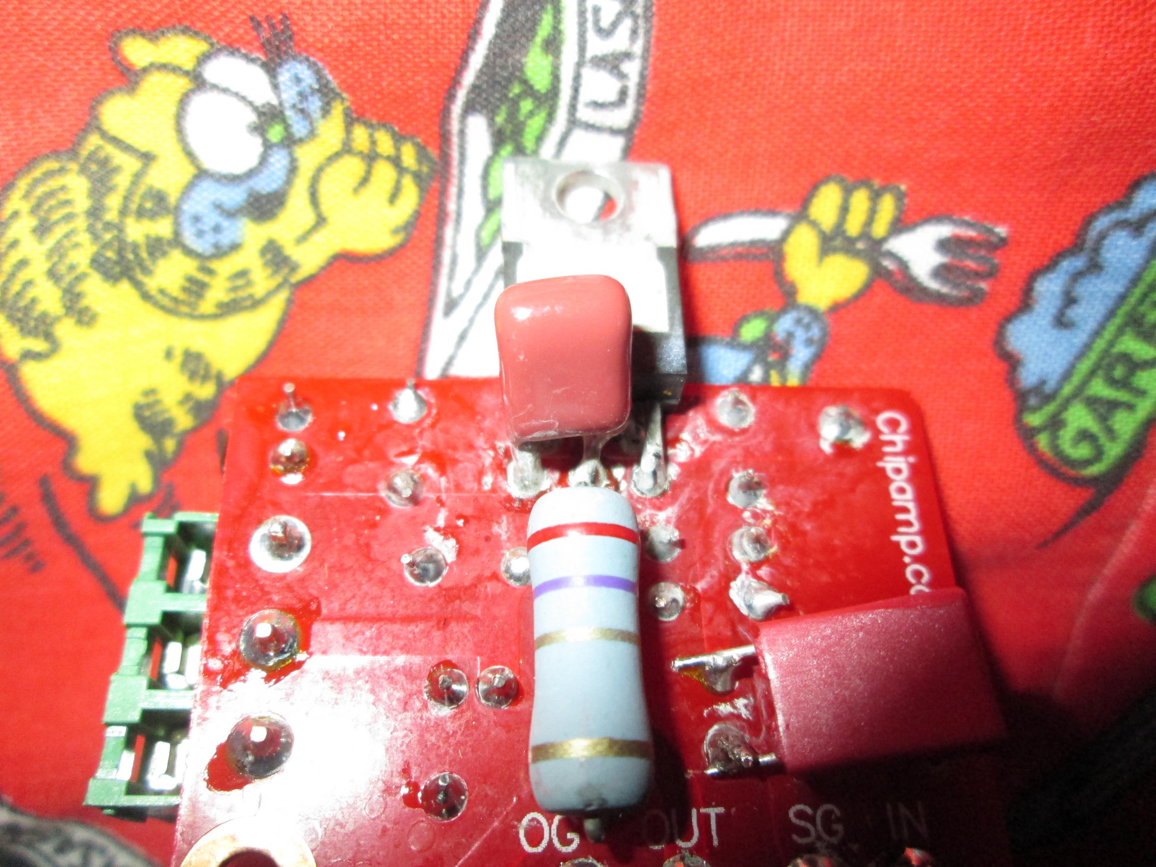

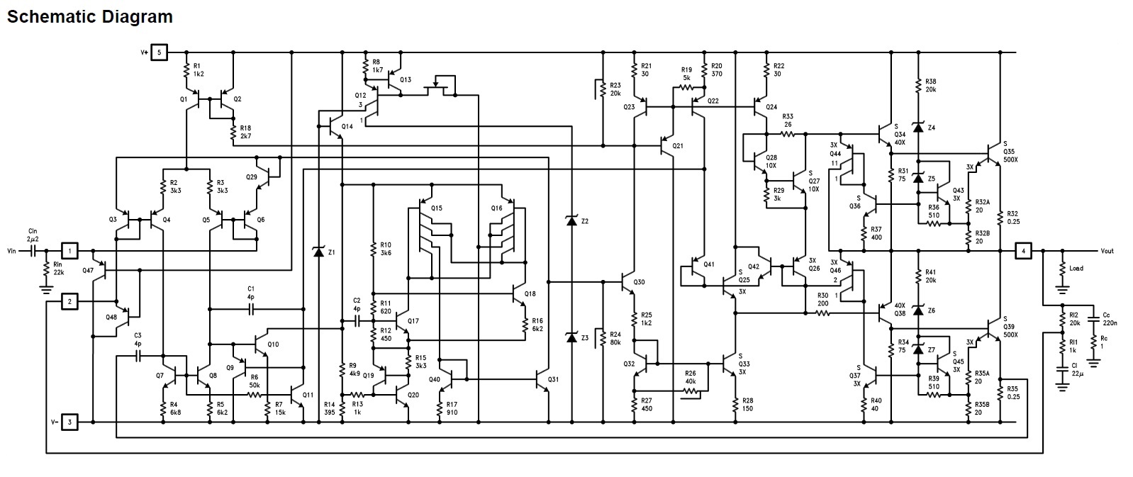

The FULL schematic!
I really like it!
In fact, you've inspired me to make some more! Hmmmm, where's that transformer ...

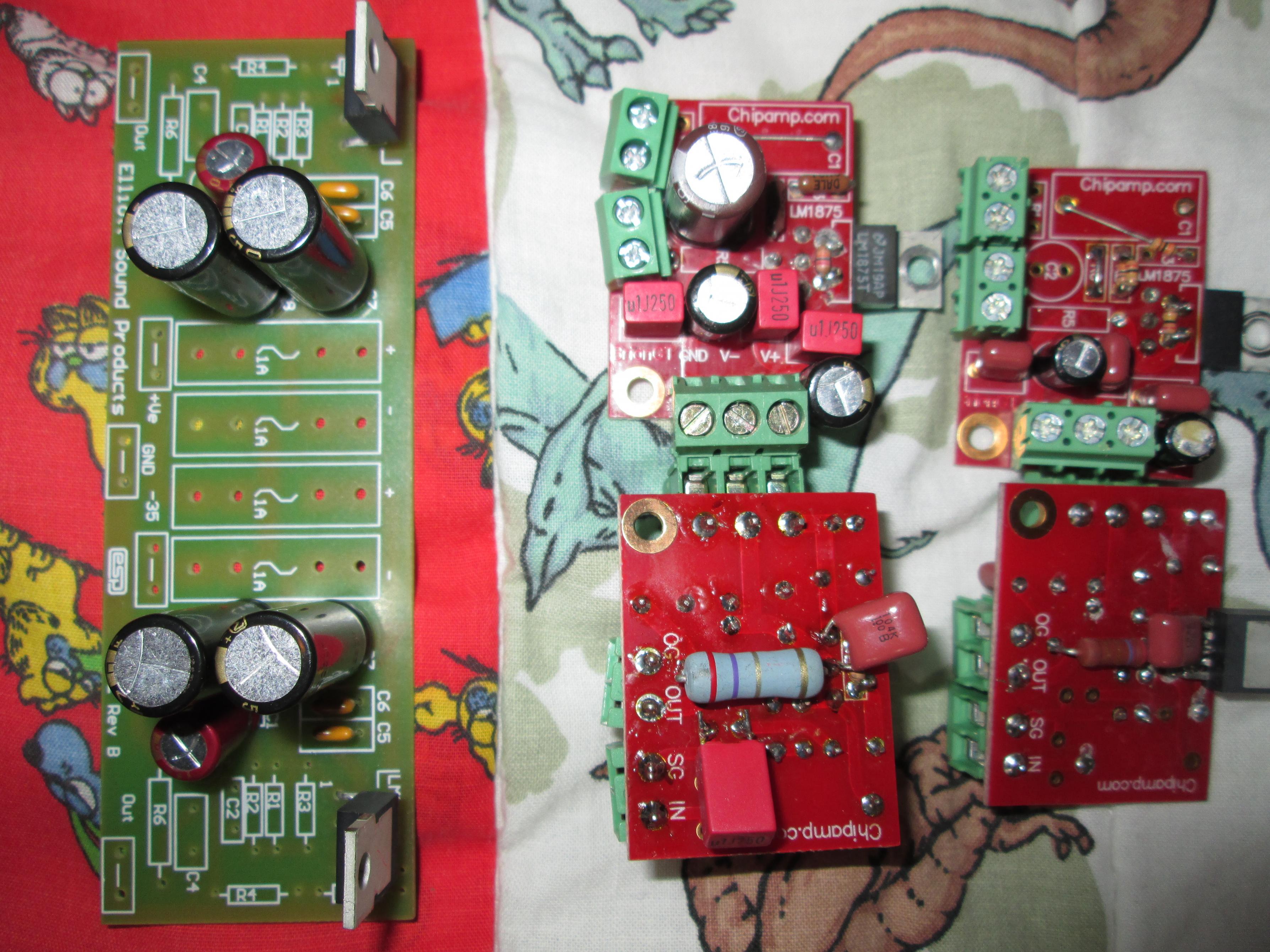

Thanks for all the replies. I think I have decided on the LM1875 (x2)!
I agree, very minor differences in circuits cannot possibly make up for a good enclosure. Simply opening up the speaker cabinet changes the sound a lot.
I'll probably use the ATX heatsinks in the beginning, see how they deal with the heat, and then add a fan(I love cooling solutions, fans, heatsinks etc. )

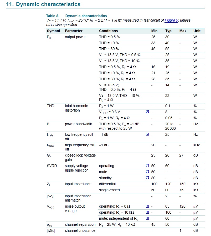

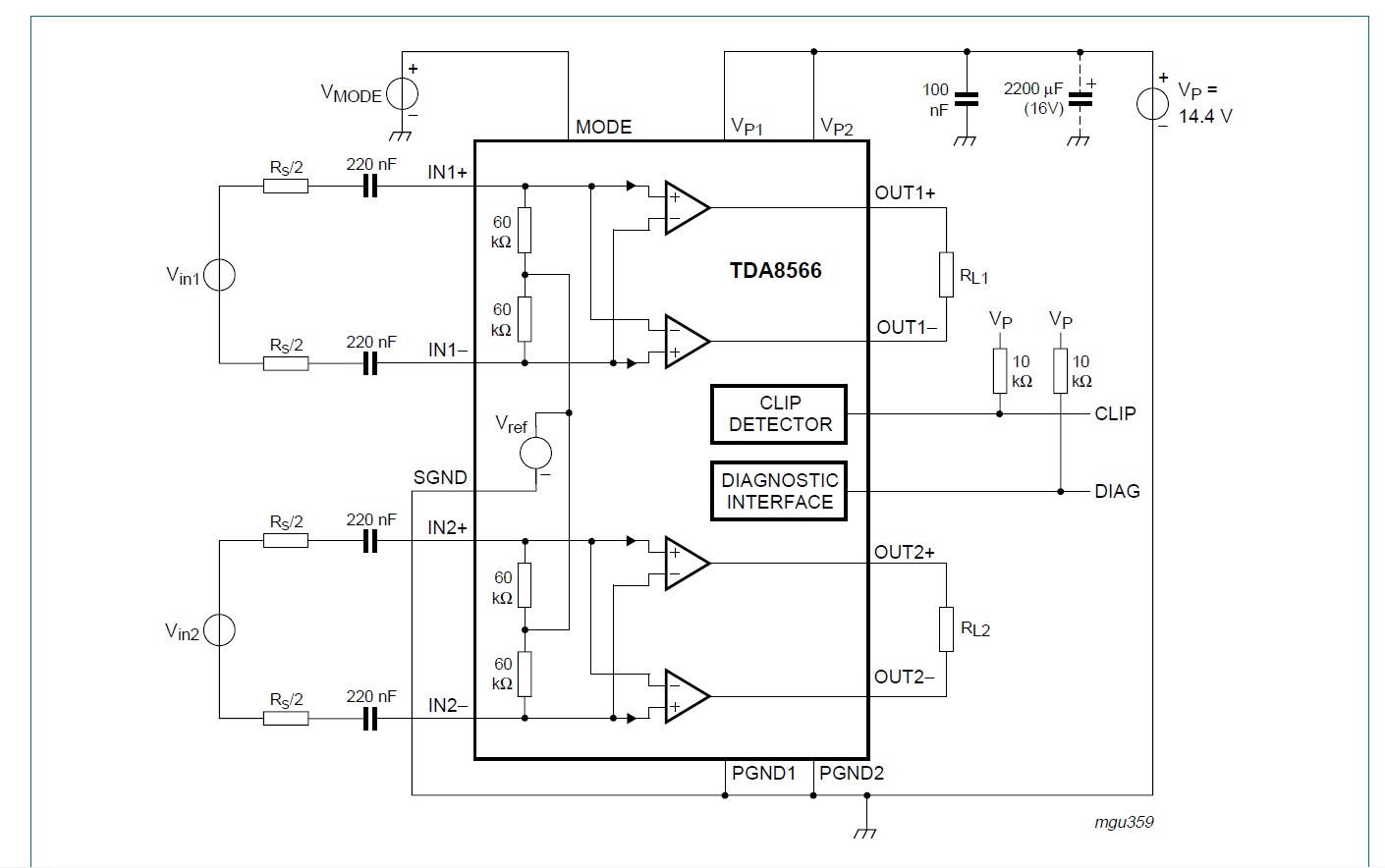

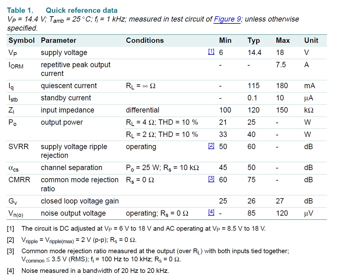

View attachment TDA8566.pdf
tell me more!
PS common mode cancellation with the inherent balanced connection ..
tell me more!
I have an example project for this chip on my blog - http://www.diyaudio.com/forums/blogs/abraxalito/960-high-end-chipamp-build-project.html
Also a thread with some pics of the crazy capacitor tower I built for it - Possibly the most frugal high-end sounding amp?
You already know about Barrie Gilbert's 'active feedback amp' ALD - seems the TDA is a relative of that architecture.
