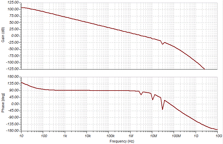

Yes, open loop measurement shows the 3886 model has 81 degrees phase margin and 32dB gain margin (details attached, though it's easy enough to do one's own). This is in obvious disagreement with the open loop figure on page 16 in the datasheet so I don't think the model is going to be very useful for this discussion.
One can, in principle, stabilize a 3886 at unity voltage gain via noise gain compensation. Refer, for example, to part 8 of Tim Green's series on op amp stability. The noise can be lower than the more popular approach of using a voltage gain of 10-20 but the required feedback capacitance ends up on the order of 10pF. This is quite difficult for the typical DIYer to hit, much less with the accuracy needed to maintain a 20dB/decade rate of closure over the part's GBP spread. Even with a good PCB fab and surface mount parts it's not something I'd try for; too easy to end up off by several pF due to stray capacitance on traces or the 3886 package's pins.
An easier solution is to operate the 3886 at 26dB local gain (or whatever) for stability within a composite amplifier with a global gain of unity. This is the same basic idea as the attenuation approach proposed earlier in this thread but with better error correction due to the global feedback---this fixes the 3886's poor small signal THD, delivers a noise gain of 2 instead of 21, and limits the output's DC offset to the controlling op amp's input offset.
