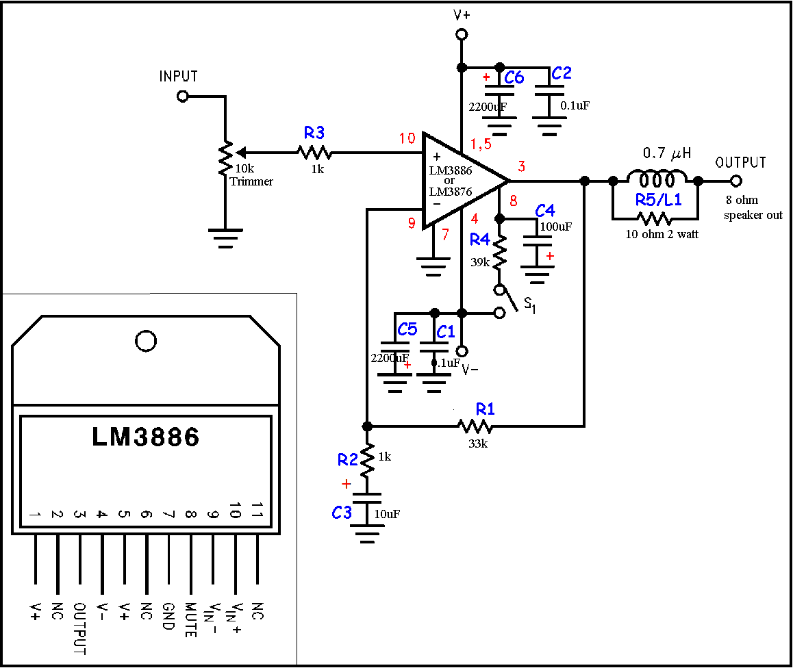

I recently (today actually) built an LM3886 gainclone, and it worked fine, uintill the output shorted to ground. Now it doesn't play anymore (no magic smoke or explosions) just silent...It's supposed to be short-to-ground protected? What could be the problem?
Here is the schematic

The specs for output short circuits is based on very short periods.If the short lasted for long ,then the chip is definetly damaged.
No. Read the data sheet. The LM3886s protection is designed to keep it alive under a short circuit fault condition (if it will only protect it for 0.5s then it isn't short circuit protected) and is tied in with the thermal protection to make sure that the device doesn't over heat whilst under the fault too.
Personally I am with Andrew on this one. A limiter built into the chip isn't going to fail to protect it unless something else was amiss. The short could have very well triggered an oscillation which could have quickly fried something.
I did mention that if all is well on the circuit board then the device failed.
Here is a quote from National's Application Note 898 (John deCelles, 1993)
One note to make about this protection scheme is that the
current limitation is not sustained indefinitely. In essence, the
output shorts to ground or either supply rail should not be sustained for
any period of time greater than a few seconds. .
