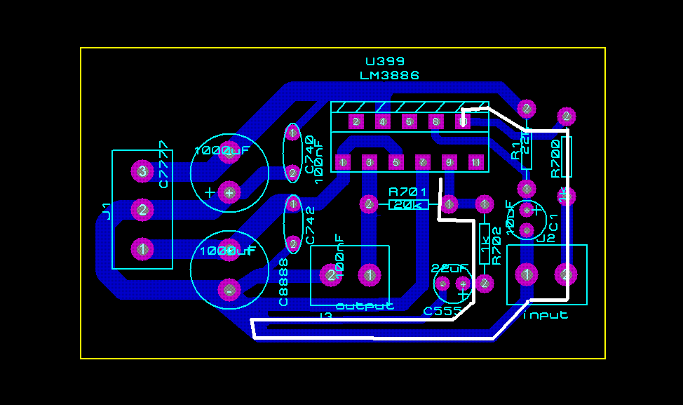

Are you aware that an aerial that picks up interference is a loop?
Now start at PIN9 and follow the traces and components: to R701, to R702, through R702, to C555, through C555, to star ground, to Input PIN1, to PIN2, to R700, through R700, to PIN10.
Now shade in the area enclosed within that route.
That is your loop area. That is your aerial picking up interference.
You must make that group of components and traces and pins as small and as compact as possible and try to minimise the loop area.
Repeat for the output.
Repeat for the Zobel.
Repeat for the PSU rails.

Yet I do not have a good point of view about the aerials which make LOOPS!
I did know that the inputs can act as an aerial if the input wire/trace happens to be long. But yet I have no idea what you do mean here.
Plz take a look at the WHITE sign here in the below pic and let me know if I have drew it the right place to show the aerial loop you are talking about?
P.S is the aerial loop defined just for INPUTs?

Regarding the optional components actually I want to makes a prototype based upon the schematic in the datasheet and then I will improve it and add the optional components just if needed.
Shouldn't the PCB provide the space for all those components then? Or will you let the additional components dangle about in free air?
Those 1000 µF capacitors look pretty small. Do they have sufficient voltage rating for that amp?

RF attenuation is omitted.
Very easy to correct: add a parallel cap across R5 either on top of the PCB, or underneath the PCB.
Output Thiele Network is omitted.
Very easy to correct: remove the output terminal block. Connect the Zobel capacitor in the spare location.
Tap off the speaker output from the top end of R1.
The other half of the Thiele Network (L//R) can be mounted offboard in the line that joins the amp PCB to the speaker terminals fitted to the chassis.
The speaker return connects to the Main Audio Ground, not to the amp PCB.
Finally,
check to see how R5 and C4 are connected to Signal Ground. They must not connect to Power Ground on the underside of the PCB.
