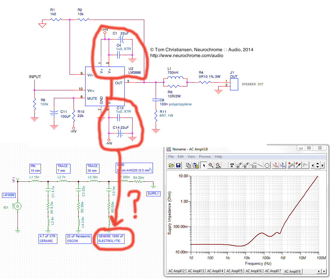

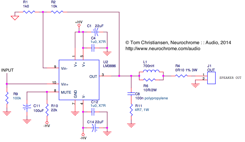

Are the schematics below the final/best schematics for the tamed LM3886?
I should probably get a parts list together.

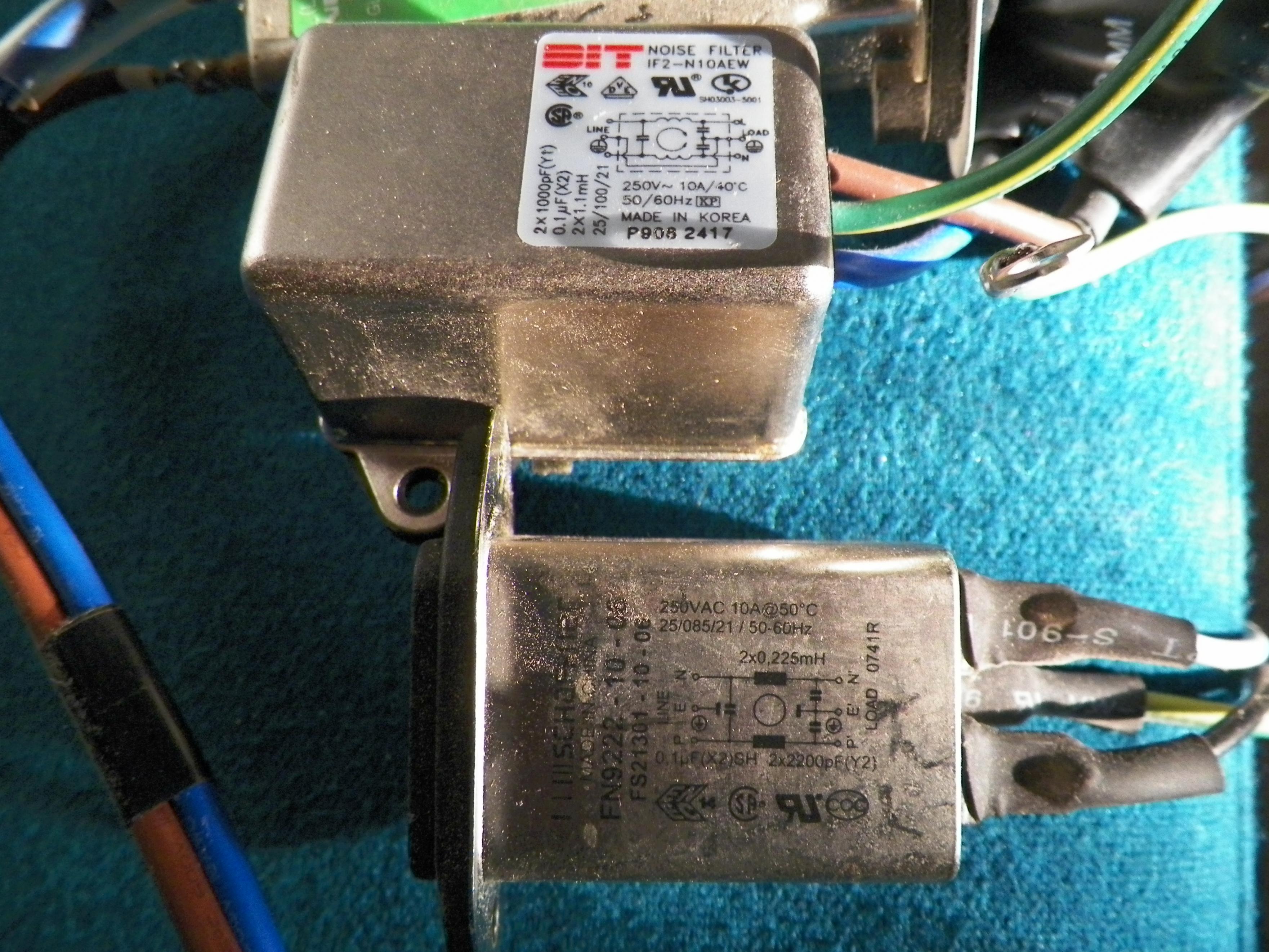

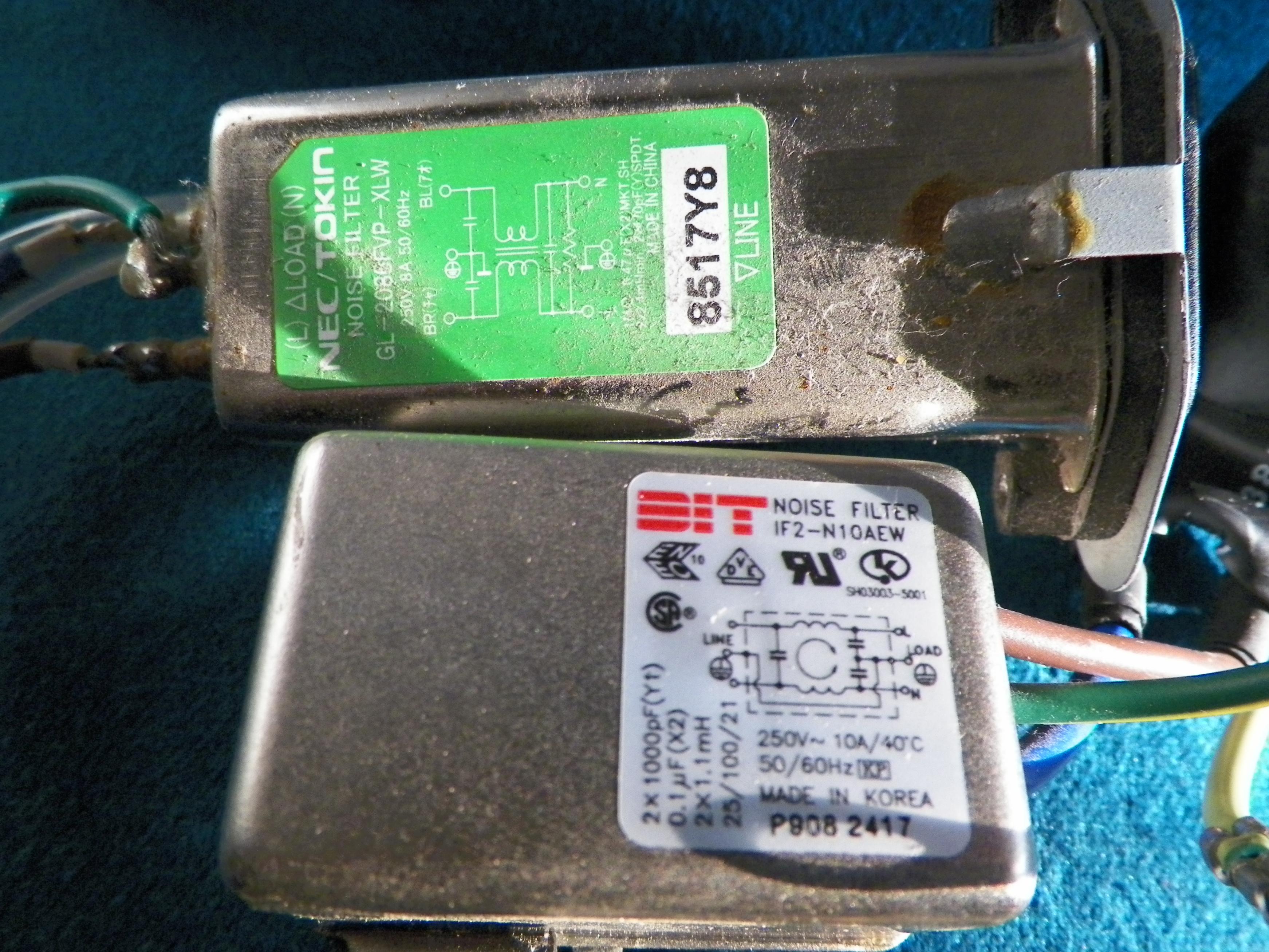

Are any of the 3-prong plugs below of any use? They look like they have "snubbers" on them and inductors and then some pass the wires through some kind of doughnut (forgot what those are called).
there's no power supply schematic attached, just a decoupling schematic and the audio piece.
Jimmy: Yes. That's the latest schematic for the amplifier portion. I didn't do anything special for the supply.
To get the best performance out of the LM3886, you need to pay attention to the inductance of the ground nets. In particular, in the feedback and input ground reference. Use ground planes, properly.

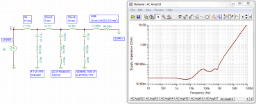

XR7 resistors? You mean the X7R capacitors? Have another drink... :) :cheers:
The 4.7 uF X7R modeled in TINA-TI was replaced with a 1 uF X7R in the actual circuit, as Mouser didn't have the 4.7 uF in stock. You should be able to recognize the 22 uF OSCON. The 1000 uF generic electrolytic can wasn't included in the LM3886 schematic. I assume that the reader has enough knowledge to read the LM3886 data sheet and include a sizable (470 uF or above) bypass cap at the power entry to the board.
