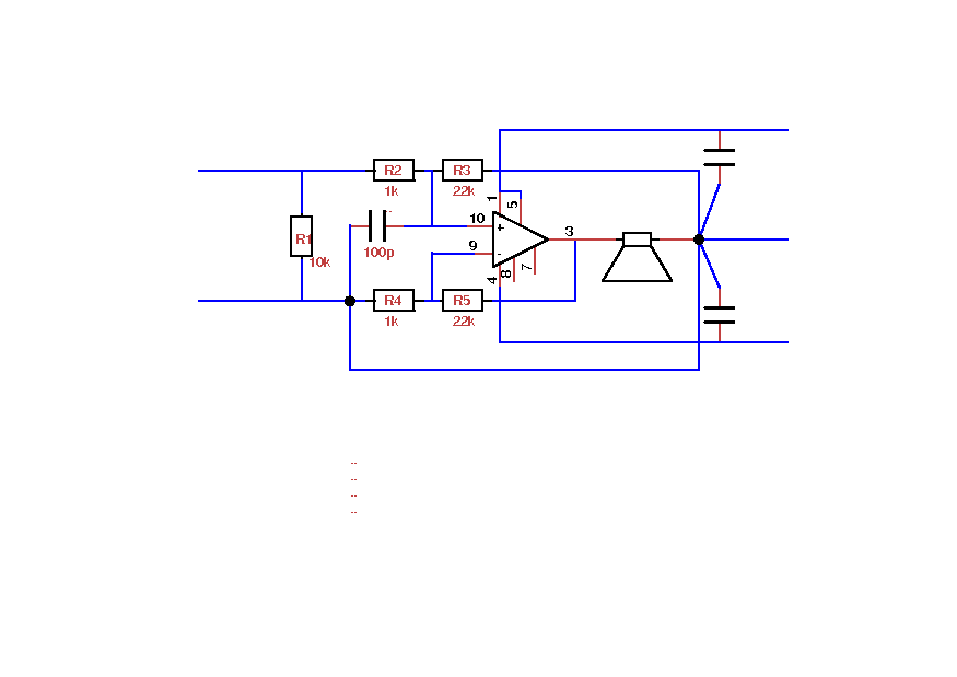

Bruno "The Man" Putzeys wrote a very interesting article in Linear Audio entitled "The G Word" where he strongly advocates the use of opamps as difference amplifiers.
For example, in this schematic :
Differential amplifier - Wikipedia, the free encyclopedia
You would wire :
The two inputs V1 and V2, to audio input "hot/cold" (input connector signal and shield if RCA)
Out to loudspeaker "+"
The "GND" symbol in the schematic is actually a ground sense input, wire it to loudspeaker "-"
Note this makes your amplifier inverting, which is a Good Thing (it eliminates common mode distortion in the input stage).
However, you need precision matched resistors for good CMRR. Fortunately :
DigiKey provides
And the driving source's output impedance is part of the CMRR. So you need a buffer. This is equivalent to making a 3-opamp instrumentation amplifier with the LM3886 as the output opamp. If you put, say, a DAC, or a preamp, inside the same box as your LM3886 amps, this comes for free, though. Since most DACs have balanced out, usually followed by a differential to single ended filter/conversion, if you fancy digital volume control, you can delete the final opamp and replace it with LM3886...
Then, GND noise is reduced in the output by the CMRR of the whole thing. Even if it's only 40dB, it is still 40dB better than star ground...
Using differential circuitry is a good way to avoid ground issues for sure. However, note that if you are using regular ±5 % or even ±1 % tolerance resistors, the resulting CMRR is actually not very good. ±1 % would result in 40 dB of CMRR. That's better than nothing, but far from stellar. For input buffers, I would use one of the dedicated differential receivers such as the THAT1200-series.

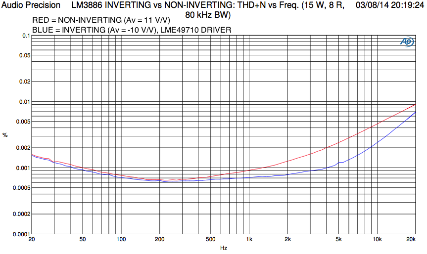

There's much drama about inverting versus non-inverting. Some go as far as indicating that if the LM3886 is used as a non-inverting amp, it will basically be useless. I strongly disagree.
First off, the difference in THD between the inverting and non-inverting is practically negligible (see attached results - I measured this using an AP SYS-2700). Secondly, the resulting low input impedance of the inverting configuration means that the amplifier will need an input buffer. Now the designer will have to manage the grounding between the op-amp buffer and the LM3886. As we know, there are many ways to screw that up.
My recommendation is to use a non-inverting LM3886 unless you have the design skills (and test equipment) to do the job right (and verify your work).
DigiKey provides
Ouch... So for $7.50 I get to build my own diff amp. Even I somehow managed to get the layout completely matched, I'd still only get 66 dB of CMRR as the resistor matching is "only" ±0.05 % (that's actually quite good).
...or I could spend $5.55 on a THAT1200 and get 90 dB CMRR.
Mmm, y'all might want to look a little closer. Difference amp CMRR is proportional to gain (see equation 3) so with the ORNTA array you link the basic result would be 86 dB CMRR min. Which is functionally equivalent to the 90dB CMRR typ of THAT's tightly trimmed parts. The lower impedances in the ORNTAs may result in more temperature related degradation (a 5 ppm tracking TCR is a 0.005% matching error per degree C, so it doesn't take much Joule heating to degrade 0.05% matching) but THAT does not specify this characteristic for their parts. So one would have to measure.
A more flexible design option is 0.05% and 0.1% Susumu RG resistors, which are cheaper than ORNTAs but lack a tracking TCR guarantee. Both are most commonly available in 25 ppm TCR. So, given the tight layout needed to not faff up the difference amp's impedance matching, one can probably manage enough thermal coupling between, say, 0805 RGs to do better than that. Wouldn't count on getting Vishay's guaranteed 5 ppm tracking TCR or THAT's likely comparable tracking.
With either of these options implementing the input buffer of the three op amp instrumentation formed with the power amp difference amplifier is nontrivial. A goodly number of audio op amps aren't specified for input impedance and, among ones which are, often no indication is made as to whether it's a common mode or differential specification. National, er, TI's LME497xx series is an exception at 1M common mode. Which, if you put them to the same test cases THAT uses, is 70dB CMRR. At which point, well, 0.5% Susumu RR resistors in the diff amp around the chip amp are pretty well good enough. And they cost maybe an extra cent each. One can JFET on this or copy THAT's bootstrap circuit but, as tomchr points out, the 10M input impedance of the THAT 1200 family offers excellent value here. The AD8421 is one of the few dedicated instrumentation amplifiers suitable for audio use. Its B grade does beat the 1200s but runs around a 60% cost riser and is harder to front with an RFI filter.
However, for the integrated DAC and power amp cases you mention parts like the THAT 1240 are perhaps more interesting. They're cheap for the resistor matching and performance you get and most such applications want the differential DAC output to single ended power amp feedback loop a difference amplifier provides. In particular, THAT specifies the 1246 at 90dB CMRR typ with a -6dB gain. So, if one hooks it up backwards to get 6dB gain off a DAC output, it's 102dB CMRR. If extreme sports are your thing implementing the DAC analog lowpass filter and laying out the DAC+chip amp PCB to realize that performance is a very interesting challenge.
