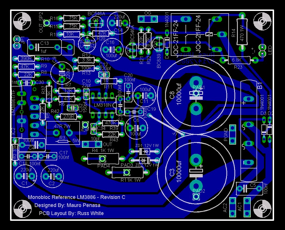

Recently I have met one of my friends who owns MyRef Revision C of LM3886 amp, and I was totally surprised with sound quality. Tried then in the local market for the same pre-assembled one, but had no luck.
After going through this forum, got enough confidence to build it by my own. I am not a electronics graduate, however I know the basics of electronics and how analogue electronics works. [Between I have assembled few amps before using the pre-assembled chip boards, I know that is not enough to excel in audio electronics].
Now my requests to everyone are-
1. Is there any well designed PCB layout and its BOM of MyRef Revision C available so that I can make a board out of it.
2. Or else, please refer any shops which are located in Bangalore, India.
3. If MyRef version requires a pre-amp (probably with tone controls), please suggest a good design which do not degrade sound.

The only problem at the moment is finding good PCBs for the REV C. I used Siva's (Linuxguru) 1.4 boards, but they appear to be no longer available. The only other option I know of is
2pcs DIY LM3886T LM3886TF diyAudio My Reference rev.C Power Amplifier PCB Board
I can't vouch for the quality, but they might be worth a try.
Those eBay boards are a knock-off of Linuxguru design, I would feel really bad buying those.
If you want a through hole design, in the orignal My_Ref thread Russ White posted Eagle files of its design.

I believe that this is the information Russ White posted concerning his single sided PCB design (the original link is now dead). Apparently this design was prototyped and tested. but never widely used, due to the development of a double sided option.
  • monobloc_rev_c_silk.pdf
  • monobloc_rev_c_copper.pdf
Apologies for the late reply.
Thanks a lot Naaling for sharing for the PCB layout. This is something which I can get it done without much complexities. .
