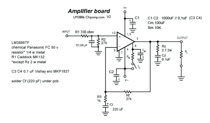

Oups, it's my fault, one folder on my server was deleted..
Picts of preamp with Tocos and pre att :
Missing picts on old mess :
I did not have, a quick draw :
But, after I add preatt (-7 db) directly on connectors amp :
If my note is right : Rs 15K and Rp 22K, and using same preamp (but without resistors att).
Resistors are Takman carbon.
Phil.
Phil.

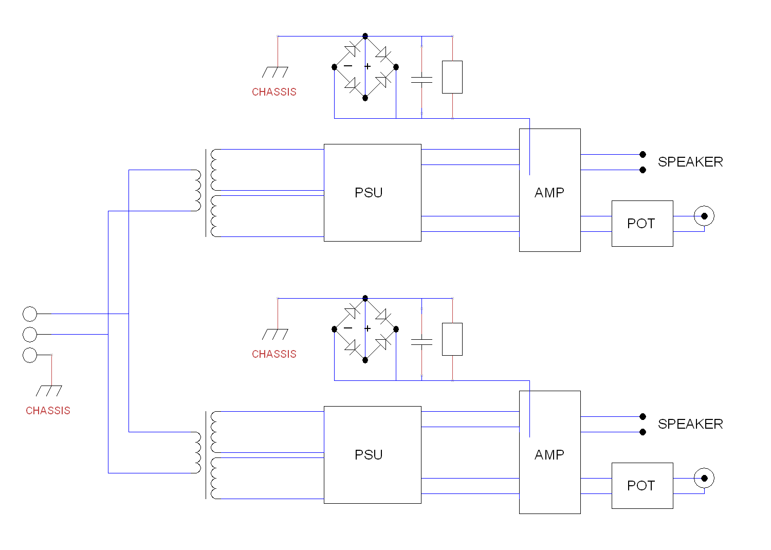

Some questions
Hi Phil,
If you don't mind I have two questions for you...
This afternoon I finished the upgrade on my Chimp.com boards. I mounted the items mentioned in your thread.
The sound is GREAT! wow I did not expected this much change.. But with this upgrade came a Huge Thump when switching the amp on and of...Did you experienced the same or do you know what this could be?
The second things that I had a groundloop when connecting my balanced DAC (with RCA's). So I installed the Groundloop Breaker mentioned in your thread..
When I connect this breaker back to the chassis my isolated RCA connector do make contact with the Chassis again...is this right?
I ask this because I have enormous problems reading (even simple) schematics (long story) this problem became a big problem when I saw that the layout on the bridge rectifier is different to the schematic...
So I made a quick drawing of the original circuit (top) and my own version Bottom.
I would be very grateful if you could look at it... forgive me this probably simple questions
Raymond

Hi Mark,
Thanks for the schematic. Maybe I see this wrong but since the RCA outer ring is connected to the ground plane of the PCB and the PCB is connect thru the resistor to the chassis there is still a connection? (The bieb on my multimeter says the same...) So the isolation on the RCA is lost?
Again forgive me, somehow this is not landing in the right spot or something like that..
The RCA return and the chassis are connected via the resistor and diodes. The resistance is low enough for the DMM to still indicate a connection, but high enough to reduce the currents racing around the ground network.
Post a photo of your build if you want conformation.
Well done Mark.Here is the schematic that I made for Philfr. It also shows the different ground connections to the chassis.
post94,
You show pairs of Flow and Return wires between each module.
I count 17 pairs in that drawing.
How I wish everyone would do the same.
Much of the "ground" loop problems just do not appear if everyone rigidly stuck to using PAIRs of Flow and Return wires for interconnections.

I draw all about safety loop breaker :
RCA sockets are isolated ?
Please post picts when you are ready.
Phil.
PS : see post one for complete schematic :
