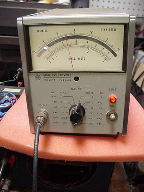

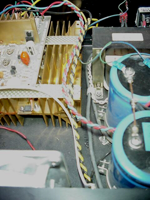

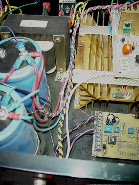

I measured 430 uV RMS at the output of this amp. The HP 3400A true RMS voltmeter, 10 Hz to 10 MHz and a crest factor of 10.
The DC power supply wires are twisted; the 120 AC wires are twisted and shielded. The wires form the bridge to the caps were not twisted, but it’s a good idea to twist them also. The RCA jacks are isolated form the chassis and are connected to the amp with shielded cable. The AC switch fuse and transformer input connections are in the same small area.
An amplifier input noise can be measured with a test setup using a gain of 1,000, the reading is divided by 1,000 to get the amplifier input noise. Using my Opamp test fixture, I measured a LM3875 input noise of 1.4 uV RMS. In audio power amplifier data sheets, such as LM3874, the amplifier has a gain of 20. Therefore, the amplifier noise will be 20 x 1.4 uV or 28 uV RMS. Any additional signal at the output of the amplifier is a result of noise or him induced by the wiring and/or layout.
