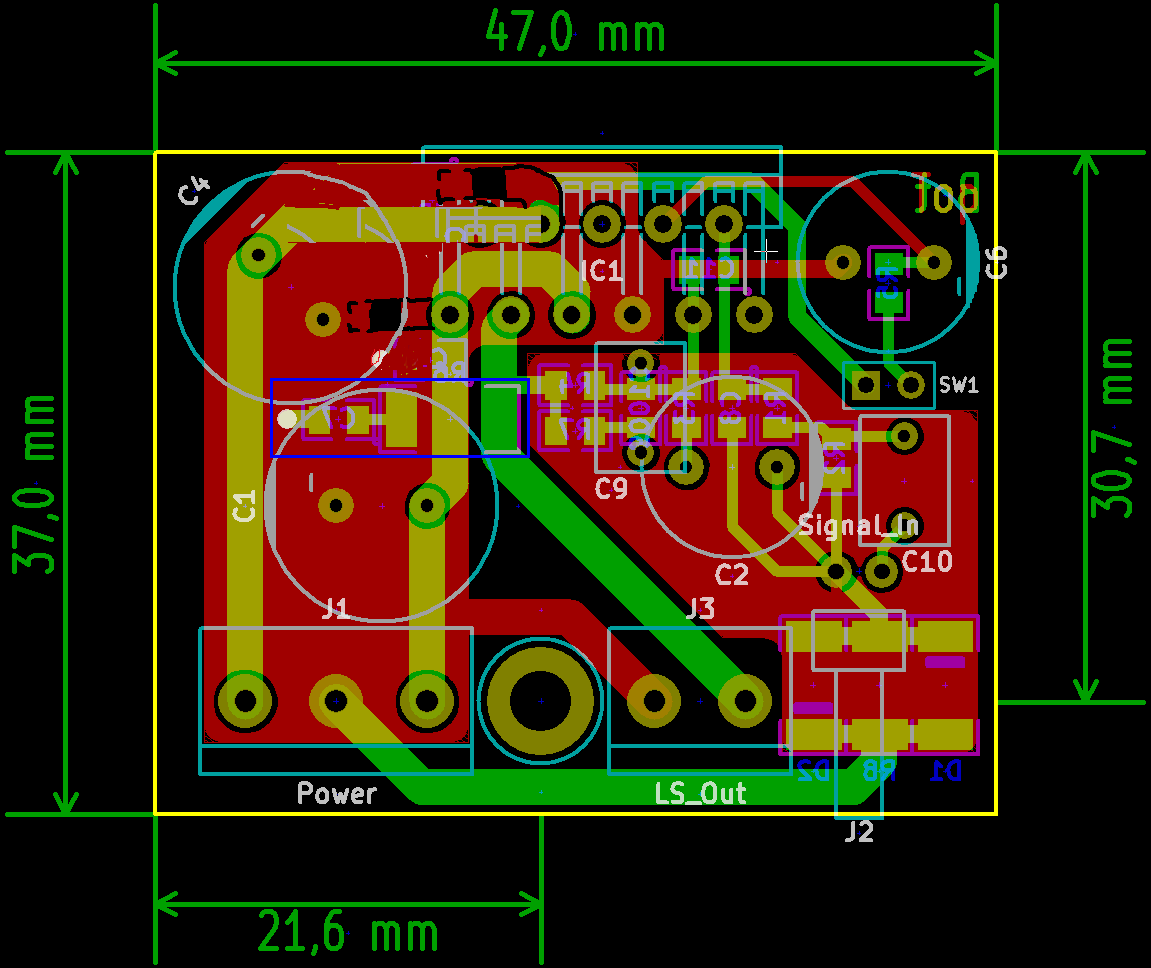

Yes, the output Zobel is located under C1.
A MELF resistor connecting at the output trace and crossing the V+ trace, and a 0805 capacitor.
I have marked it (blue rectangle) in the attached picture.
Is the placement ok?
I moved down the row of SMD parts for about 1.4mm, to make room for an alternative footprint for C9 (Cf).
Stupidly, I didn't find any SMD capacitors in the 50pF range other than ceramics (C0G or NPO).
So, if I want to use a foil type for Cf, I will have to pick a THT part.
But I could move the other parts back upwards, where they were before.
Would that be better?

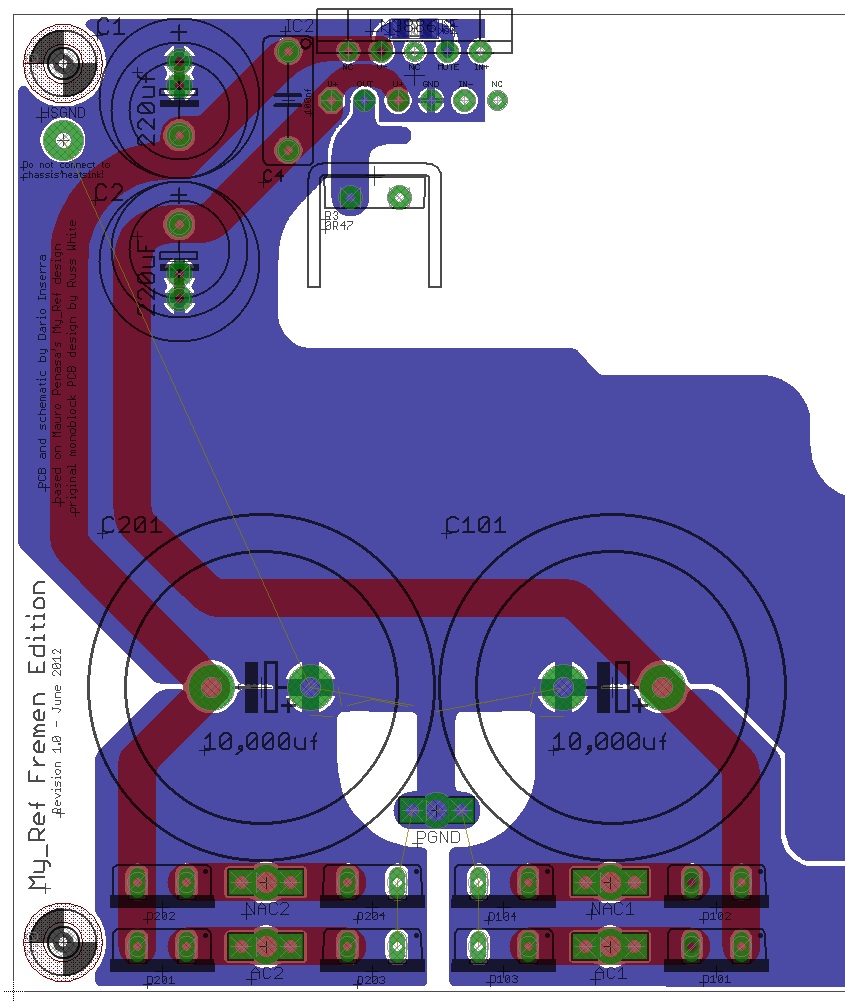

I initially planned to use the unregulated CarlosFM design and read the whole thread about it.
But then I came across the explanations of Rainwulf here on page 65: http://www.diyaudio.com/forums/chip-amps/43423-high-cap-unregulated-psu-chipamps-65.html#post1761186
This sounds very reasonable for me, so I think I will follow these guidelines.
It's really-great to hear that you have seen the light, in Rainwulf's excellent post! If I remember correctly, everything he said was exactly accurate and he is thinking about all of that in exactly the right ways. His post was very gratifying to read, because I have been trying to emphasize almost the same points, over and over, in this forum.
One thing that I can see that might make a significant improvement, if changed, is the local reservoir (decoupling) capacitors' configuration. The suggestion is to change the PCB area they occupy, slightly, to basically make two power planes on one side of the board and a single ground plane on the other side, and populate them with many smaller caps instead of just two larger caps, while keeping the total capacitance about the same.
This would provide several significant benefits, including lower PSU impedance (perhaps much lower) as seen by the chip's power pins, at every frequency, as well as a type of averaging and redundancy that would make the circuit much more robust against future variations in capacitor parameters. It would also increase the lifespan of the capacitors, since a larger number of smaller ones will have more surface area than one larger one, for the same total capacitance, so they will run a little cooler. Also, with smaller caps, you will be able to get some of them even closer to the power pins, which should be one of the highest-priority goals, since it reduces the inductance and resistance of the connections. (And even if you DON'T switch from one large cap to many smaller ones, you should STILL try very hard to get at least a few smaller electrolytics MUCH closer to the power pins.)
Just thinking out loud about paralleling caps: If you used n caps in parallel, even if they were all n times farther away than the original single larger cap, you could, roughly, still divide the total inductance and resistance each by n, and would have n times as much as each one's capacitance, while also NOT increasing the total conductor self-inductance or resistance at all! That would be wonderful but it gets even better. Since the n caps are each much smaller than a single large equivalent-value cap, it's extremely likely that the average connection length would be significantly LESS than n times as long, for n capacitors. So the total connection self-inductance would also be significantly reduced. i.e. There is no "downside", only significant benefits, piling on top of each other.
Actually, the same should be done for the power supply reservoir caps, which should basically be right next to the amp, too, if possible.

The two grounds are already separated by a resistor (R8) and two anti-parallel diodes (D1, D2). The connection point is located in the lower right corner, right from the output terminal, and under the input connector.
Now I see it! Fine :)
Interesting, as I think about it, I'm more concerned about the Zobel resistor picking up noise from the V+ trace and leading it back to the feedback input.
What about if I rotate the Zobel by 90°, so that it would go downwards instead of left?
I think it would be better.
Ok, I will cut the plane over the output trace.

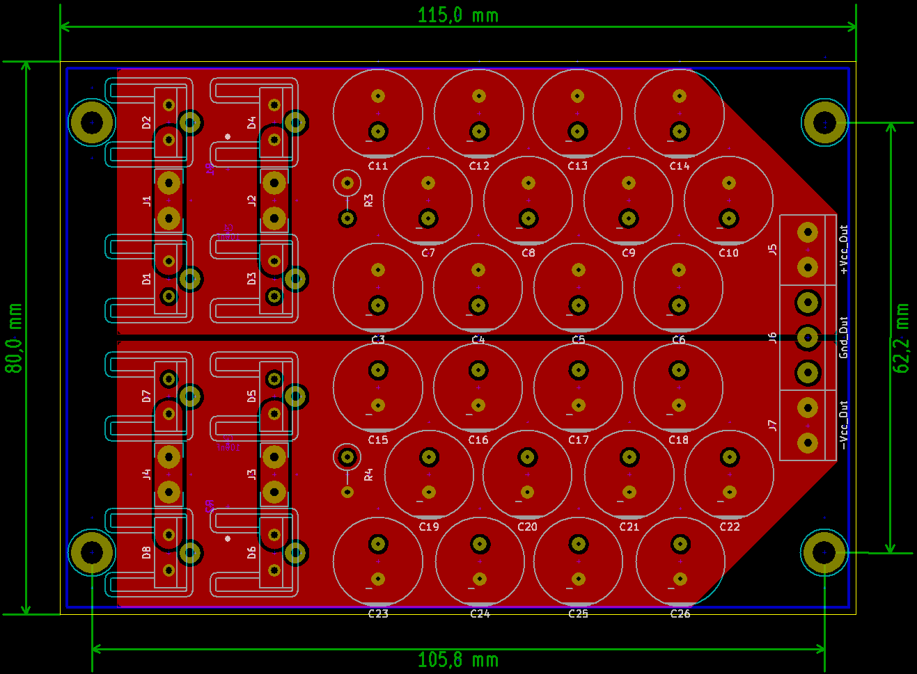

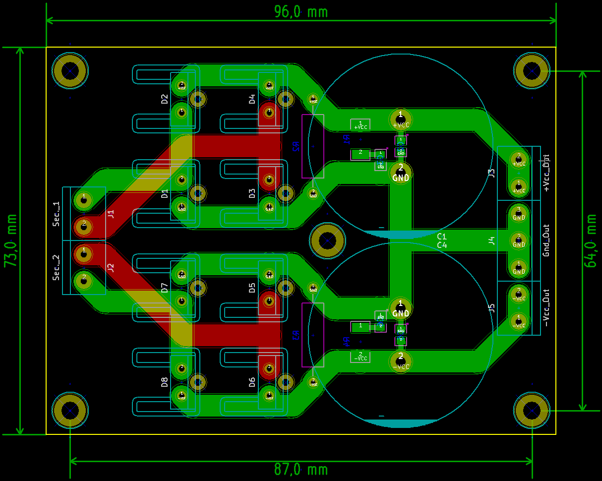

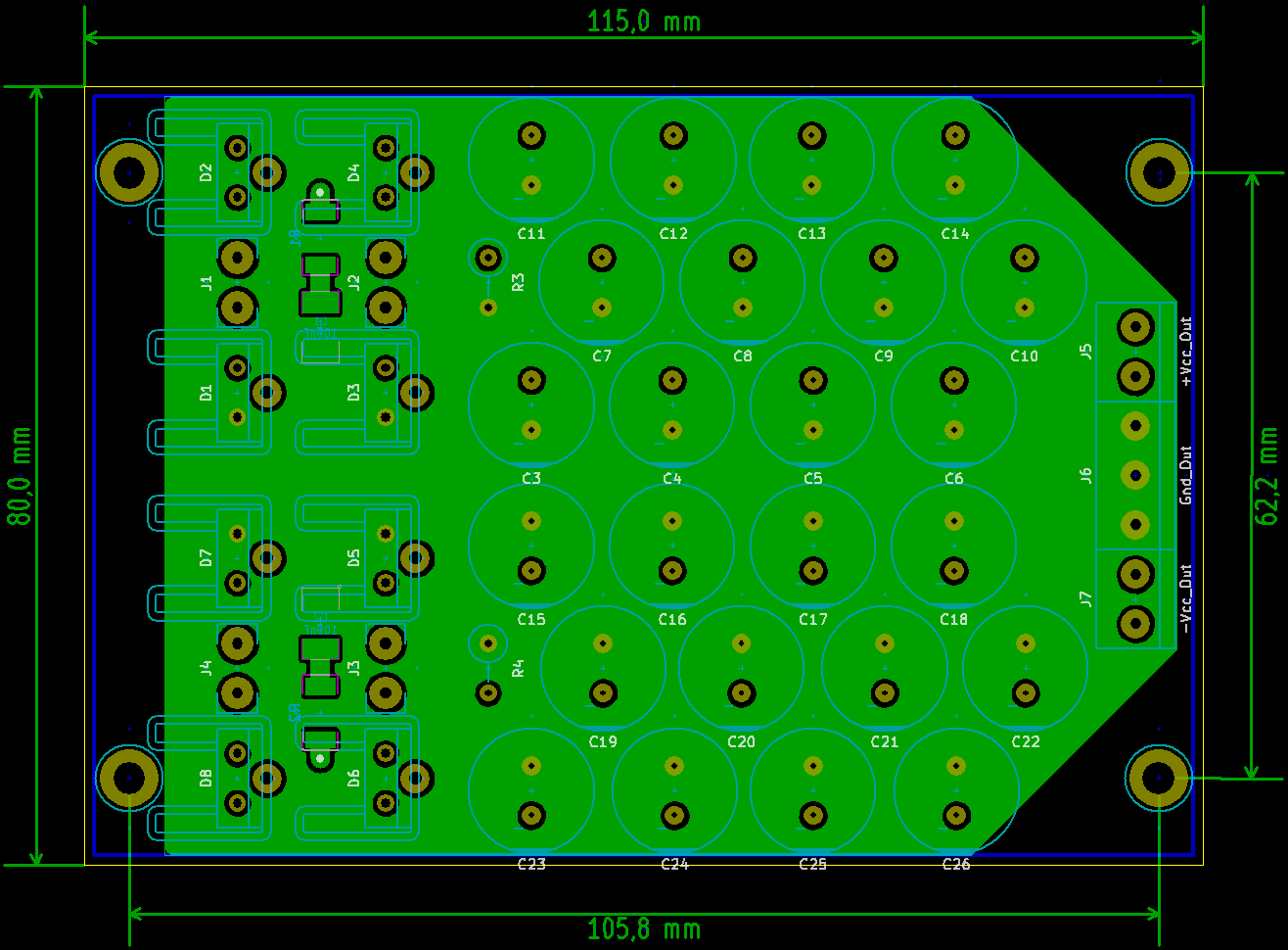

I have just made a new version of the rectifier board.
Both versions are equipped with dual rectifiers with 16K/W heatsinks per diode, bleeding resistors and space for diode snubber RC.
They have 2 outputs per rail (for stereo usage), and a third GND terminal for safety ground connection (via safety loop breaker).
My original version used a single 10,000µF capacitor per rail and provided space for a small film bypass cap.
(power planes have not been drawn, layout just for size estimation)
The new version uses 12x 820µF per rail and power planes on both sides.
Please ignore the thin lines around traces and pads, they are just clearance marks in KiCad.

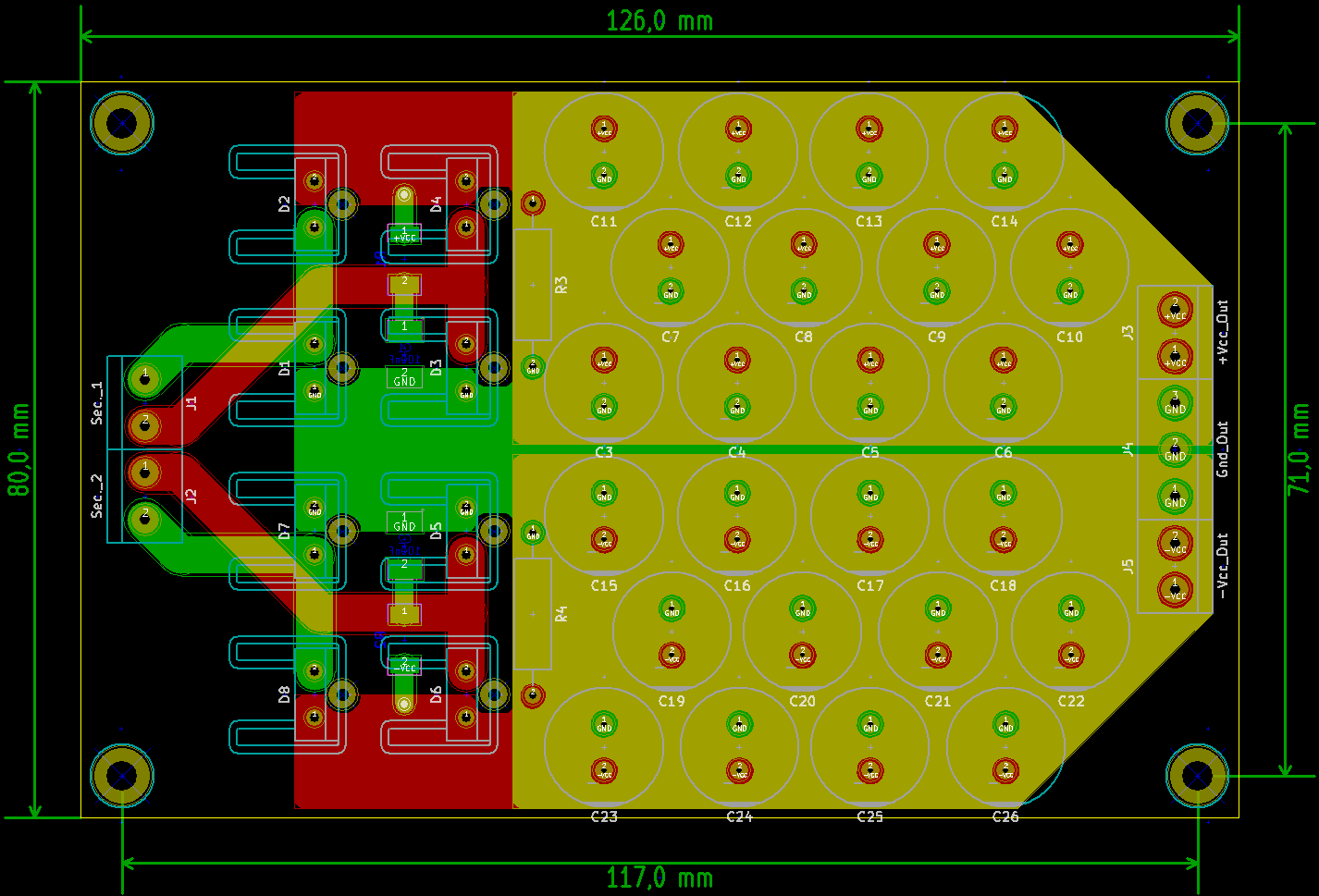

I've made for you a PS only version of my board to illustrate some concepts:
attachment.php
  • keep diodes traces as simple as possible, try to avoid overlaps
  • after smoothing caps try to keep V+ and V- traces paired on the ground plane, it will have an effect similar to twisting cables
  • power traces on the groundplane have constant impedance if they mantain their width constant
  • power traces on a groundplane will have a greatly reduced inductance (circa 40% less)
  • When using groundplanes take in account current returns, HF current will follow power traces, LF will seek the least impedance path.
  • Avoid slots in groundplanes, particularly on the current return path
  • Sometime, though, slots are useful to isolate sections of the groundplane (see the small slots on the smoothing caps to sepate diode's plane from the general one)
  • when routing traces avoid 90° angles, they will cause impedance changes and reflections that can possibly smear the signal.
two additional notes:
  • it's unlikely that those diodes will ever need an heatsink...
  • do not remove the bypass caps on V+ and V-, use R2R bypassing if you want.
Yes, I agree. Do not remove the small bypass caps. Could allow high-frequency instability.
Thanks!

Regarding the diode traces: Thanks for the hint, I've overlooked that! I could reduce it to exactly one crossing at 90°, if I swap the pins at the input terminals.

I've just completed the changes to the power supply layout.
Transformer inputs are now Faston tabs between the diodes, just like ClaveFremen proposed.
And the power planes have been closed, too.
As a nice side effect, the width decreased also by 11mm.
Red is top layer, green is bottom layer.
I can hardly wait to hear about the results...
