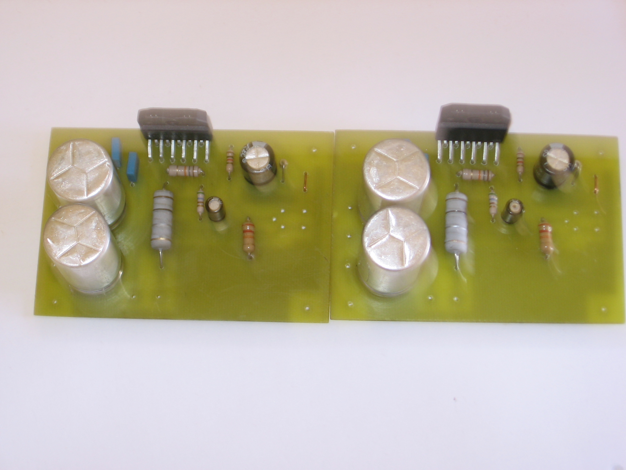

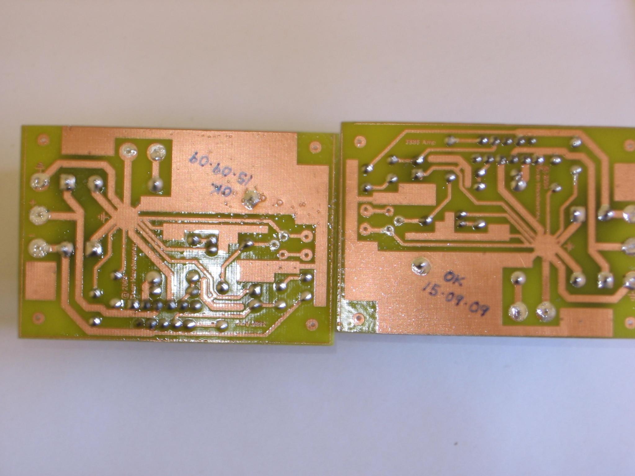

Generalguitargadget board.
Two boards both with basic components for proof of concept, made them with the toner transfer off photo paper method. I have since changed the components to 'better' ones still using the same pcbs and I'm happy with the sound. I am using 4ohm speakers as well.
