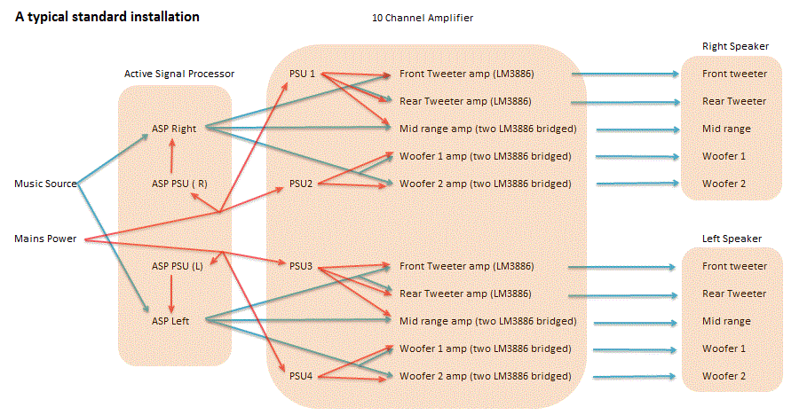

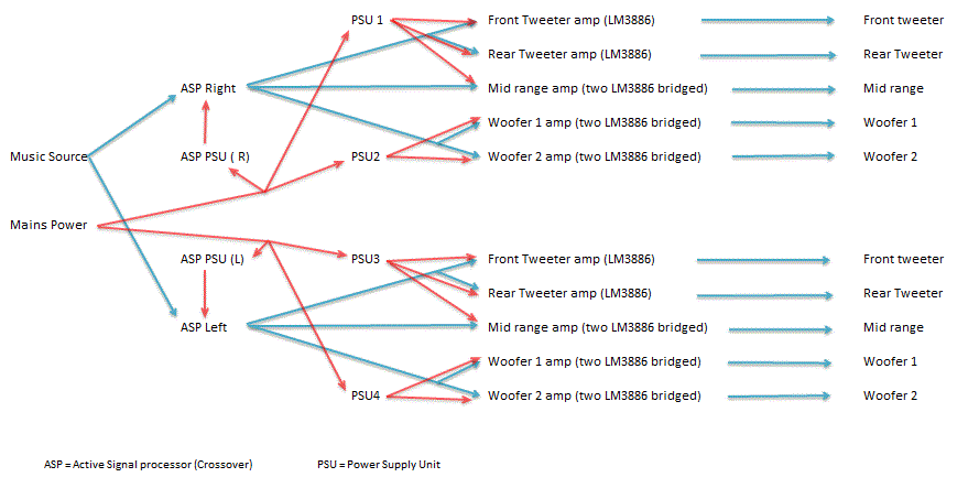

The general overall wiring scheme is as below:
Blue lines are signal and red lines are power

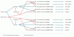

A typical standard Orion installation goes like this (there is only one PSU for both sides of ASP)

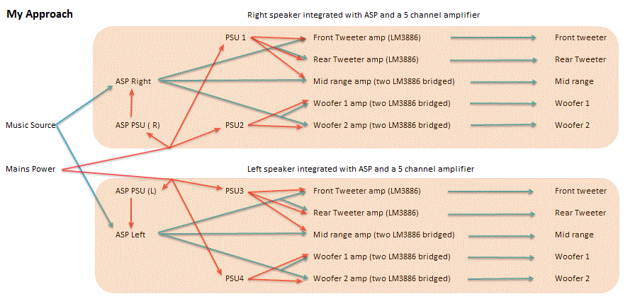

What I am thinking is to redraw physical boundry of cases like below

No, that's not the issue. The issue is the RF loops formed by the long source cables and the mains wiring. You'll definitely need to run balanced interconnect from source to amps to have a hope of reasonable sound, otherwise the loops will be through the 0V pcb tracks of your amps. With balanced the ground can be connected to chassis and thereby to earth. Currents will still flow in those loops but we'd hope that won't infect audio circuitry.
<edit> Had a quck look at your graphics - the weakness of them is that current flows in loops and all your connections are shown as straight lines. Grounding also is an important issue to consider at the design stage if you're aiming for the best sound.
Can you explain please explain "current flows in loops and all your connections are shown as straight lines", obviously each line represents two wires (positive and neutral).

Your modifications to the Orion's cabinet need some consideration. The PSU case will influence the rear reflections of the midrange speaker. Lifting the Orion on top of an amp case will have the effect that the tweeters aim above your ears instead of aiming right at them when you sit on a sofa. It would also be better to have the transformers at the bottom, so that the weight stabilises the speaker. On the other hand, the heatsinks for three BTL and two SE channels may add up to some considerable weight also.
No, that's not at all obvious. If so then which of the pairs are the grounds? You need to send bipolar signals to the drivers so need +,- and ground wires (that's three wires) to the amps but you show only one pair (positive and neutral) to each.

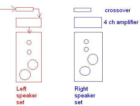

Buddy, making a multi-channel amplifier is not an easy task. On paper you can plan so easily as i saw the 2 colored block diagrams. But as you try to arrange the actual things like power supply rectifier , caps, amplifier PCBs, inlet and outlet cables, it become a difficult thing to manage.
Check out my 5.1 system based on LM4780 and see the complexity, i tried to keep it simpler on paper but as the hardware settled down, it gave me a big headache to complete the system. -
5.1 LM4780 based amplifier.
so in ur case my suggestion will be make individual crossover circuit enclosure separately for each L & R speaker set.
and another enclosure for only power amplifiers, again seperatly for L & R.
it may be a little costly but will give you easy milestones to complete and easy to make.

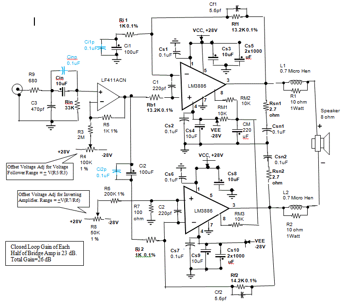

100 Watt Bridge Amplifier for Woofer with Soft Start Mute circuit
It's been some time now. I have been working on the circuit for the bridge layout. I am planning to use following for each side speaker (Actively power Linkwitz orion speakers, more context in first post)
1. Two single LM3886 amps for two tweeters independently (Seas Millennium Tweeter, 5 ohm, frequency = 1440 hz to 20khz)
2. Two LM3886 in bridge mode for one mid range speaker (Seas W22EX001, 8 ohm, frequency = 92 Hz to 1440 hz)
3. Two LM3886 in bridge mode for each woofer (there are 2 woofers per side, so there will be 2 bridge amps made up of 4 LM3886) - (Peerless 10" XLS Woofer, 8 ohm, frequency = 20hz to 92 hz)
Below is the circuit diagram that I have designed for the Bridge Circuit for the mid range. (for woofer the caps marked in blue will be dropped). Each of these bridge amps should be capable of giving 130W clean output at 28V Rail. The total gain of bridge amp is designed to be 26.
Please review this circuit layout and share your views on this...
Following are the notes around this design
1) Cinp, Ci1p & Ci2p are premium Polypropylene Capacitors for reducing distortion at high freq.
2) Lower -3dB roll off with CinRin (Being HPF)=0.482Hz
3) Lower -3dB Roll off at input of Non Inv Amp with Ci1&Ri1=1.59Hz
4) Lower -3dB Roll off at input of Inv Amp with Ci2&Ri2=1.59Hz
5) Cf1 & Cf2 are for preventing high frequency instability at low gain, giving high frequency -3dB gain roll off at 991Khz. (Beyond 991 Khz gain reduces @ 12dB/Octave).
6) L1//R1 and L2//R2 provide high impedance to high freq, so isolates Amplifier at high freq from Capacitive Load due to speaker & connecting cable so prevent oscillation due to the capacitive load. 3dB pt is at 2.27Mhz beyond which impedance of L1 & L2 become high.
7) Rsn1&Csn1, and Rsn2&Csn2 Filter High Freq Noise with -3dB roll off at 589 Khz.
8) R9&C3 is LPF with -3dB cut off at 498 Khz. It filters High Freq Noise at Input
9) Since Rf1=Rb1 for Non Inv Amp, DC Offset Voltage is under control.
10) LF411ACN forms Buffer (Voltage Follower) isolates low input impedance of Bridge Amp from loading the low source impedance
11) C1 and C2 filters high frequency noise at Inputs of each power IC
Note: Value of Cin, Ci1 & Ci2 given is for woofer bridge amp and for midrange amp it would be one tenth of the value
again an upfront warning, be very careful when placing resistors on the PCB. One IC is in non-inv config, other is in inverting config, so the resistor set have different values for inv & non-inv.
What I'll suggest you is to make both the ICs in same configurations and add a unit gain phase changer ic just after the buffer. This will help in easy up your bill of material and independently check both the power ICs for sound.
Hi Kuldeep,
I considered that idea, however as per National Note - Overture Series High Power Solutions, using output of one amp as the input to second inverting amplifier inherently possess higher TD and noise that will degrade the sound quality. Therefore I did not pursue that path.
Cf1 and Cf2 should be bigger to fit to C1 and C2. The LM3886 has a typical GBWP of 8 MHz, which leads to a GBW of ~563 kHz for your gain of 14,2 times. A roll-off at 991 kHz has no effect. Try 47 pF and provide space for a series resistor for that cap.
2 x power = 3 dB, 2 x voltage = 6 dB, because double the voltage will lead to double the current for a given impedance, so the total voltage gain of your bridge will be 29 dB.
Single op amps, like the LF411, usually have compensation pins, which provide an easier and more reliable way to adjust the offset, than your R3/R4 configuration. Check the datasheet for details.
For offset adjusting of the complete bridge amp, skip R6 and R8 and replace R7 with a 20k trimmer. Adjust the offset, then replace the trimmer with a fixed resistor of the corresponding value.
You could also try the Simplest Ever Bridging Adapter for Amplifiers to use two non-inverting chip amps without inverter and/or buffer op amps to make your life easier.
Cf1 and Cf2 (are in feedback path and affect gain characteristic) they have no correlation with C1 and C2 (for suppression of high frequency noise at input). If we provide a resistance in series with Cf1 & Cf2 capacitors the overall gain gets reduced further at higher frequency, and gain response is also not flat, which is not desirable. I will consider increasing Cf1 and Cf2 to around 12 to 15 pF keeping in mind that it does not short the input terminals to output terminals through C1 and C2.
What you are saying about power is in single mode not in bridge mode. In bridge mode the virtual load which one IC will see is half the value of load resistance. Hence each IC will give 23db power (14 gain), therefore 2 ICs will give 26 db gain (total gain of 28).
Thanks, checked the data sheet, pin 1 and 5 can be used for offset balance, which I will use. However the maximum supply that chip can take is only +/-22V whereas my voltage rail is +/-28V.
Can you explain how to adjust +/- voltage at the input pin of OP Amp for offset management?
Also high resistance (20k) will increase the input noise, which at present is not there, as only 100ohm resistance is being used. I have taken this circuit from National AN31
I considered that idea, however as per National Note - Overture Series High Power Solutions, using output of one amp as the input to second inverting amplifier inherently possess higher THD and noise that will degrade the sound quality. Therefore I did not pursue that path.
I propose that you check the circuit in Spice to see the effect. C1 and Cf1 form a frequency-dependent voltage divider and changing either will affect the entire response. Their values need to fit to each other.
That’s the idea of op amp compensation, to shape the gain in a way to avoid oscillation. If you don’t need the resistor, don’t put it in, but you should at least provide the space for it, just in case.
14 x voltage gain is 23 dB, 28 x voltage gain is 29 dB, see dB calculator.
Double the voltage through a given load gives double the current. 2 x U x 2 x I = 4 x P. Four times power is also a difference of 6 dB.
Yes, you will need a separate power supply for the op amp.
The op amp’s bias current through the resistor produces a voltage drop across it. The right resistor value will lead to the same offset on both amp inputs, which leads to 0 output offset.
Will the increased input noise become audible at all? If not, take advantage of the situation and reduce the offset as far as possible.
There is no inverting amplifier in Elliott’s bridge adapter. There are only two equal non-inverting amps and two additional resistors. With that method you can skip the LF411 input buffer, which should improve THD and sound quality according to National’s theory, and you save the additional power supply for the op amp.
