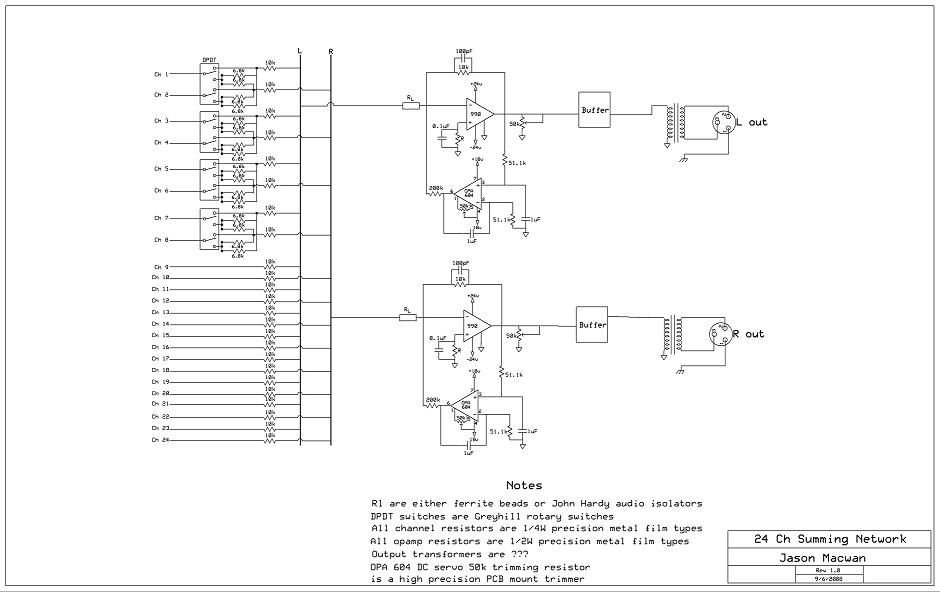

I need a voltage buffer to match impedances in a summing buss that I am building. Can the LM3875 be configured to work as a voltage buffer with a gain of -1? My power supply is a bipolar 24V. I would be very grateful for a circuit. I'm unsure about what Rf/Ri ratio would be optimal for this.
I need to buffer a 50k or 100k pot. The pot atteunates the output of a John Hardy 990 discrete opamp configured a a summing amplifier. The output of the 990 feeds the pot which in turn feeds a cinemag output transformer. I can't really use a regular buffer chip because the 990 has a 28dBu headroom which means the 990 could easily output 19V signals. Therefore I need a buffer that can handle input voltages of about 19V (or 28dBu of headroom). The output transformer is a Cinemag CMOB 1 with a 680 ohm input impedance and a 1:1 turns ratio.
