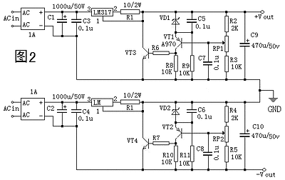

LM317 + 2 Transistors "Class A" Regulator?

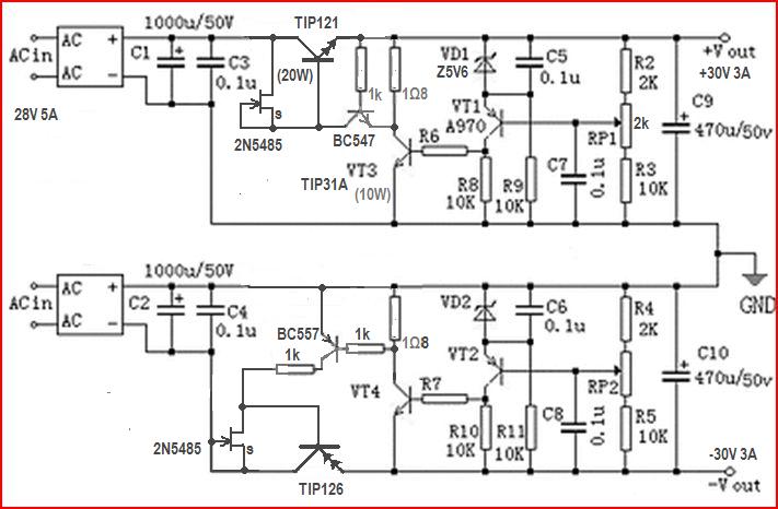

Could anyone shed light on this topology? I cannot find any examples close to it in the sheets.
VT3 and VT4 are high current transistors, yet collector and emitter are connected across POS and NEG.

I was pondering a regulated PS for a 100W Class AB, and came across this on eBay cheap. LM317 will not cut the mustard, but the bare board is worth the price.
I have also been informed "nobody" regulates the DC output power.
Any comment appreciated.
Thanks.
VT3 and VT4 collector & emitter are also connected across the LM317 Adj pin and Gnd. So their purpose is to act as variable resistors. I see the "coarse" voltage set controlled by the value of zener diodes VD1 and VD2, and the "fine" voltage set controlled by potentiometers RP1 and RP2.

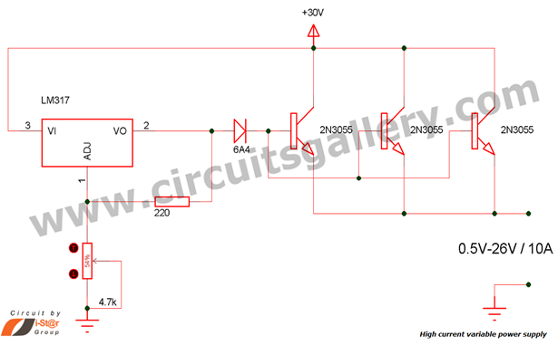

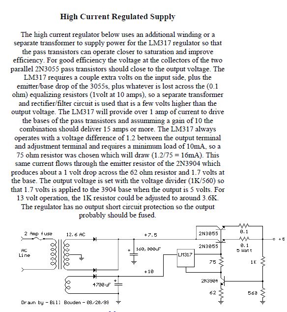

I was looking at a LM317 implementations using multiple pass transistors to reduce switching resistance and thus wasted heat. With this strategy, I may use cheap, ubiquitous 3-term regulator board(s), and just have to make a simple, separate pass transistor board with the load sharing resistors.

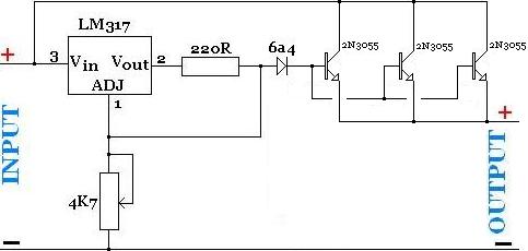

Time and Time again recently I have warned that these configurations of LM317 and series pass transistors Do Not work very good and have very bad load regulation.
It has also been known to cause destruction of the output devices by over voltage on the base of the transistors when a large is current is drawn from the circuit.
I have tested this and the biggest flaw is that there is no negative feedback for the LM317 to compensate for changing conditions of the output load.

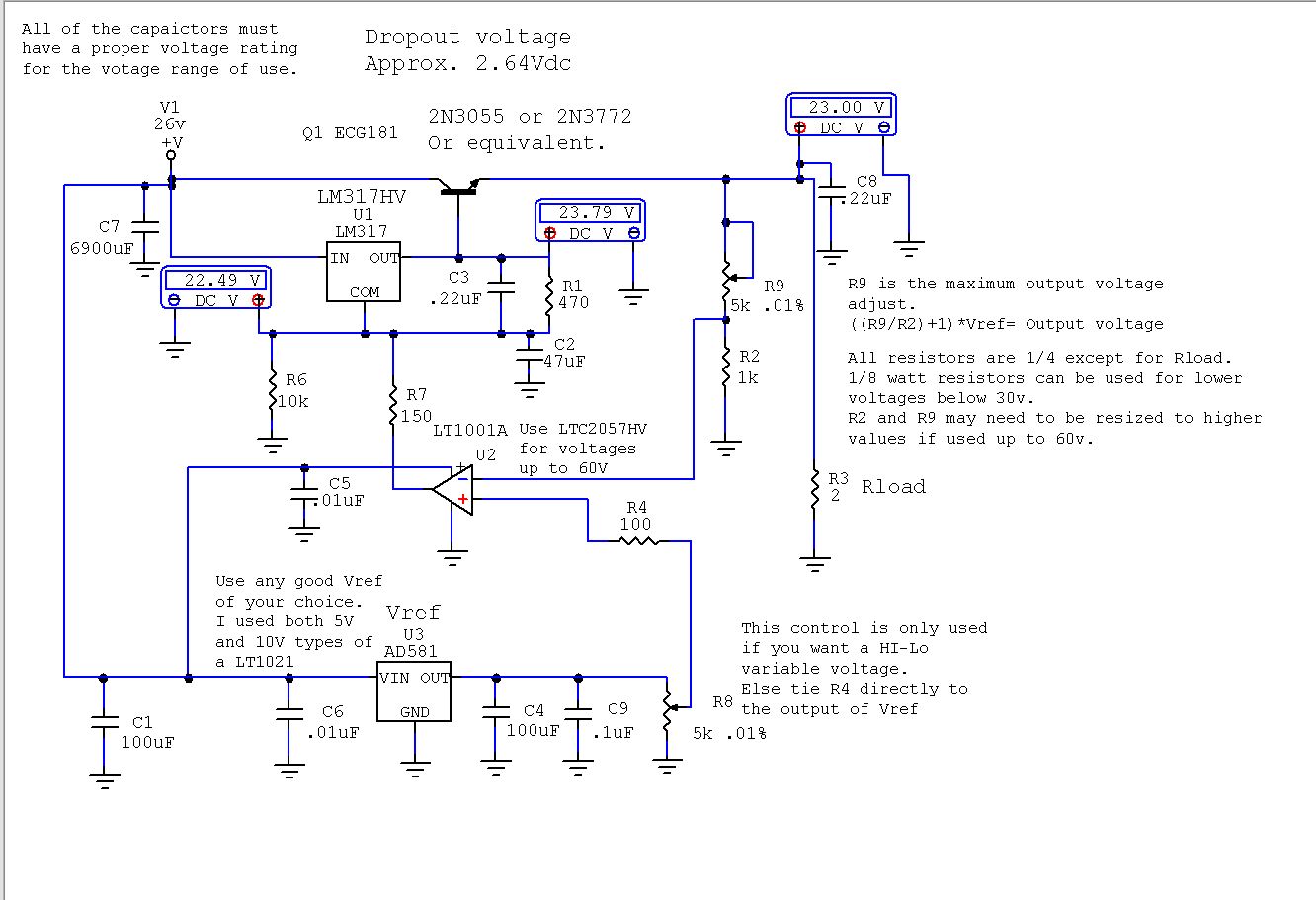

Interesting I did try a resistor connected much like the 1k and it improved things a little bit.
But I wasn't satisfied with the performance yet but I didn't have a transistor stage either.
It was basically connect to the point at the bottom of the 75 ohm resistor in that schematic but without the transistor.
So I broke down and added an opamp (like the function of the transistor) and it is super stable and rock solid!!
The voltage does not fluctuate when I draw an intermittent load of 3.5amp to 0 amps (on,off,on,off,on,off.......) from the circuit at all.
The only other thing about my circuit and probably that one too, is that it will not go completely to 0volts if it were adjustable.
This is typical of these regulators, and to do so I need a negative voltage on my opamp to bring the LM317 ground reference to a -V below ground.
I only had one winding to work with and it is not center taped and using a doubler produced to much voltage for the opamp I used so I am going to get a TC7660 charge pump to produce the -2 to -5v needed for my circuit and then I will be able to have a true 0v adjustment setting.
For reference here is my Final circuit,
http://www.diyaudio.com/forums/chip-amps/261125-lm3886-problem.html#post4064510
On quiet days have measured the noise from the circuit to be as low as 30uv to 100uv Peak to Peak even when drawing 3.5 amps form it!!

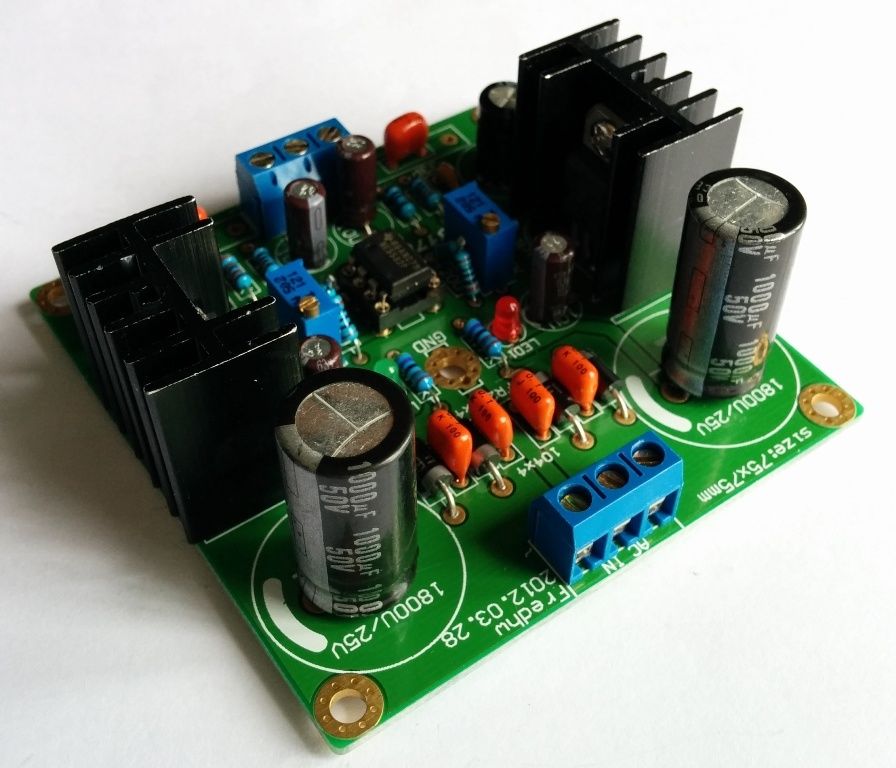

Here is a board to start with:
eBay link: LM317 LM337 Dual Rail Servo Regulator Power Supply DC Adjustable 5V 35V | eBay
The VREF and pass transistor would have to be on a separate board; simple at least. Perhaps VREF could be squeezed in on the servo board with some drilling and jumpers.

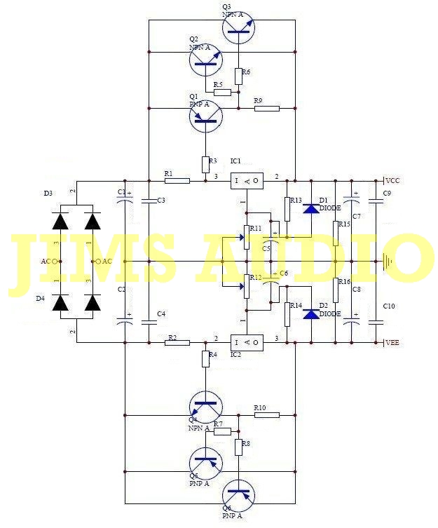

Here is "Jims" High Current Regulator, which comes as a kit with 30V max out, but I suppose it could be modified for 50V. No opamp or VREF, though.

Why can't MOSFETS be utilized with the "0" gate current and low RDSon?
How poor is the regulation in "Jims" implementation?
It had to do with the value of the resistors around the transistors.
As you drew more current the voltage drop across them increased as well.
At rather high currents these resistors needed to have a rather large power dissipation.
And if the values were to high it would limit the current and drop the voltage at the same time.
The lower the values then the transistors wouldn't turn on allow for proper regulation of the voltage as well when it was set to a certain level.
How ever it did work better than the other version that is susceptible to blowing output devices.
