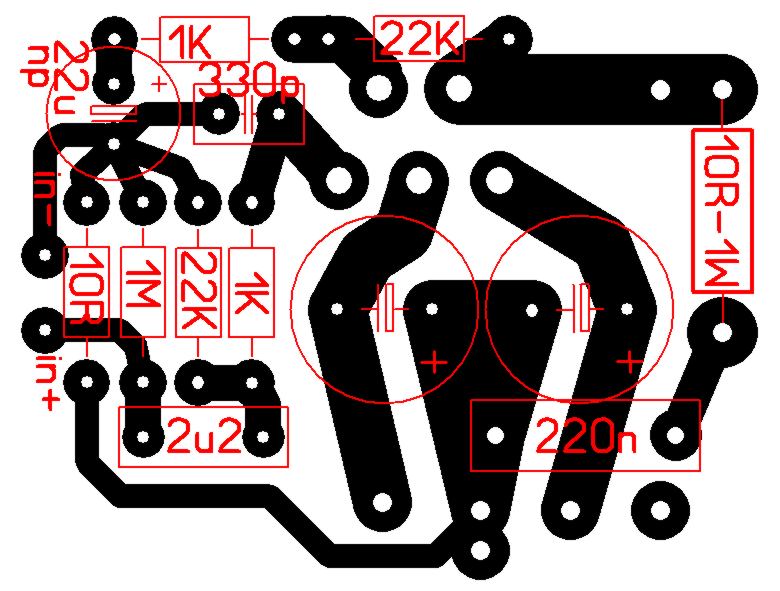

Paswa said:
daniel, please explain it a litle or draw or edit my attached pcb image to show me the solution.. I can't figure it out:rolleyes: :)

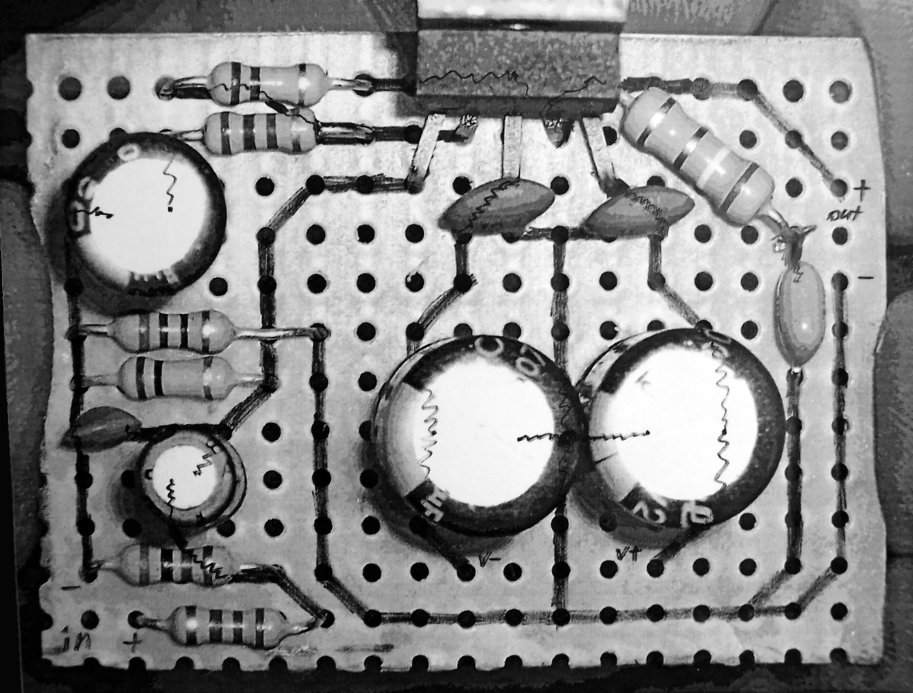

Well, I can't figure it out either, but, here's a guess:
EDIT: This I made so that you can listen to the amp before you order PCBs. The design is comptable with plain vero (phenolic) and experimenters board, which has pads like this: http://www.futurlec.com/Pictures/EXPBRD.jpg so you try different components without getting "tangled" up. ;)

Iván Francisco said:
This is the layout to make a home made pcb, is quit good?
It looks nice.
I see two possible problems.
The load that is driven that drives the chip is 22k. Its not hooked up that way. Maybe an SMD will fit horizontally?
Ah! Here goes.
The input circuit goes:
Source/preamp (pass),
potentiometor or 22k (load),
1k (pass),
1m (load),
1uF (pass),
22k (load)
LM1875 (pass)
You can exchange the positions if the 1uF or 1k if you have a preamplifier.
Next up, a small technicality. The input filter cap, marked square, means poly. That's fine, but 2.2uF might pass more bass than the 22uF cap in the NFB, and you don't want it to do that.
Here's some options.
a) Input, 4.7uF electrolytic--NFB 22uF
b) Input, 1uF poly--NFB 22uF
c) Input, 2.2uF poly--NFB 47uF
Any one of those will have the input filter cap pass less bass than the NFB, which is what you want it to do.
See the attached spreadsheet for reference. Dial in LM1876 because its calculations will be quite similar to LM1875.

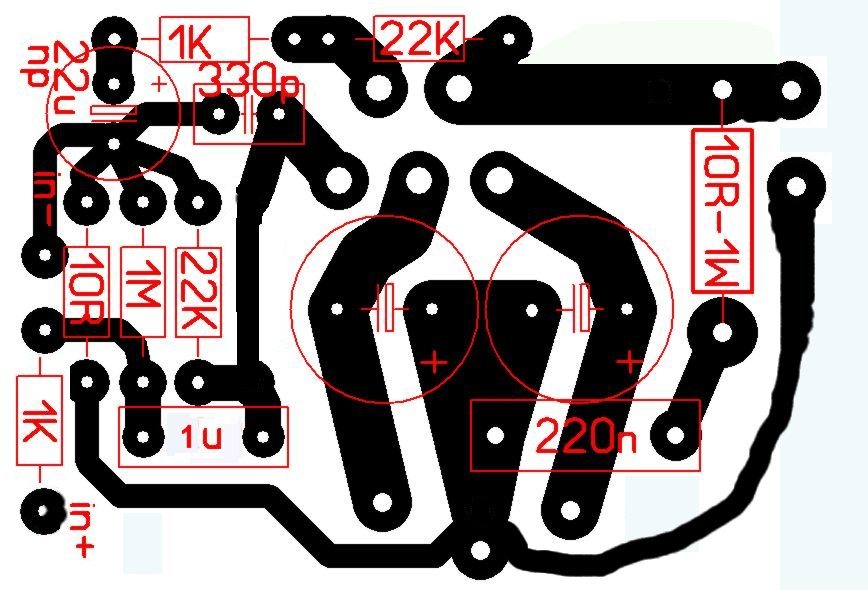

Hi Ivan!
My electronic knowledge is also basic; however, my soldering and stubbornness are in excellent condition. :D
Check out the PDF files at national semiconductor. The lm1875.pdf and lm1876.pdf are quite informative. The spreadsheet works from the variables in lm1876.pdf. It is 2x, LM1875's internally, removes monoblock potential, limits power, and adds spike protector's possible noises; however, the data file is a useful reference because it is more up to date.
I can't answer most of your power supply question because I don't know the amperage or VA for your transformer, and also can't imagine why a triamp system would use a quad amp that almost defeats the purpose, instead of monoblocs which are more suited to the goals of triamp systems.
As far as bridge rectifier units, I only have experience with KBPC, which is quite huge. You might ask Nordic and Ashok about the model code for the mini rectifier.
Here's my guess on your PCB layout. I have made the first component at the chip's input to be a load. The input circuit is now driving a 22k load.
