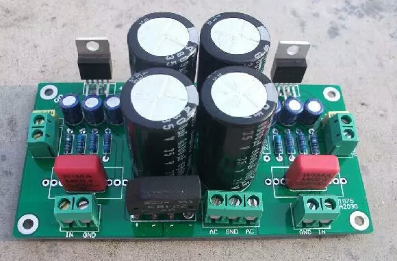

Tda2050 should work on that pcb. There is an option for BTL. I'm not sure if you need that or not. More knowledgeable person can definitely help you.
BTL is for mono right? If I want to run BTL, I should solder a 22k resistor there, rite?
I have extra boards and 4 pieces of TDA2050 with me.
Is this using tda2050?You are probably right. But I don't know if you have to connect those two points with a wire.
Edit: You don't need to short them. I have found a completed pcb.
Ok.thanksYes. Lm1875 and tda2050 are pin compatible.

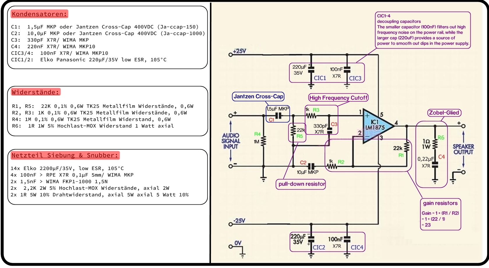

This sch does not differentiate between Signal Return and Speaker Return+Power Ground.You can follow this one:

Also I have attached a schematic from the datasheet.
It omits the RF attenuator at the input and omits the damped Output Inductor.
The ratio C1:C2 is wrong.

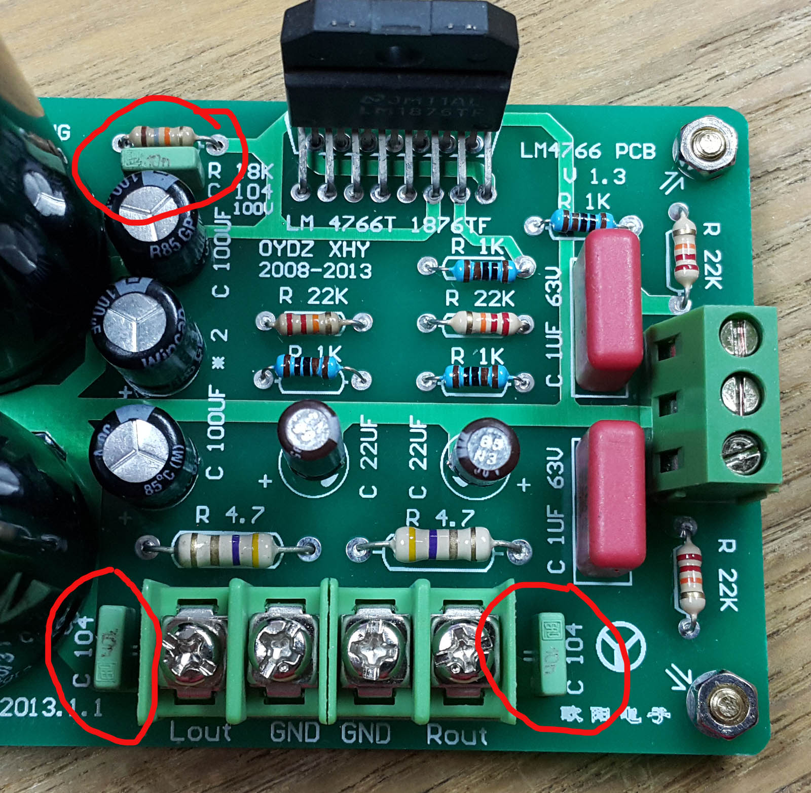

Noob question. Output of the board only has R out, ground, l out as you can see from the picture. Should negative ports of both the speaker be connected with the common ground?
Never mind. Sorted out.
It is C2 that desperately needs to be much bigger in relation to C1.In the past few weeks I've built some of these and they are working great! (C1 may be a bit bigger)
I totally agree.
Feedback pole = 15.9 Hz
Input pole = 4.9 Hz
Perfect combination for distortion. It is the input pole that must always be the dominant pole, preferably by a factor of 10. This way the feedback capacitor has virtually no effect on the performance of the circuit.
C2= 100 uF moves the feedback pole down to 1.59 Hz. In practice this works fine with an input pole of 4.9 Hz, since both poles are low enough to be effectively unobtrusive.
With C2 so large, you want to add anti-latch up (clamp) diodes to C2.
