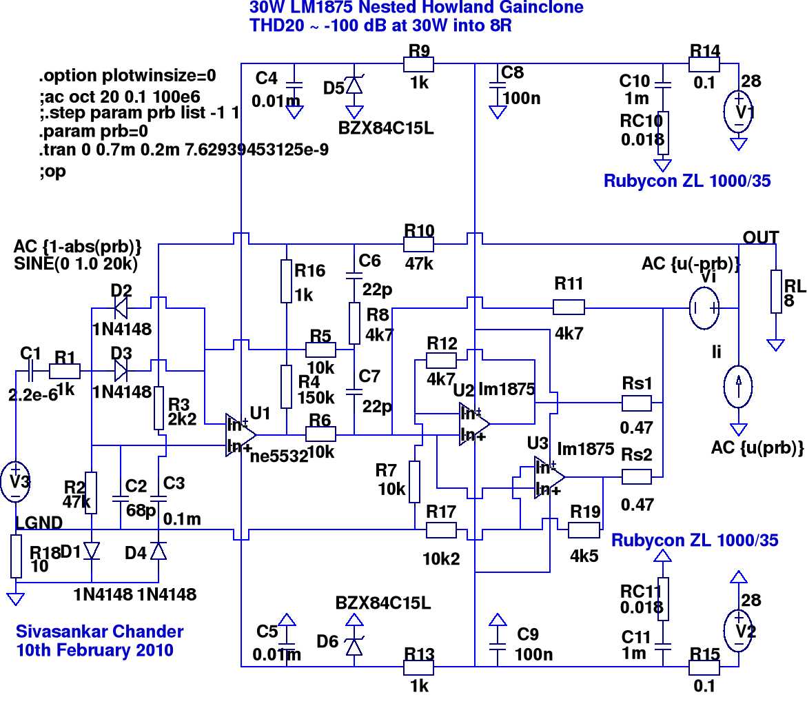

...it's easy to replicate the Howland CP including the negative feedback network and eliminate this issue if necessary. The non-inverting input of both Howlands will then be driven from the (common) Deboo integrator node.
Here's the schematic with that change incorporated. Now both the output chipamps are independent without a master-slave relationship. The arrangement works even with mismatched local feedback networks (as shown), but the current sharing will be unbalanced by a large factor - maybe 100% or more for a resistance mismatch of 5%. This doesn't seem to hurt the sonics much - H3 is higher when the local feedback networks aren't matched, but still about 30 dB below H2 in the circuit shown.
Both the output chipamps must be matched closely, however - their dominant poles must match closely, or else there will be a phase shift between the two, leading to spikes in crossover current through Rs1 and Rs2. One way to ensure this is to pick them from the same batch, or use a device like the LM4780 which (hopefully) has two matched die in the same package. With some changes to rail voltages and closed-loop gain, it should be possible to use the LM4780 as a drop-in replacement for the 2 x LM1875 in the simulation schematic for power output in the range of 80-100W/channel.
@gootee: Thanks for the links - I'll try out the square-wave and slew rate tests in due course.
Meanwhile, I managed to stabilize it further - the tweaked compensation in the schematic shown below allows it to drive a 10 uF || 8 ohm load stably. The output waveform stays sinusoidal up to about 200 mW output, after which the LM1875 goes into current-limiting and the waveform becomes more or less triangular. In any event, it does not show any HF instability, either before or after current limiting sets in.
The tradeoff? Another ~10 dB of THD20 has to be given away, taking it to about -110 dB - it's still worthwhile, IMHO.
Shown below is the modified simulation schematic including the 8R || 10 uF load, the loop gain plot with the 8R || 10 uF load, and the output waveform FFT plot at 200 mW into 8R || 10 uF.

Agreed - the LM4780 or 2 x LM3886 per channel are the ideal candidates for this topology. My guess is that they will just work fine (maybe with minor tweaks to the compensation) in this topology without significant alteration, but it has to be prototyped and auditioned to validate the concept. There doesn't seem to be a reliable SPICE structural model for the LM3886 on the web.
If you could model LM4780 with one channel not used, then you have modeled LM3886.

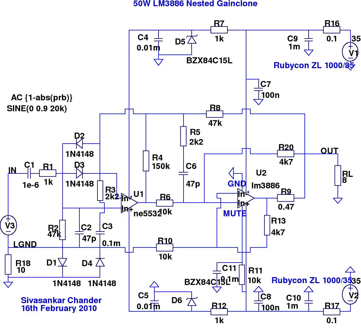

The simplified version is easy enough:
(i) Use a single chipamp at the output. Remove U3, R17, R19 and Rs2.
(ii) Use a first-order compensation network from the Deboo integrator node. Remove R5, short C6 and change C7 to 47pF or 68pF.
(iii) Simplify the Jung-style voltage-series feedback network (R4-R16-R10-R3) to a 3-resistor network by shorting R16.
(iii) Lower the rail voltages to +/- 24V with the LM1875 (the LM3886 can run with +/- 35V).
(iv) Reduce the closed-loop gain for a single LM1875, and increase it for a single LM3886 to get the appropriate output swing. This involves changing R3 alone.
...LM3886 is run in inverting mode. The chip has more of a tendency to round off the squares in inverting mode, whereas non-inverting mode may make U-shaped squares or other sorts of peaks. I think that its probably worth checking this out.
In a Howland Current Pump, it doesn't make much of a difference if the output chipamp is run in inverting or non-inverting mode - the common-mode component at the inputs is identical, and there's no difference in distortion either way. Mauro Penasa chose the inverting mode for both the LM3886 and LM318, and used (non-inverting) voltage-series feedback for the GNFB loop.
I started with a non-inverting topology for the local loops (LM3886 and NE5532) earlier, and retained it even after switching to a Howland Current Pump at the output. I use Jung-style non-inverting voltage-series feedback for GNFB.
OTOH, the compensation schemas differ a lot: I use a modified Deboo integrator, which is similar to current-feedback through the compensation network C7-R5-R8-C6. It's topologically closer to the Mauro Penasa Rev A (which uses an integrator around the LM318), than the Rev C. The sonic character can be evaluated only by prototyping and auditioning it against both the Penasa Rev A & C, but simulation reveals that it is likely to be comparable to a Rev C.

Simplified LM3886 nested gainclone
Ok, here's a simplified schematic with the LM3886. The component values should be regarded as placeholders which are subject to modification after prototyping - it should work stably with the values shown, but may require changes to improve audible sonics.
If a PCB is being attempted, I'd suggest the (previous) complete version with 2 x LM3886 instead, and the 2nd-order compensation schema with the Jung-type GNFB network, etc. Components can be omitted or bridged on the complete version to get the simplified version posted below.
Edit: Some implementation notes - match R6 and R10 to within 0.1% with a DMM; likewise R20 with R13. The actual values are not critical, only the matching. R9 can be implemented as 2 x 1 ohm/2 watts metal-oxide resistor in parallel. Leave enough place to experiment with different input caps for C1 - I'd recommend Siemens MKL or Wima MKP here, but numerous other choices are possible. The electrolytics for the LM3886 can be reduced to 220 or 330 uF per channel as per current gainclone practice, although I tend to use 680 uF or higher. C6 should be polystyrene or silver-mica. C2 should be silver-mica, polystyrene or 1kV ceramic. All the rest can be standard LM3886 gainclone practice.
(Sorry about the legibility of some of the text - I had to export it as .wmf from LTSpice on Wine on Linux, convert the .wmf to .jpg in GIMP, etc.)
I'm probably missing them on the drawing, but which electrolytics are you talking about? The 1000uF Rubycons?
Yup, I used the specs of the 1000 uF/35 V Rubycon ZL in the earlier LM1875 simulation schematics, mainly because they're low ESR, have excellent sonics, and are widely available. It should work ok with the LM3886, although the recommended values for supply bypass caps are lower.
