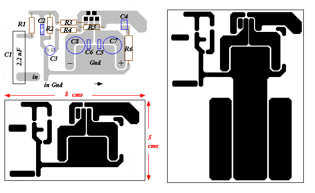

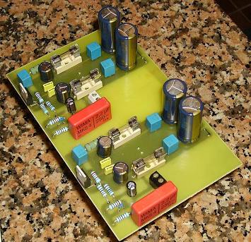

LM1875, my first project
thanks, i will ready your post with time

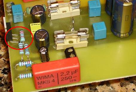

Only two fast considerations, first is difficult to move R5, perhaps one mm more (see photo) and two, the 0,1uF decoupling caps never represent a problem for me, in my first attempts with GC always have problems with the grounds, when i started but my first prototypes don´t use it but is interesting your precission in the distance
In fact my first GC was this,
http://dogbreath.de/Chipamps/GainCardCopy/GainCardCopy.html
i was seduced for his symplicity and don´t use decoupling caps, then i tried to make my on PCB´s with bad results
Today i have finished a new PCB for the LM3886 and it sounds very good, any kind of hum noise, no pops and clicks when started or disconnect, and i think thath is because is a good ground schema, but this perhaps will be a new post
I will ready your post with interest
Best regards and happy new year
