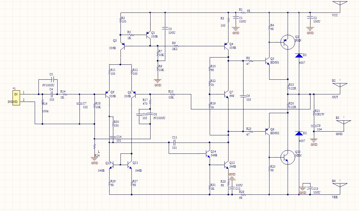

For study purposes, and to express opinion, publishing the scheme available in electronics stores Ebay. Warning do not encourage copying and be respectful of intellectual property of the device.
This schematic is distributed in stores Ebay, as usual, the amplifier must be for sale.

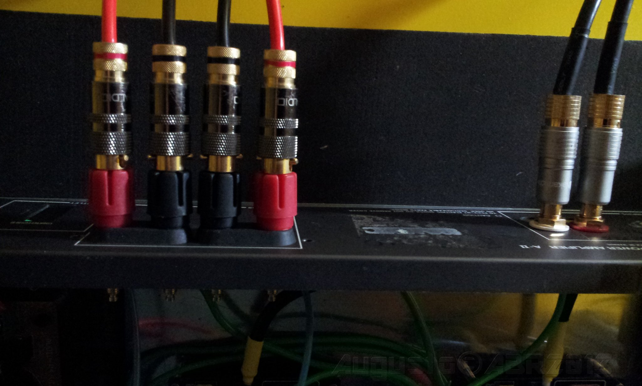

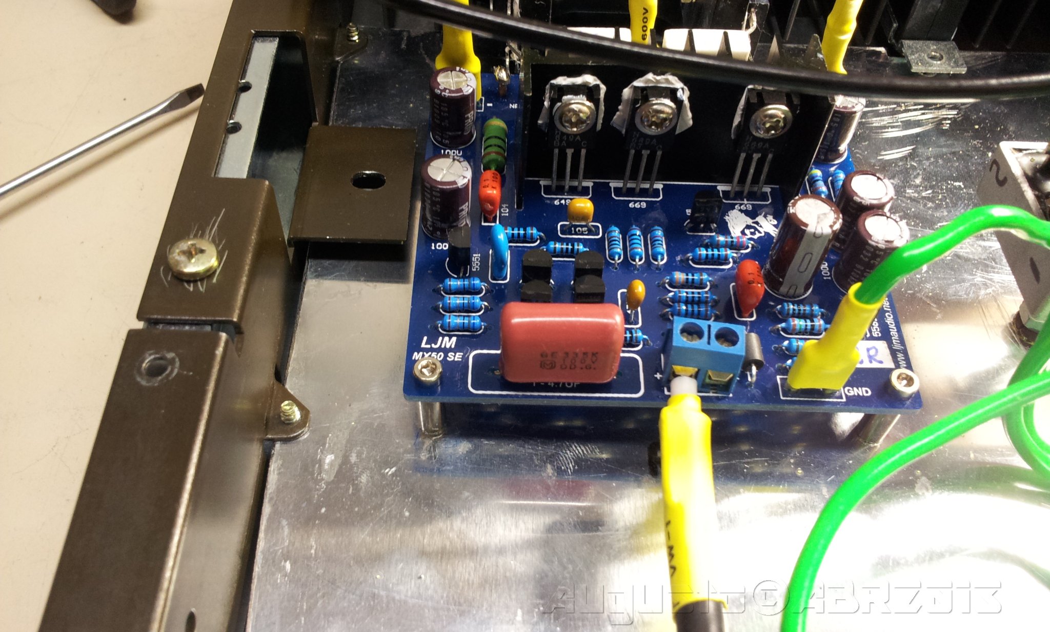

I did the assembly and operating two units MX50-SE with output Sanken A1186 and C2343. The result was surprising, tested on multi amplification, mid and treble bands. The voice is very natural and treble, like breaking glass, percussion dishes are outstanding. I can say that is very close to my F5 running.

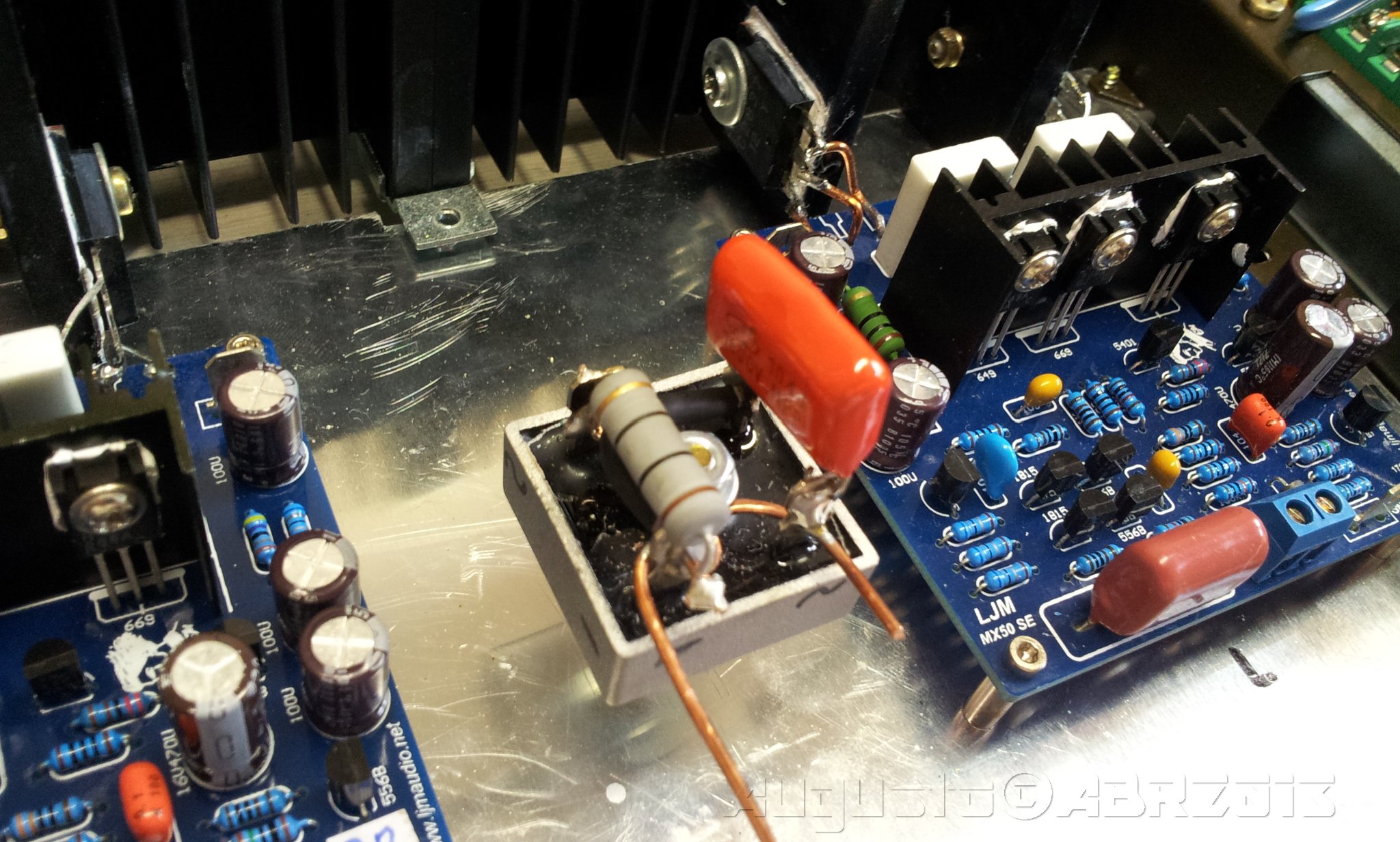

A small mod is change the cap MKP of 3.3 uF the input circuit was replaced by Nichicon BP-S of 2.2 uF. Very good indeed, considering the price of the kit.
Sorry for my bad English.

I use a multi amplified with 6 way. Then mid and treble amplifiers are low power as class A. My MX50-SE run with 36 VDC power which would give an approximate 50 to 60W. Do not heat up, just get warm.
Do not forget that transistors output are important, had read good reviews about Sanken 2SA1186 and 2SC2837 with fT 60 and 70 MHz, are very good and fast. Other little mod, change MKP input for Nichicon BP-S 2,2 uF, also increase quality.
