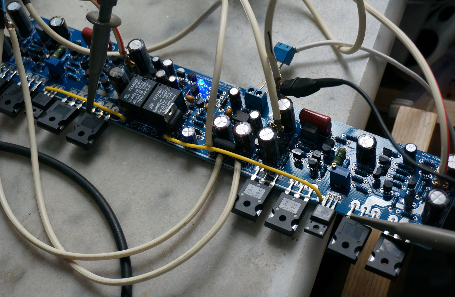

I bought a L15-D Pro kit and soldered it. It was working very well. Dead quiet and sound was extremely well. Then I used it to drive my subwoofer.
Accidentally I interchanged the vcc and vee connections (I think) so it didn't work. Without noticing it I unplugged the power supply and connected another power supply which had two 10,000uf caps which already had charge.
I got a spark when connecting vcc (due to the stored charge in 10000uf caps)
I didn't care about that and connected all other connections and fired the amp.
All the speaker protection transistors caught fire. Later IRS2092 burned with smoke.
Now I'm waiting for the replacement parts to arrive from china (These ICs and Mosfets are not available in my country).
Does anyone know the possible reason why this happened?
How to avoid it in the future?
Thanks in advance

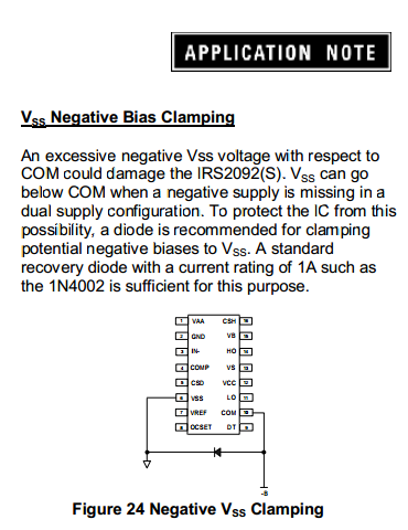

The IRS2092 was probably damaged when you connected the VCC first.
You should install negative bias clamping next time as suggested by AN1138.
Thanks in advance

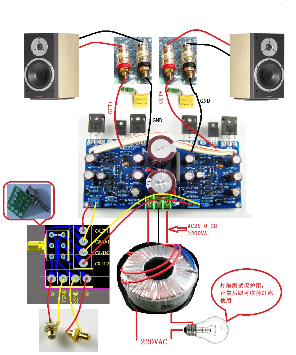

I suggest that in any changes to the connection. After changes or parts. In the test.
In the input string of a light bulb. The above 110 v or 220 v voltage.
It can prevent damage. When our amplifier work, determine the right after installation.
We'll take the light bulb, this is the necessary safety measures.
Hope I won't appear the same problem.

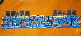

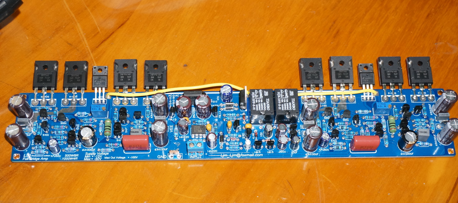

500-1000W 8 OHM L50 Full Bridge Amp
I've been thinking about for high power high performance amplifier. What way is the real meet demand.
It needs to accord with the real output power, rather than write letters we casually.
It needs very good reliability. I tried to use in this field about, L15, L12 field-effect tube, etc.
Customers and friends really need to use them, and feedback to me the information of sound.
I have prepared a long time, to choice all kinds of circuit, as well as the components of collocation.
It must be very simple, must be very reliable. And it must have a good voice.
The performance of the L50 may still not reached me. But this is my take a long time to answer.
This is a photo.
I hope others can understand it.
It is composed of two identical amplifier. Each amplifier using two groups IRFP140 IRFP9140.
Because it requires a simple installation test, it is a tradition in L series has been.
Thus it integrates the speaker protection circuit, the use of two 12 a relay on two groups of amplifier dc output to conduct a comprehensive and reliable protection.
And it integrates the op-amp circuit level before. Former level gain for 5 times.
Former level jointly with the protection circuit using a set of AC12-0-12 v power supply. Using 7812 and 7812 voltage regulator IC.
Since L50 is made up by L15 circuit architecture, so its performance is the same with me.
It works very well. And has a good performance and reliability of any parameters.

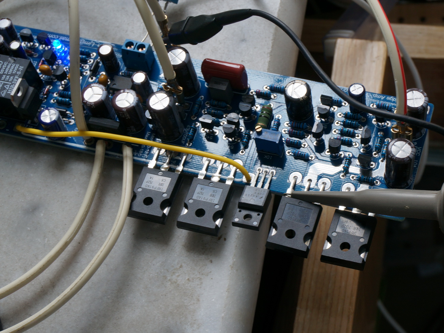

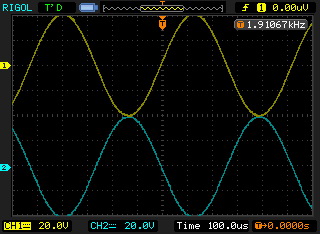

After the installation is complete,
I was tested for it.
Turn on the juice and we measure the voltage of power supply in the first place.
It is + - 54 v dc.
Then I measure separately the two amplifier amplification module, waveform.
Use double trace oscilloscope.
We can see. It works very well. And the two modules are the same.
This is because the two modules I used exactly the same components, as well as the PCB wiring.
Is completely COPY.
Why I didn't use the appearance more beautiful symmetrical component placement.
Because the two modules will produce the error.

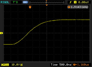

Because of using circuit is L15 L12 are using mature and reliable circuit. So the question is not big.
The waveform is very beautiful.
The SR in balance when can reach 38 v/US

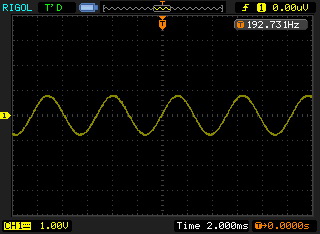

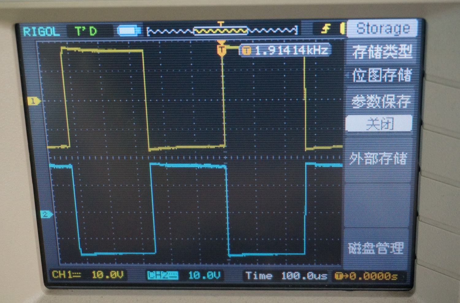

Important test. Measuring the first power supply voltage of the power amplifier. + - 54 v.
And then increase the signal input.
The signal input is: 800 mv

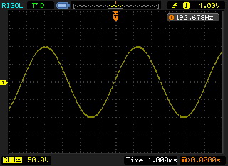

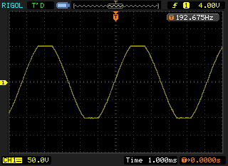

We rotate the signal amplitude, let him work in distortionless condition.
A little bit to reduce signal. At this point about 0.8 V input. The output 100 v
VOLTAGE GAIN =125
About power can be calculated. About 610 w 8 OHM
VOLTAGE GAIN =125

Quote
Unquote.
I messed up a 2092 amp when I connected the rails one at a time with croc clips.
The power supply was still charged up and blew the mosfets and 2092.
Unquote.
Hello nigelwright7557!
Thank you very much for your help. It seems like almost all the zener diodes have become faulty. I think it happened because I interchanged the vcc and vee
I can find IN4148 zener diodes easily so is it possible to replace 5v6 and 15v zener diodes with IN4148s? Also do you have any idea about the other faulty items which caused by the interchange of vcc and vee. I'm going to change both mosfets and irs2092.
Update:
I got the speaker protection part working (atleast the relay works) but the blue led doesn't come on. Connected a speaker and I can barely hear continuous pops from the speaker.
(Replaced a 5v6 zener diode with IN4148 and a 15v zener diode with a IN4148 zener diode)
Update:
Update:
1N4148 is NOT a zener diode
If you reverse VCC and VEE your board is fried , buy a new one !
