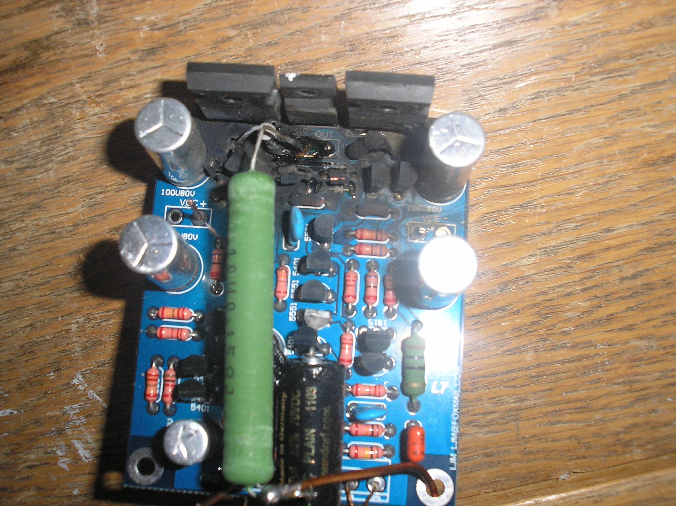

I made a amp with 47 dc supply. The amp burned in one channel and the speaker too. Impedance off speaker not below 5 ohms.
