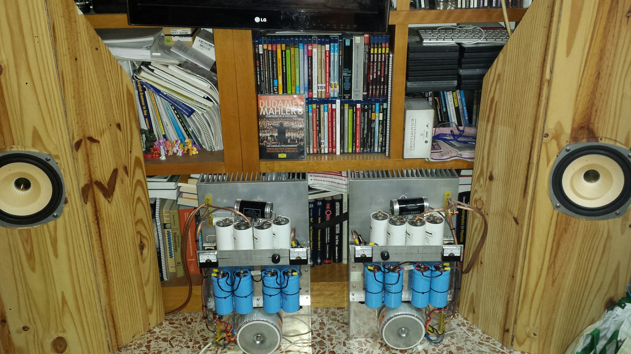

Today I have finished second channel. Both channels adjusted to 4 Amp of quiescent current.... With this current I can see sine wave very well at 10Wrms and clearly distortion at 13 or 14 Wrms (I reached 16Wrms but sine not very well...). Voltage gain is aprox 6.
Regards

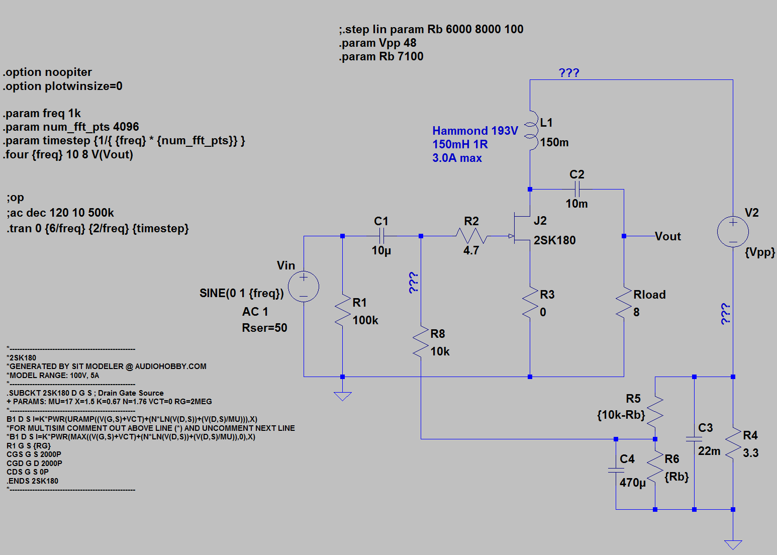

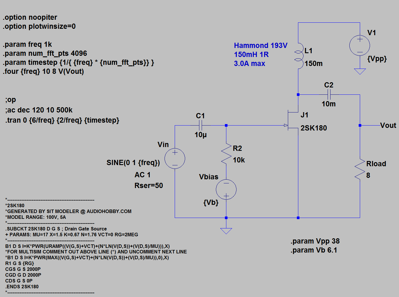

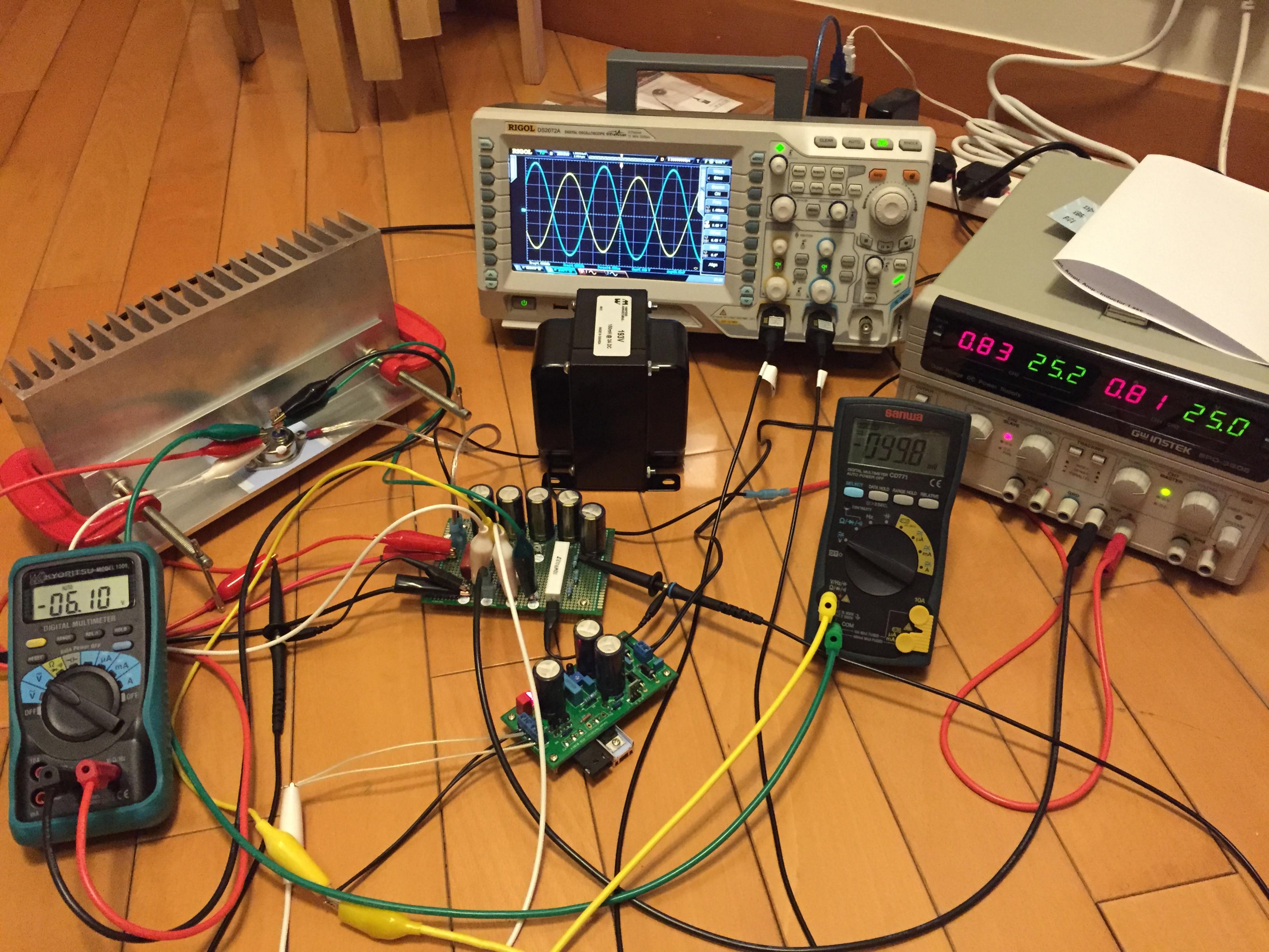

I did a test with the L'Amp circuit today, using the attached schematic (first one) with a 2SK182ES, and a simple regulator board for the bias.
It worked, well, to a certain extent. I noticed that if I increase the rail voltage pass a certain value (around 26-27V in my test), voltage drop across R2 will start to drift up -> less negative bias -> drain current increase -> voltage drop across R2 increase further -> even less negative bias -> ... until the current limiter of the power supply kicks in.
Does anyone encountered similar issue before, and what's the solution? (I guess the self biasing in the second schematic would probably avoid the issue, as increased drain current will increase the negative bias and forming sort of negative feedback, but I'm not very keen on another 30W of power dissipation by the biasing reststors).

Hi Michael,
At 25V B+ supply when circuit is working nicely, voltage drop across 10k is around 0.1V (the DMM in the picture is showing the value). When B+ is increased to 27V, voltage drop increases to around 0.2V and the drift begins (I didn't record Vds, and reading at the power supply indicated Id of around 2A).
After a few minutes, the voltage drop across 10k could reach 1.5V and Id larger than 4A, at that point I shut down the power to avoid damaging the inductor.

150uA is certainly a few times higher than most Tokins I've seen so far but not necessarily a show-stopper. It is temperature dependent and will probably come down some when your device and heatsink reach equilibrium, which is why sufficient heatsinking and good thermal contact between all the parts will be critical.
What you are seeing is the gate leakage rise as the part gets hot. It will move downward at some point as the heat is taken away by the heatsink. Take a look at Lab Hangout #4. You can also try a smaller resistor while you're figuring things out.
Set your B+ around the final value. Start with the bias all the way neg. and slowly adjust it upward over a few minutes while things heat up until you reach your desired current. Then observe it for an hour or so adjusting the bias to keep it on target. This experiment will clearly show you what's happening with the temperature dependence and give you an indication as to whether or not it might ultimately behave itself :)

I've used grid chokes with some (other) parts with more problematic gate leakage and they work nicely.
It's important to note that things "drifting" moderately while the amp "warms up" is all perfectly normal and should stabilize after an hour or two with adequate heatsinking and thermal contact. This sort of thing applies to nearly every simple Class A amp you will build unless, of course, the parts themselves are indeed bad and drift wildly.
When in doubt, suspect your heatsinking and thermal connections first, then your transistors.

I think the heat sinking in my test was pretty bad. The thermal pad was a very cheap one (5 USD for a roll of 50 feet) with mediocre thermal conductivity, there wasn't any thermal grease, neither at the pad nor between the L shape and the main heatsink, which was probably too small for the task anyway :p

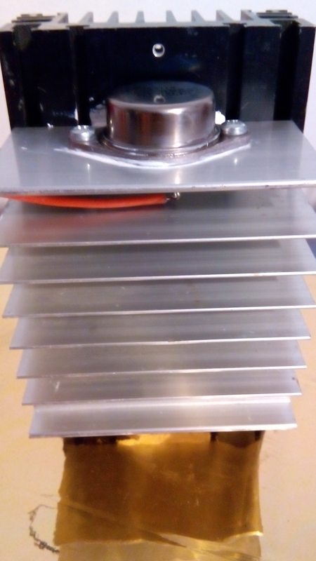

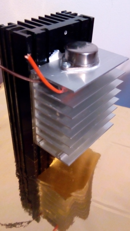

Ready to insert in the l'Amp amp the Tokin 2SK180 , here it is what it looks like .
I use 2 light bulbs in parallel each 500W 230V around 22 ohm or so , or probably a total of 3 light bulbs for 1150 W .
Edit : rail voltage = + 44 Volt , no degeneration resistor , 10k to the negative voltage . This particular piece sets rather well at vgs = -2,7 V .

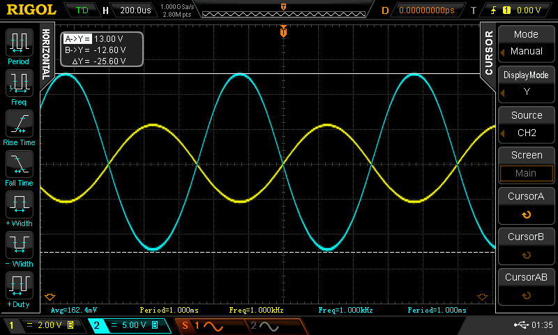

I ordered some mica and silicon compound from eBay, but is not patient enough to wait, so I put some CPU thermal grease on the 182ES and put it directly on the L-profile (without any insulator pad), tried again ... and the circuit behaved well now :D.
Some measurements:
B+ : 38V
Vds : 35.6V
Bias : -7.45V
Leakage current : 8-10 uA
Transistor case temperature : 56 deg C (measured by a LM35 IC sensor)
Heatsink temperature : 53 deg C
Ambient temperature : 24 deg C (air conditioned)
Attached is the output waveform at 10W (yellow is input, blue is output), while I think there is some distortion visible, this waveform still looks quite nice to me :).
Next step is to reinstall my notebook, run QA400 (distortion analyzer) on it and search for the sweet spot, but I will need to find a bigger heatsink to run Id higher.

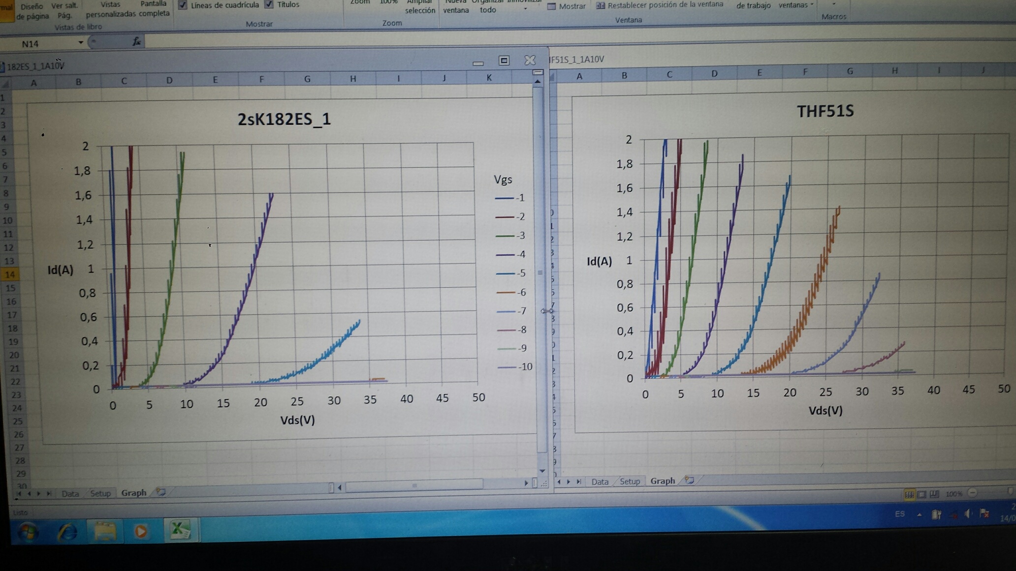

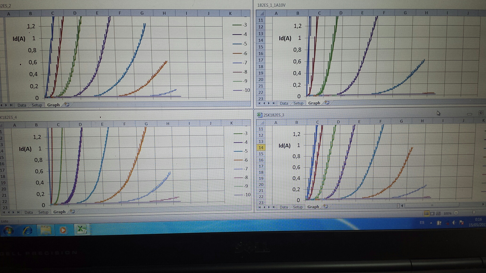

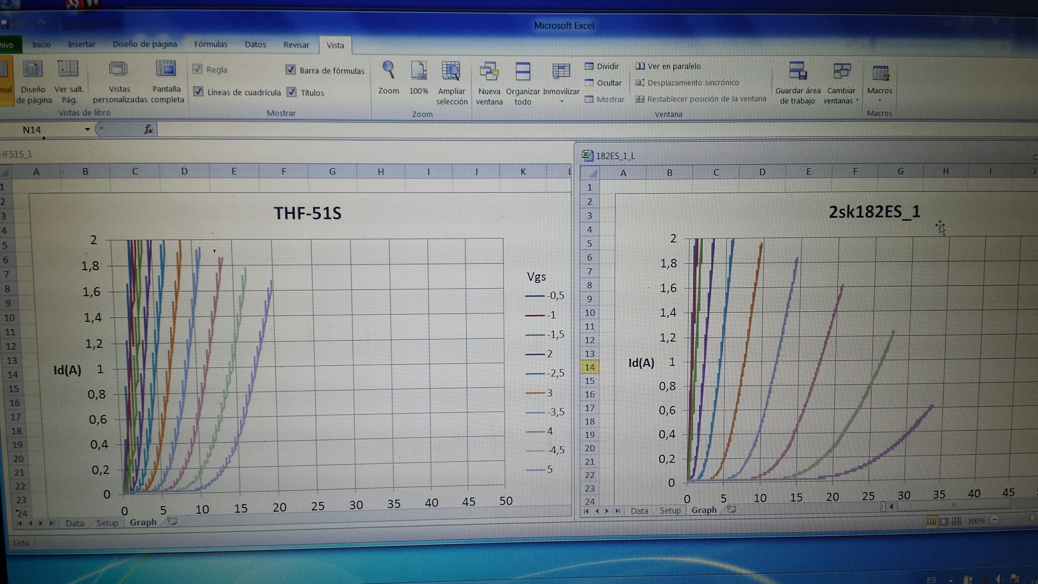

Today I have done a little comparative between THF51S and 2SK182ES. What do you think?. First photo with polarization between -0.5V and -5V, step of 0.5V both devices and the second one between -1 and -10 with step 1V
