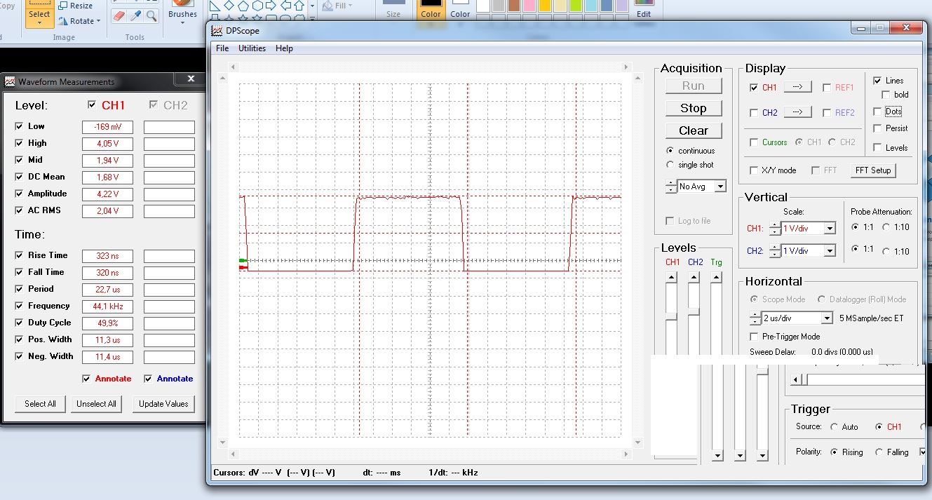

I noticed they have a Nos version and a resampled to 176.4 kHz version.
I can just resample with SoX via computer software, I don't quite follow what is the difference in using SoX or using an SRC chip in the DAC?
