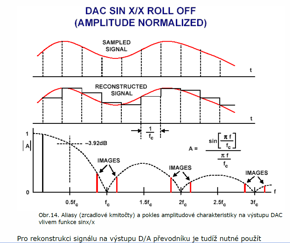

So, it has no anti-aliasing output filter?
Yes, but early Philips chips had step-like waveform. You need output anti-aliasing otherwise you get sinx/x envelope.
Is it this TDA1540? 14-bit converter?
Philips TDA1540 14-bit d/a converter
Perhaps a terminology issue (like calling a suction cleaner a hoover no matter what it is). I would have said anti aliasing without giving thought to it... if you said reconstruction filter I wouldn't question it. It needs the low pass active filter to remove the final traces of the reconstruction (there we go... reconstruction) process.
Whatever, it is the same for both test chains.
