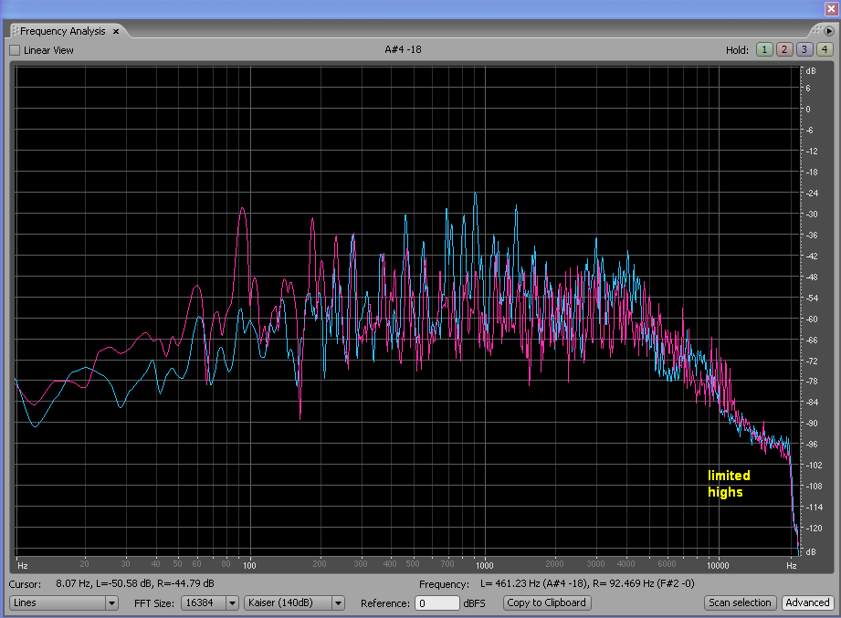

There is just one area where vinyl rip is technically better than the true CD version (not the 320kbps used), and it is highs. I can demonstrate it later.

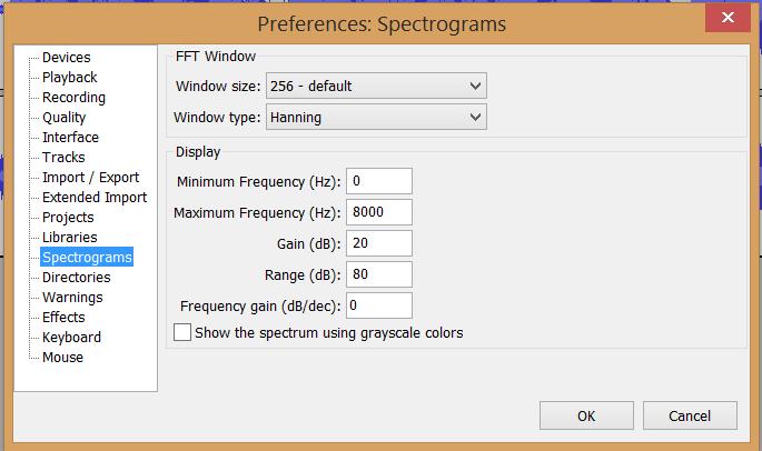

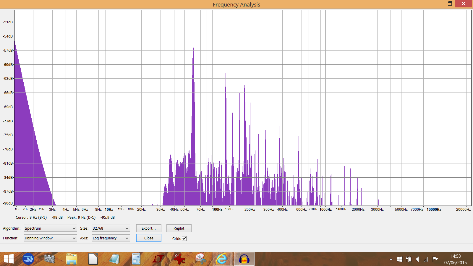

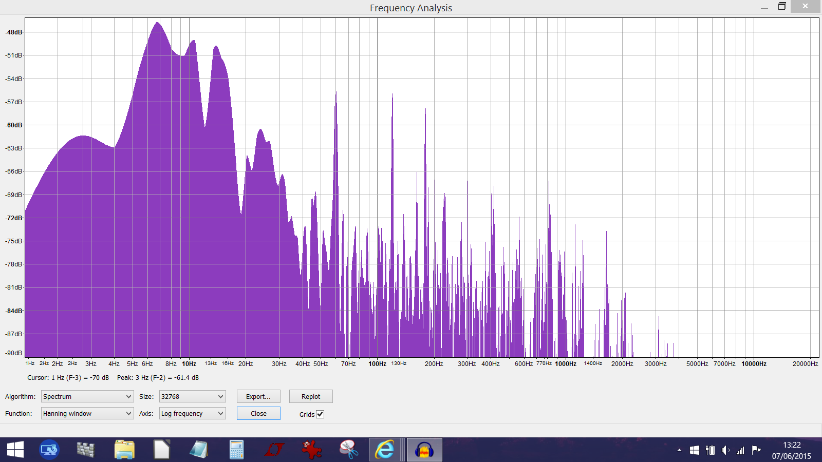

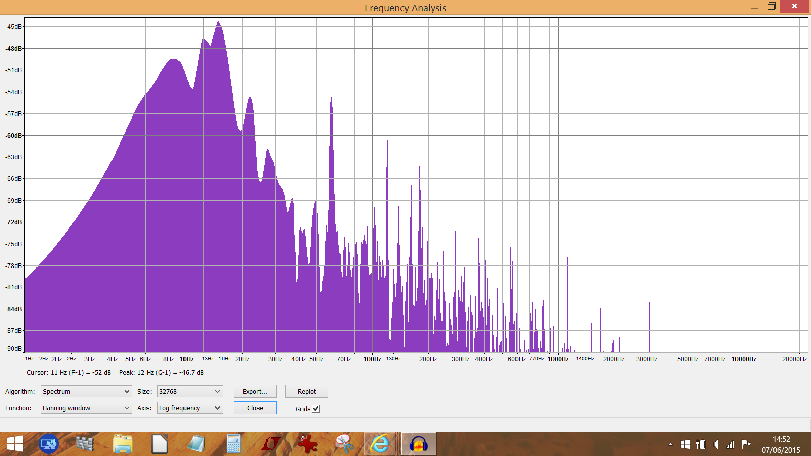

These were the shots from Audacity with the spectrograph set slightly differently from the defaults with '0' (as in the picture) being altered to '21' for the 'frequency gain db/dec' setting.
Interesting. That is a very different presentation of it and yet still showing the LF noise.
In Audacity I also noticed the two spikes at 60 and 120Hz but was surprised they were present on both versions. I thought anything like that would have been on the phono stage only. Seems to be on the master though.

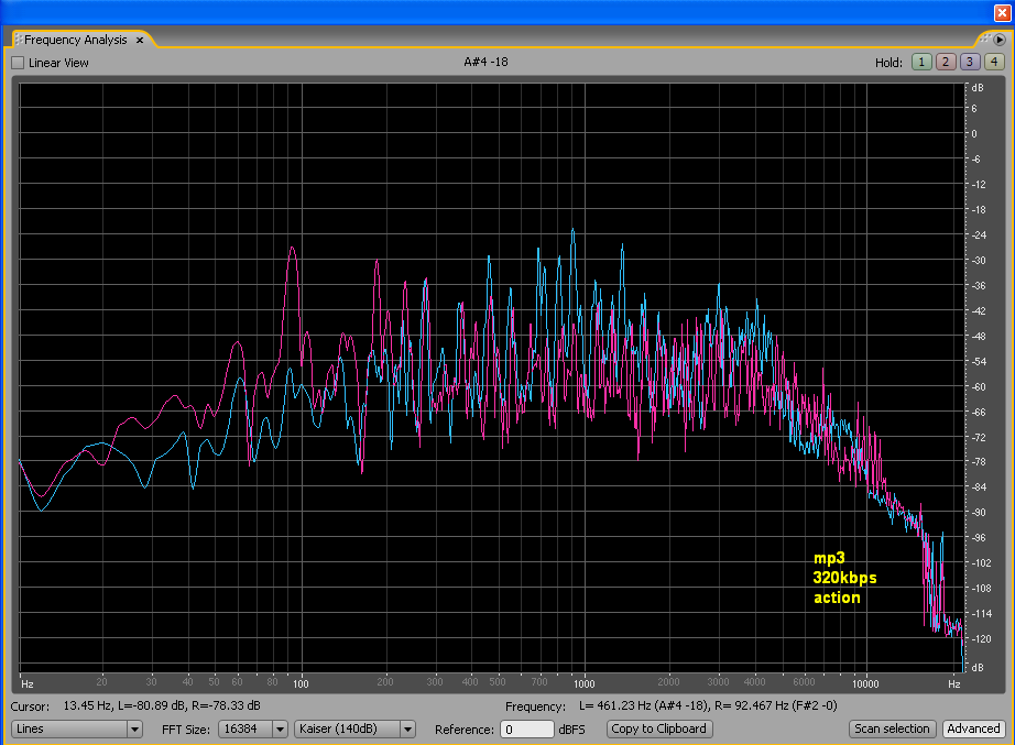

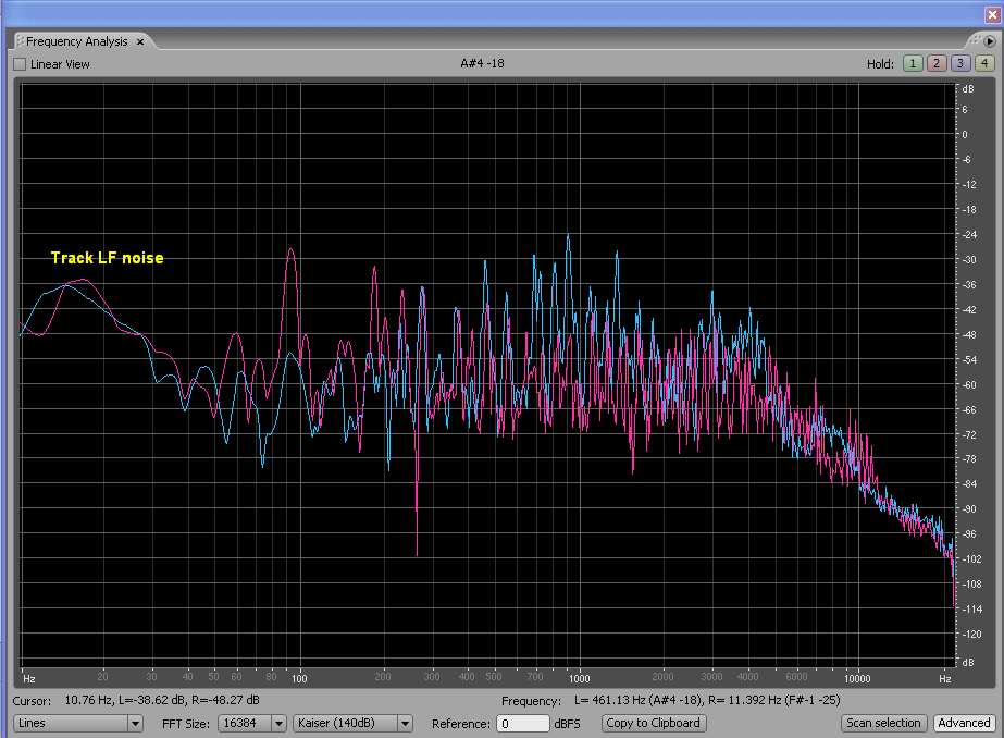

The a.wav spectrum - see the lame 320kbps action.
Yes, the tell tale sign of compression. (I still liked that one though )
No, I have 50Hz network here. 60Hz + 120Hz go from the master, from the US studio. My analog path is free of hum
Yes - my guess was right

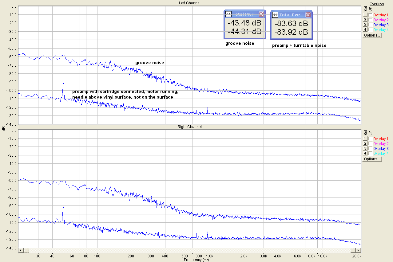

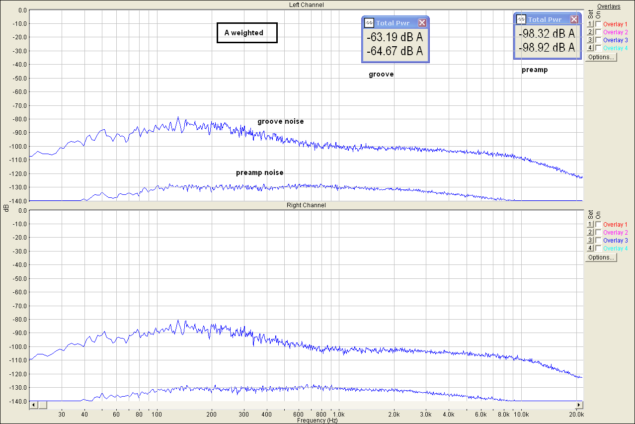

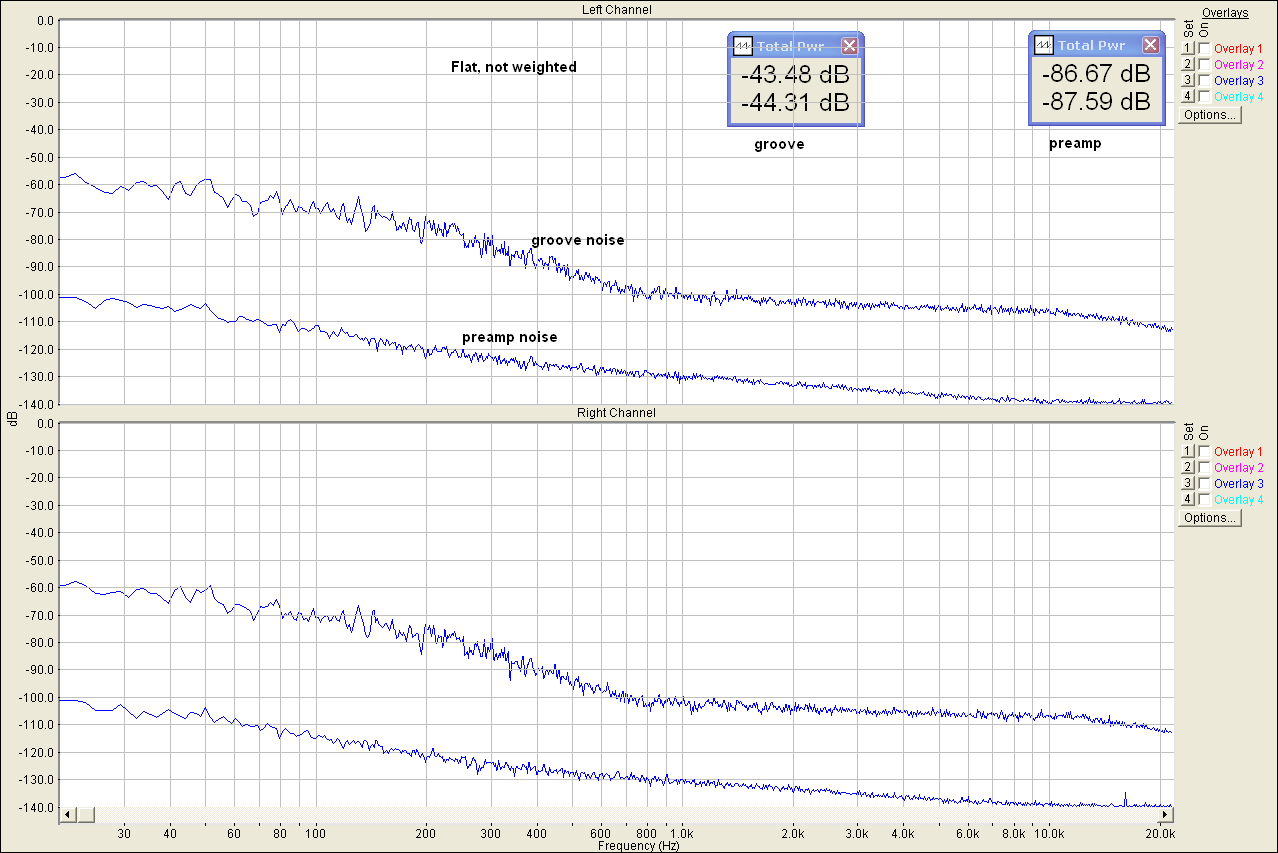

The groove noise is remarkably low, I still can't get over the fact that vinyl could be so quiet.
The groove noise is from different LP. It is just the minimum I get.
The last image is groove noise vs. preamp + turntable noise, turntable on.
You are right Karl, it is not easy to get these numbers.

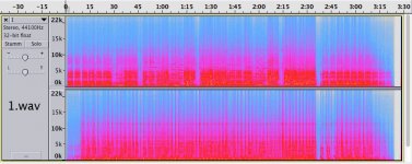

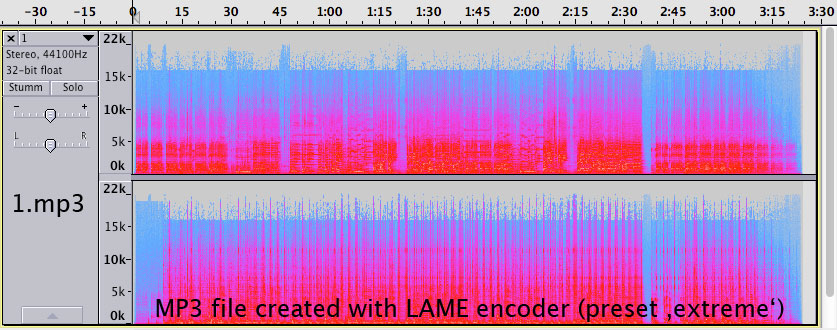

Instead of looking at a single spectrum, it is much more revealing to look at the spectrogram, where you can easily see that the MP3 encoder (most likely LAME, as I already wrote) cuts off at 16kHz once the signal gets loud enough. I encoded the vinyl track with LAME and got the same result (third image). The vinyl version seems to have a bit more high-frequency content; most likely because of noise, non-linear distortion and perhaps stylus resonance.
Why a "vinyl vs. MP3" comparison is called "vinyl vs. CD" is beyond me.
