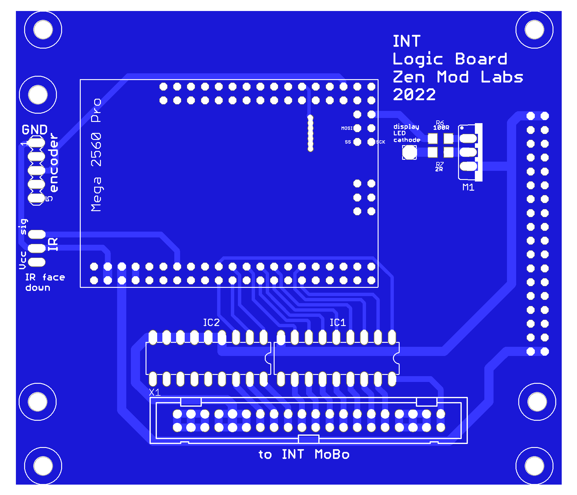

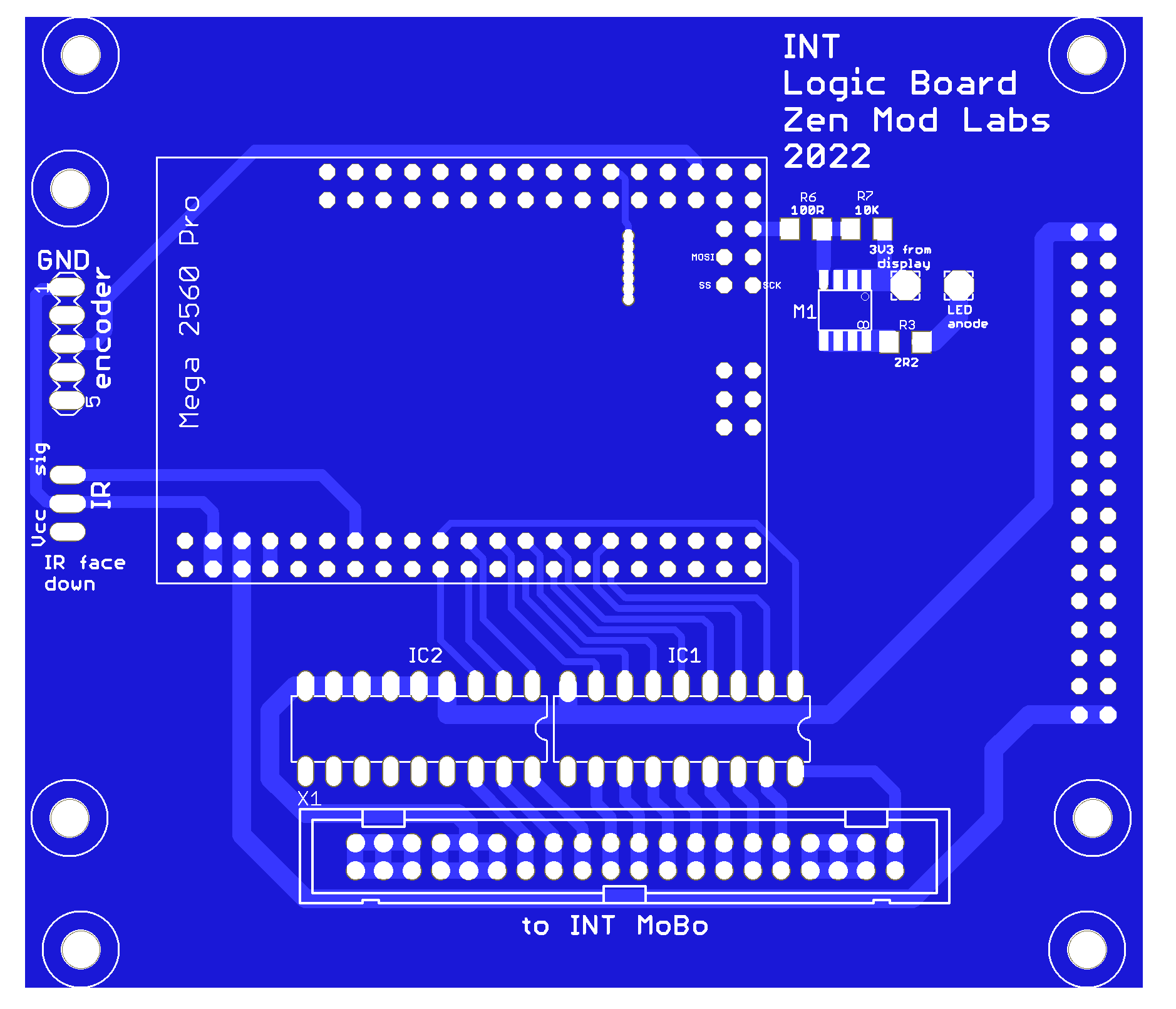

similar to one in Iron Pumpkin, shown on my ootoobe vids, with few changes - need to include few itsybitsies to enable proper stndby operation ...... meaning killing da TF screen while killing amp's main(s) Donut
still thing to be done, but trivial; I know that schm/pcb itself will be done in one evening, but code will ask for more time
anyway , nice and lazy project, never thought that I'll ever mess with integrated amp, and all remote/lazy but bells and whistles ...... but it seems Pa spoiled me to the (my very Omnienormous) core :rofl:
as always, experience is confirmed again - auxiliary circuits are more problematic than audio (at least for me.......... helped with fact that I have crappy criteria for my audio constructions :rofl: )
problem with TFT displays - as with anything - choice dictated with price ( not so much), performance (oh yes), availability (oh yes) ...... but not many of them are having solved/presented manipulation of LED backlight levels and state
and it is logical to organize things that display/light is gone Dodo when amp is sleeping
anyway, TFT display used for IP is perfect ........ but you can't kill neither 5V nor GND, from various Logic architecture reasons .......
ok, let's go backwards ........ I don't care for display actually being On all the time , nor for arduino ; Arduino must work in stand by of amp, display itself is not problematic neither from power consumption nor from longevity reasons....... what is important is just that damn light ..... so - obvious hidden solution is - kill just LED :clown:
that means - desolder 2R2 SMD on display pcb, it's in line from 3V3 reg to LED anodes
put 2 wires from resistor pads, route them to high side mosfet switch on arduino board and control damn thing
did I drew first iteration with low side switch , killing GND for display ......... just to check later and realize it's no-no solution in Arduino world .............. :rofl:
life is fun .........

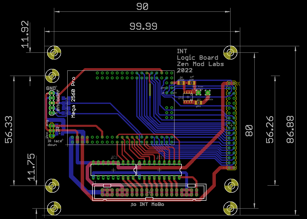

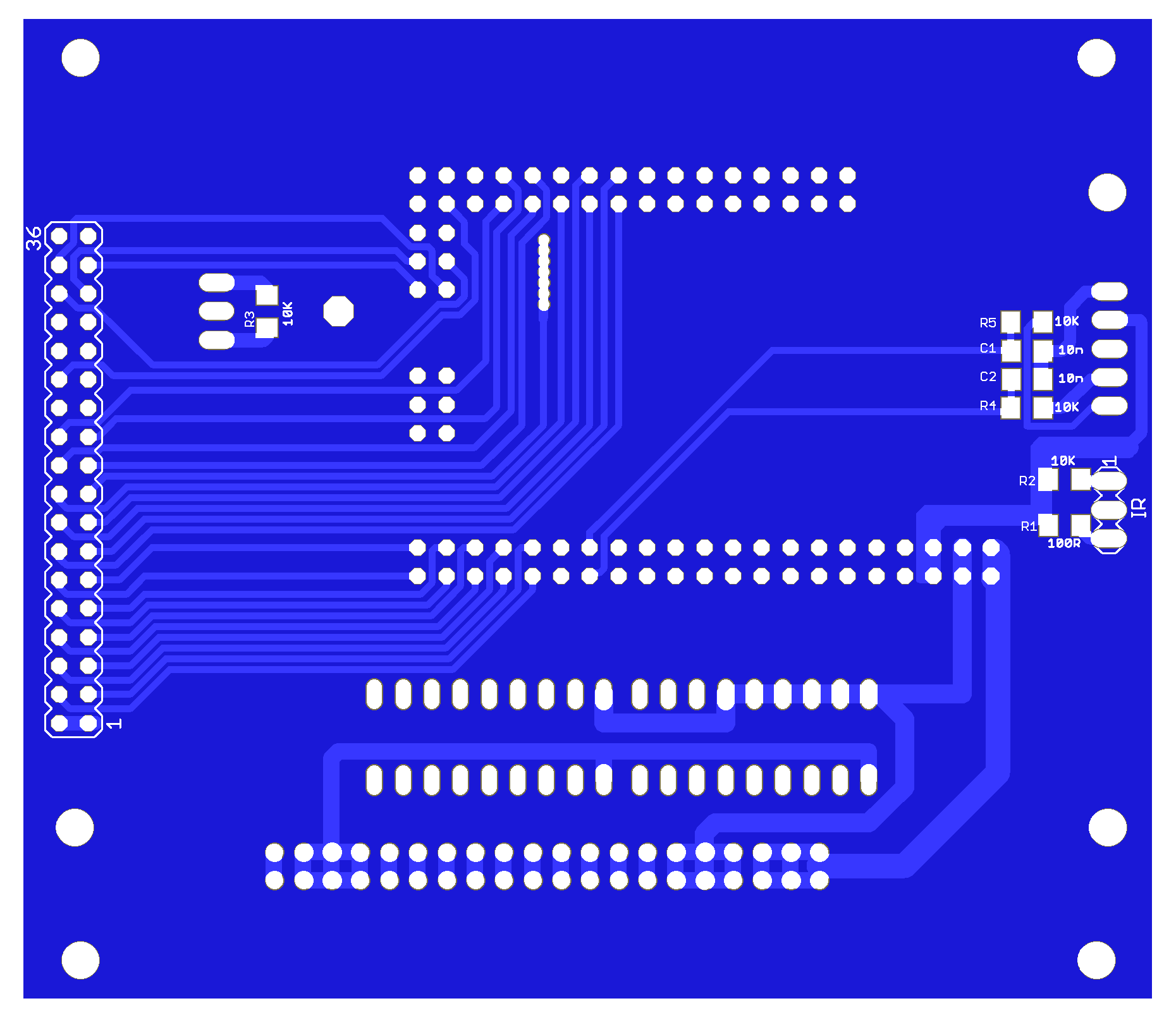

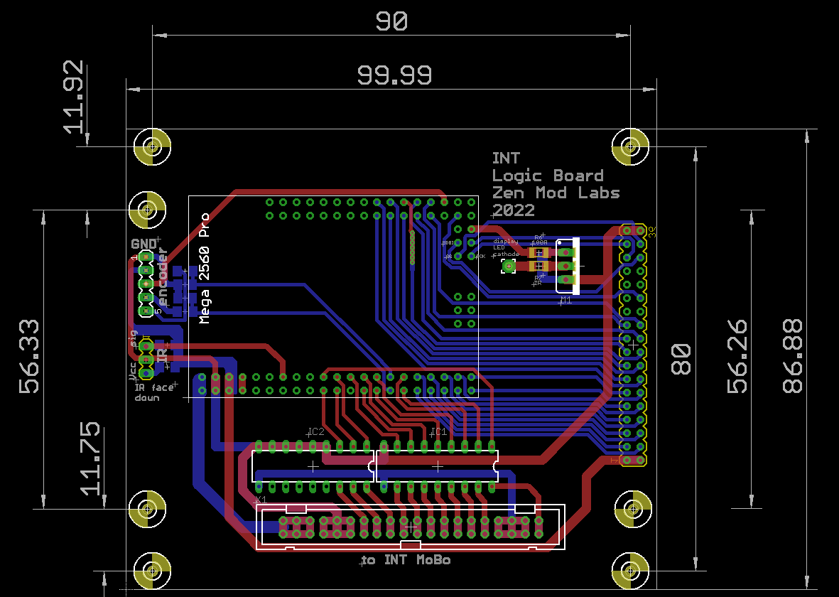

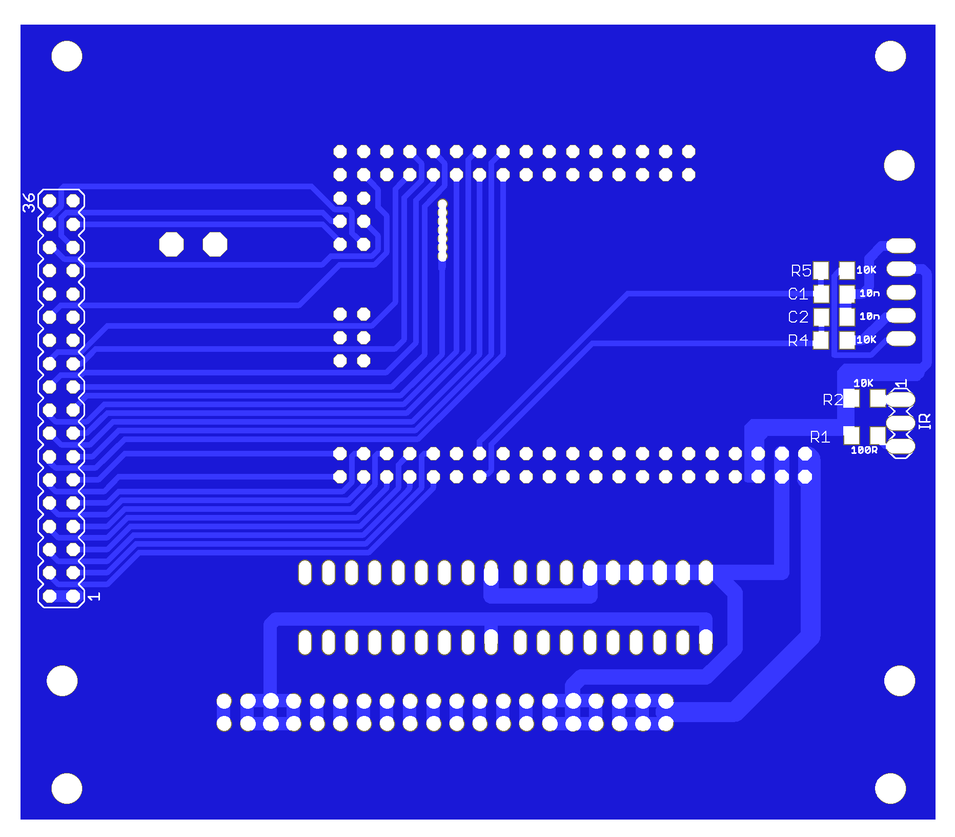

illustration of ZM's laziness :clown:
it was easier drawing two iterations of same module than going to workshop and check situation with display as is.......
first one with low side switch (ok, intended too kill entire display, no clever/Iznogood), then rummaging through internet - seeing majority of displays having convenient series resistor for LED on plus side
no such info for exact display I'm using, of course ....... :clown:
so, I made iteration with LED switch on high side , and only after that I actually did go to Workshop, to check my display....
guess what - 2R series resistor is between LED cathode and GND ......... so low side switch is what I need :rofl:
check was successful, 2R removed, two wires, 2R inline with mAmeter ......... off and on is working (when On-LEDs sucking 95mA), while display itself is happily undisturbed working all the time, with or without light
Now you see me, now you Don't!
:devily:
and I can use no brain ( desirable state of affairs), resorting to TO220 BUZ11, instead of SO8 critter, as in previous case
