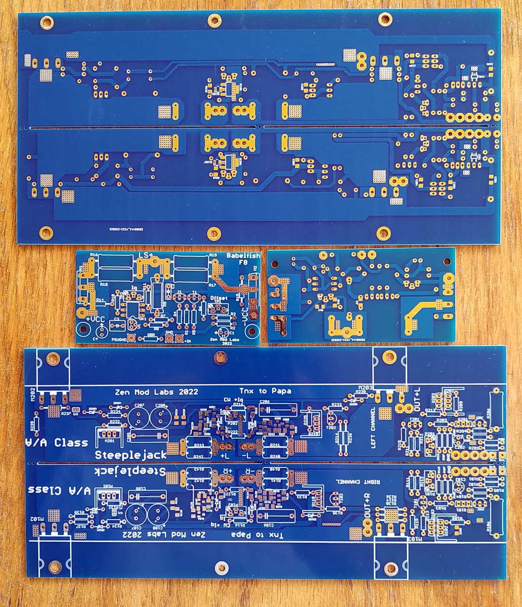

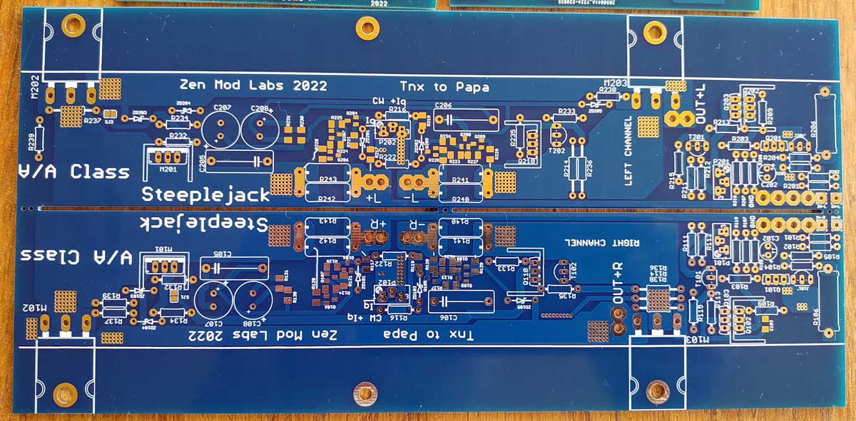

did some work on assembling several kits for Greedy Boyz, and having Steeplejack pcbs fedexed to me
thinking when to find some time to proceed assembling pcbs of already started ones - INT and Irreverent and .......... is it clever at all to order pcbs for some other new ones
was thinking about Spreadsheet (as Papa is doing) to keep some minimal awareness WTF I'm doing, but no - have no brain for - there is no system applicable to ZM's Mightiness

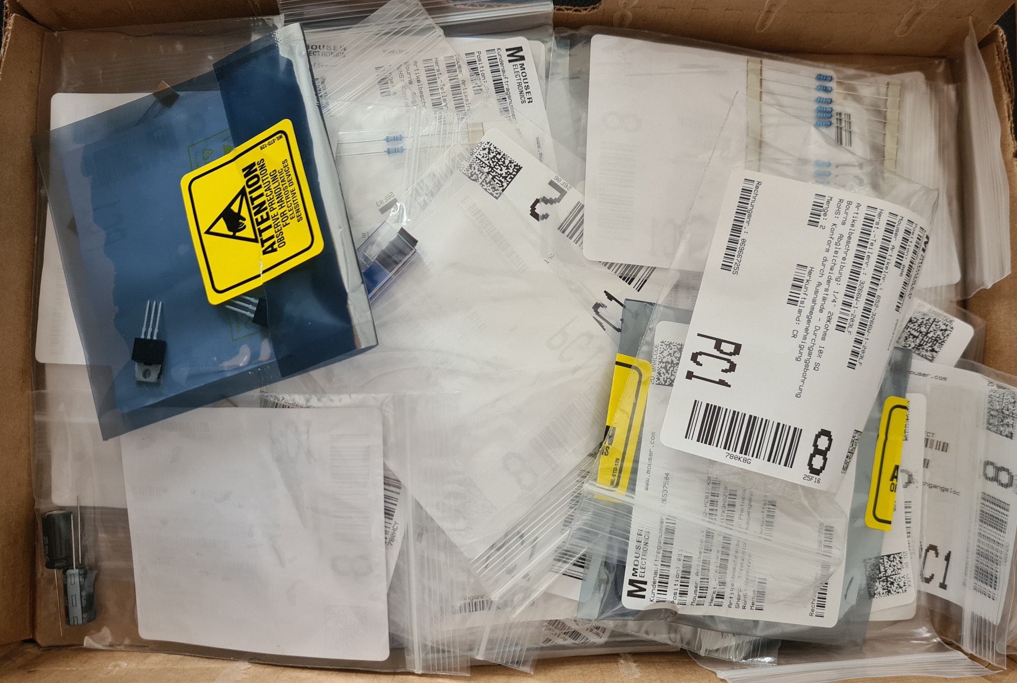

In the meantime - being a Greedy Boy, obviously - Santa... I mean the delivery man was here with all the parts for the Babelfish M25.2 and the Scryer

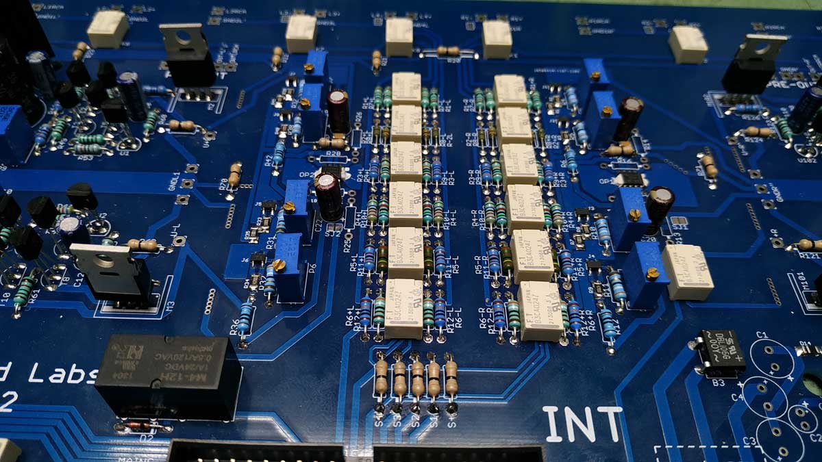

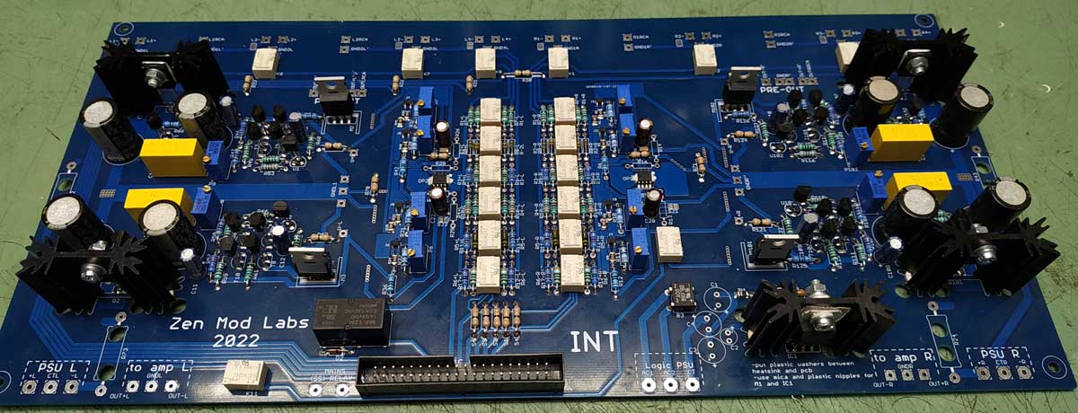

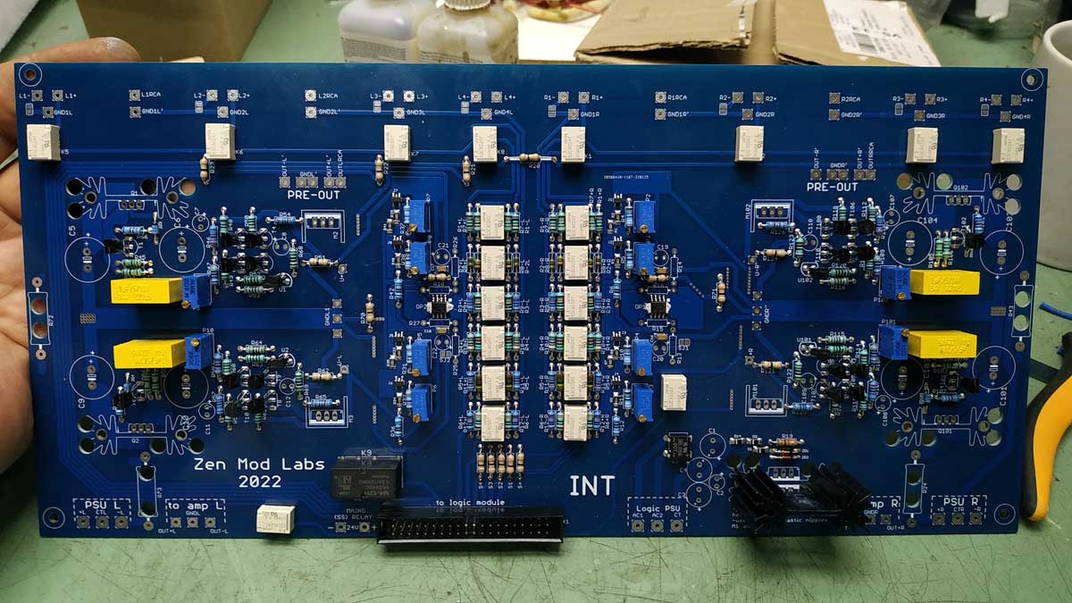

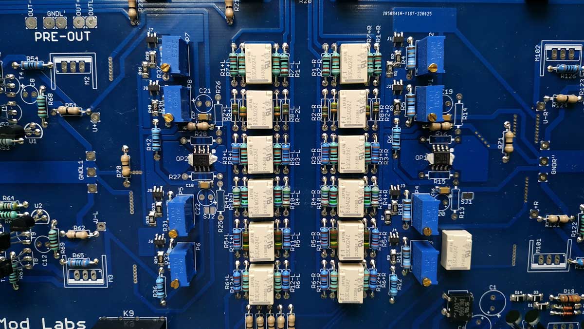

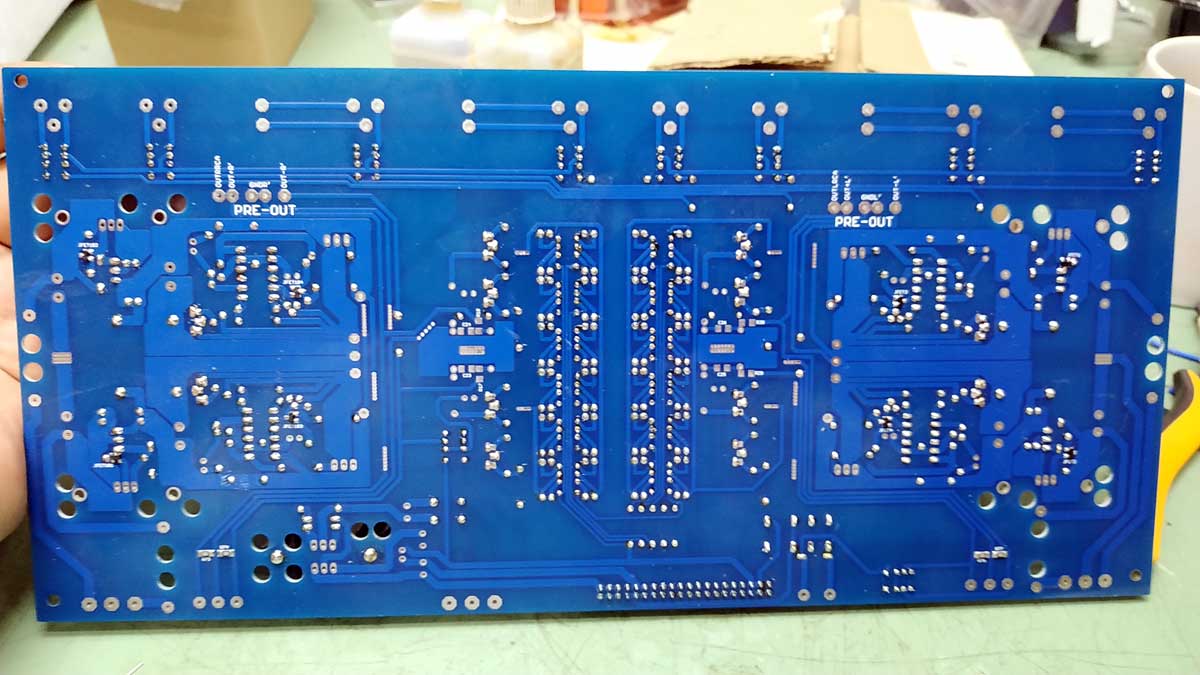

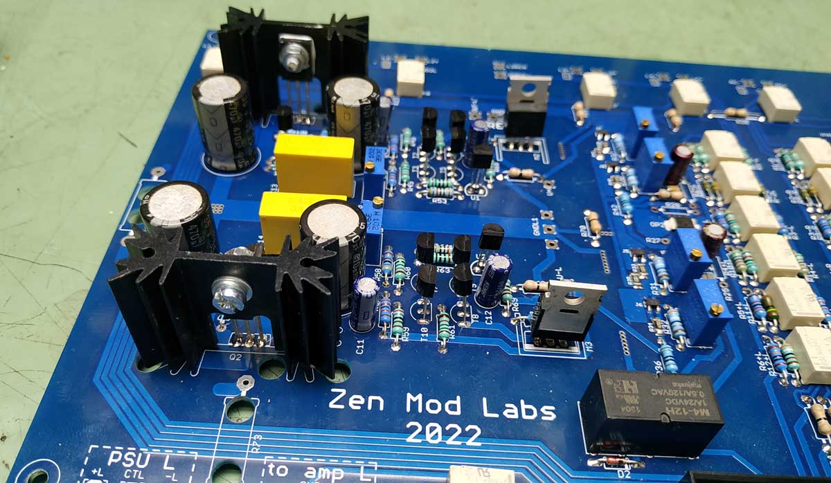

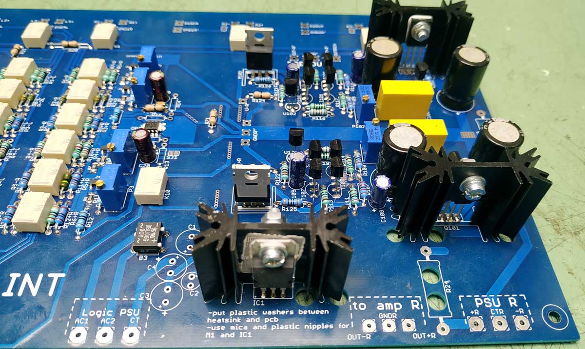

A fully balanced op-amp pre? Looks great!
yeah, dedicated FE to make INT with any sort of amp of regular gain, be it SE orBAL
but nope Plethora FE....INT is Bal relay selector, followed with 64 step attenuator, followed with JFet buffers, followed with OPA1632 (SUSY)
all gizmos, including front encoder, TFT, standby function etc.
edit: intention was that INT is almost characterless ..... sorry, can't squeeze Iron Turtle in ......
