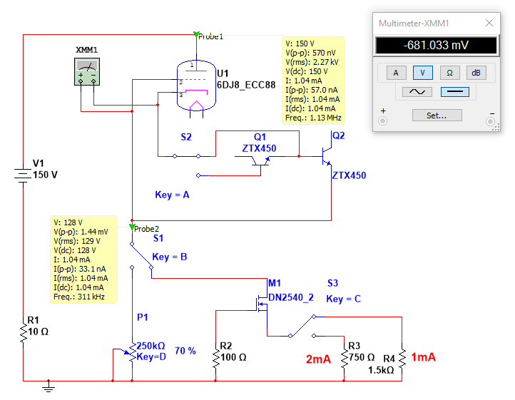

That is interesting. I will definitely build this when I have the time.
Thank you very much jackinnj.
On second thought, the 390 resistor will add noise. I had thought of using an 1N914 diode, but the fluorescent light modulates the PN junction. Mbe just a low noise NPN transistor as diode.
It would be helpful to dial up the current sink for more values so the slide switch will be replaced with a rotary or potentiometer.
Changed the DMOS to DN2540 which has a wider range of current than the LND150.

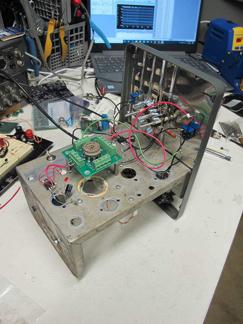

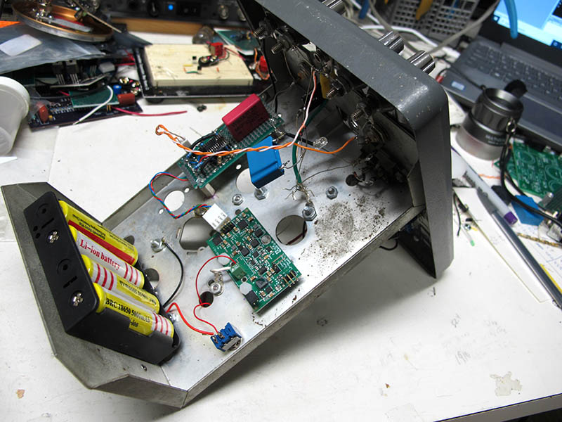

It isn't pretty, but it works -- ganged up an OPA1654 for ~2.4nV/RtHz. Battery pack is 16x 9V alkalines. The Eico 250 had a broken meter and was purchased for a couple bucks -- the great thing about the Eico VTVM's of the era is that the chassis and surround are steel, not aluminum so line interference is mitigated. Power for the filaments is provided with a pack of 18650's -- these also drive one of Jan's "Silent Switchers":
