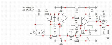

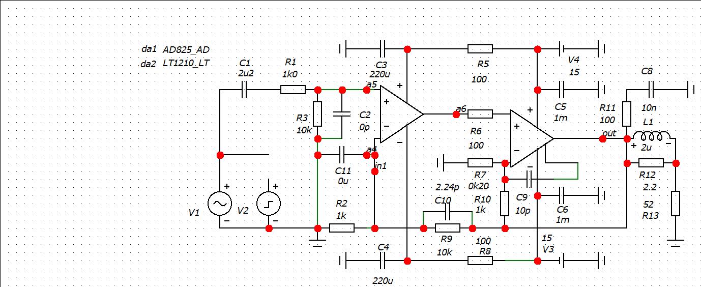

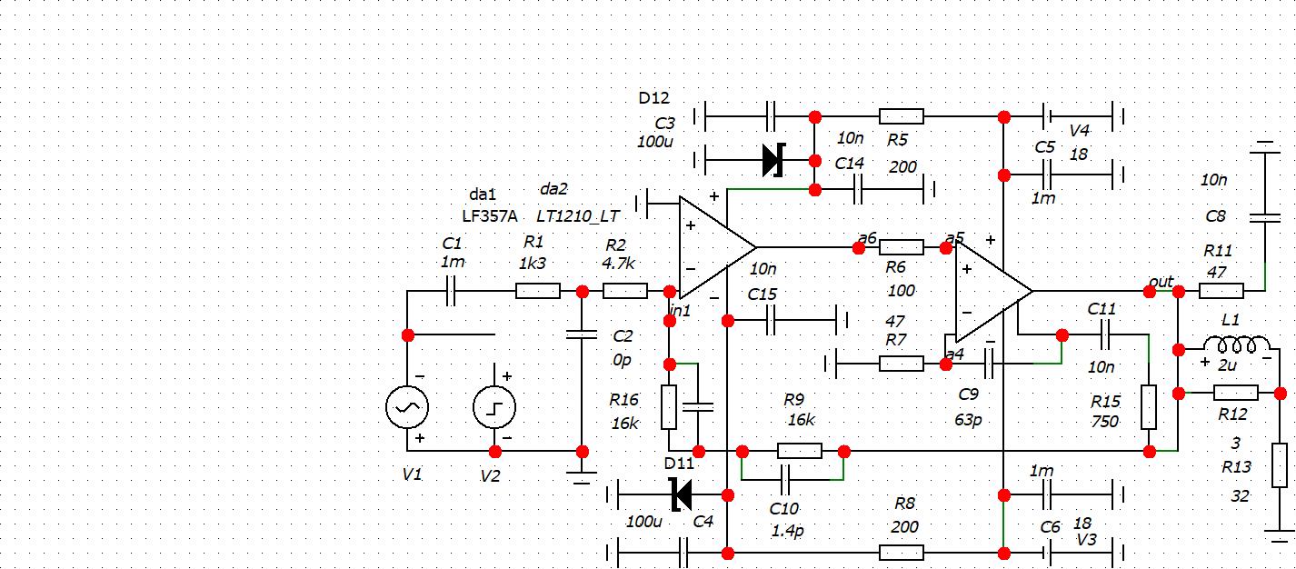

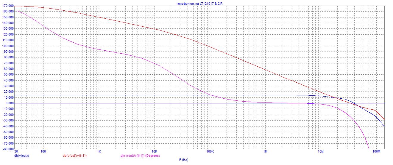

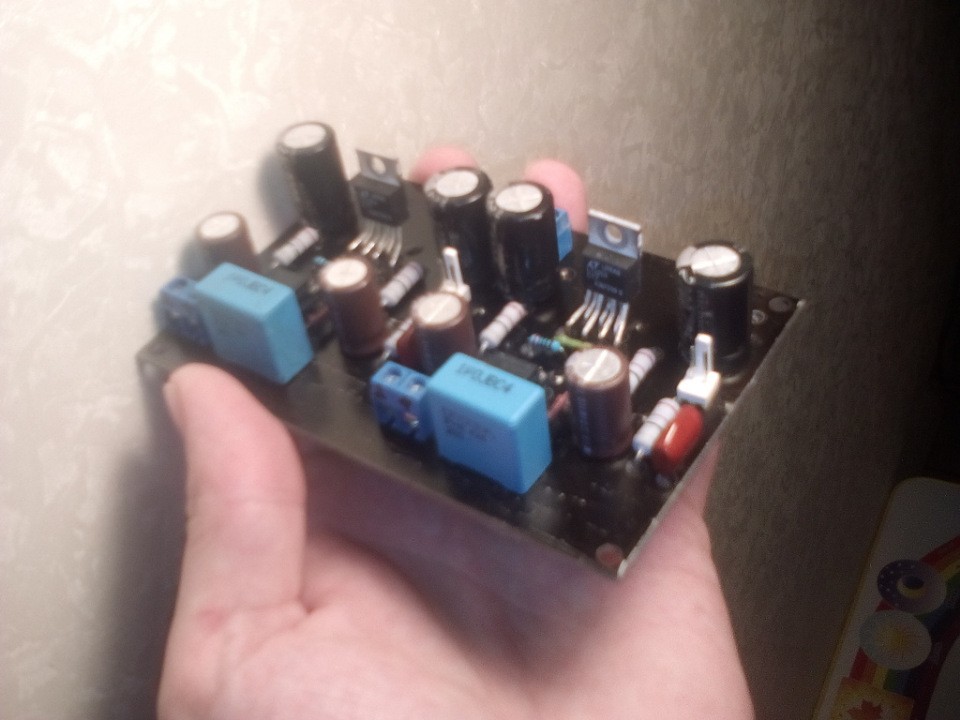

My composite is on LF357/LT1210 . Gain at 20kHz 123db
Non-inverting composite with embedded OOS .layout

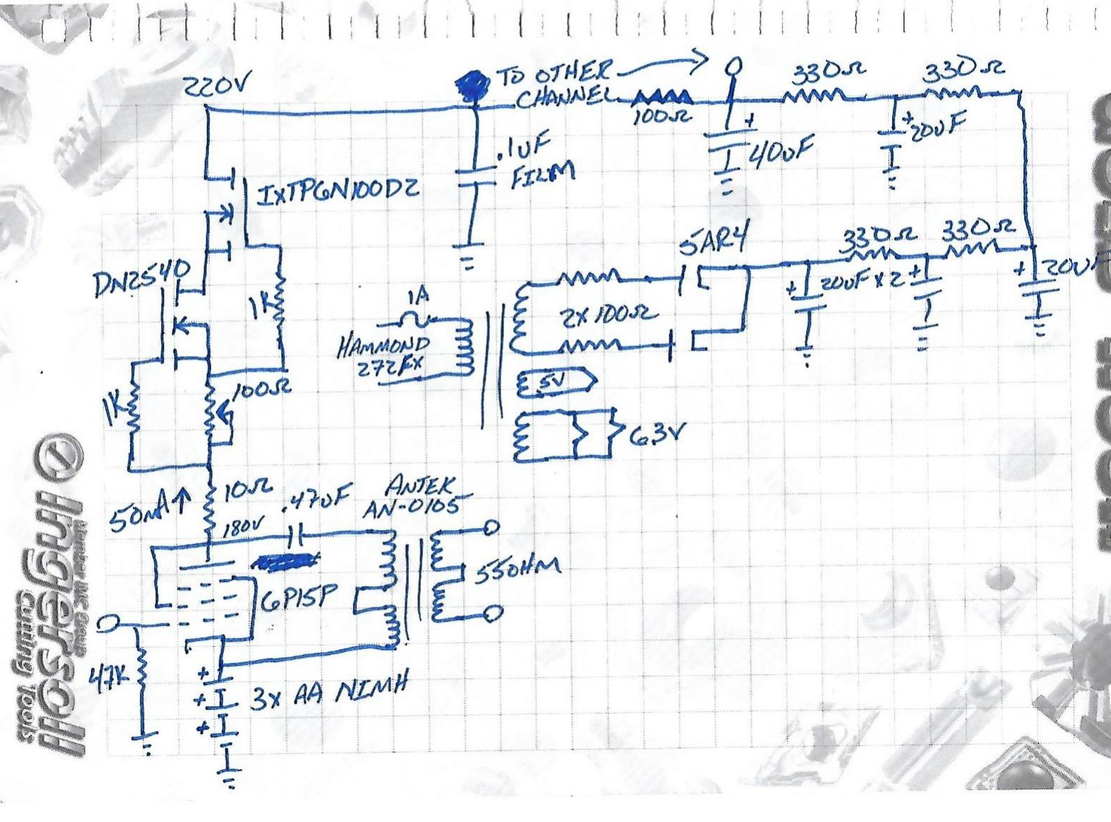

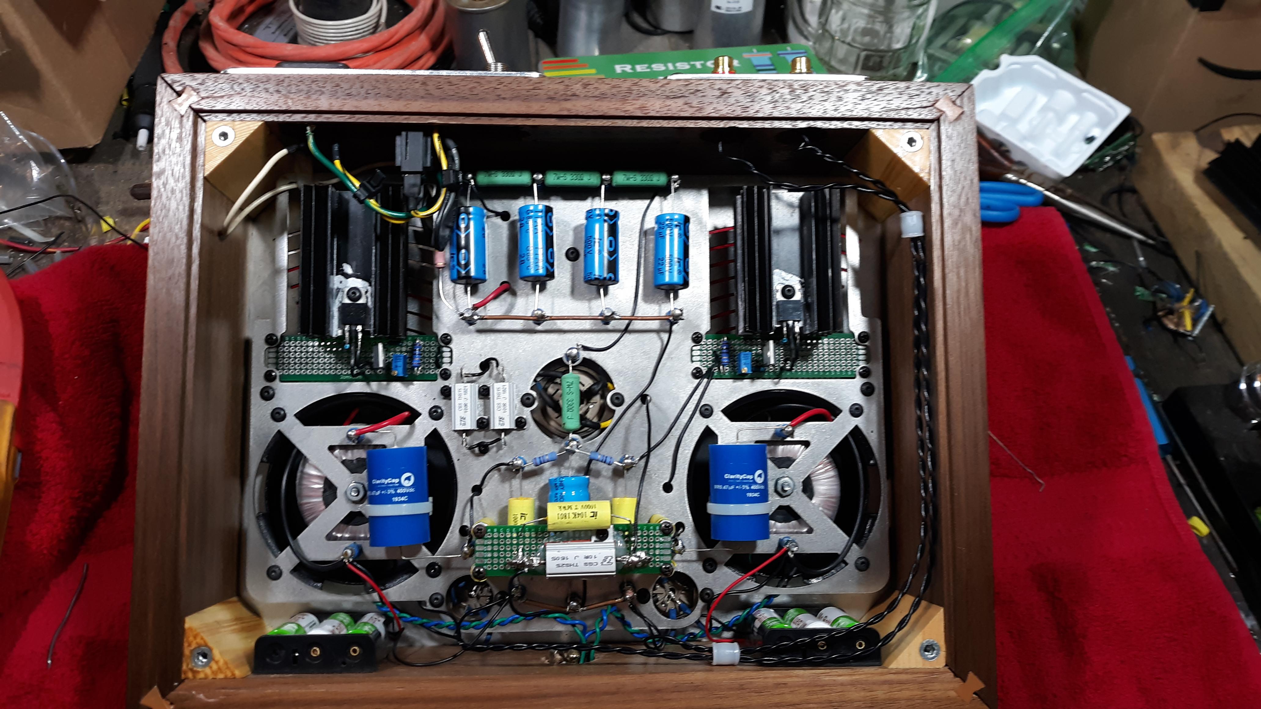

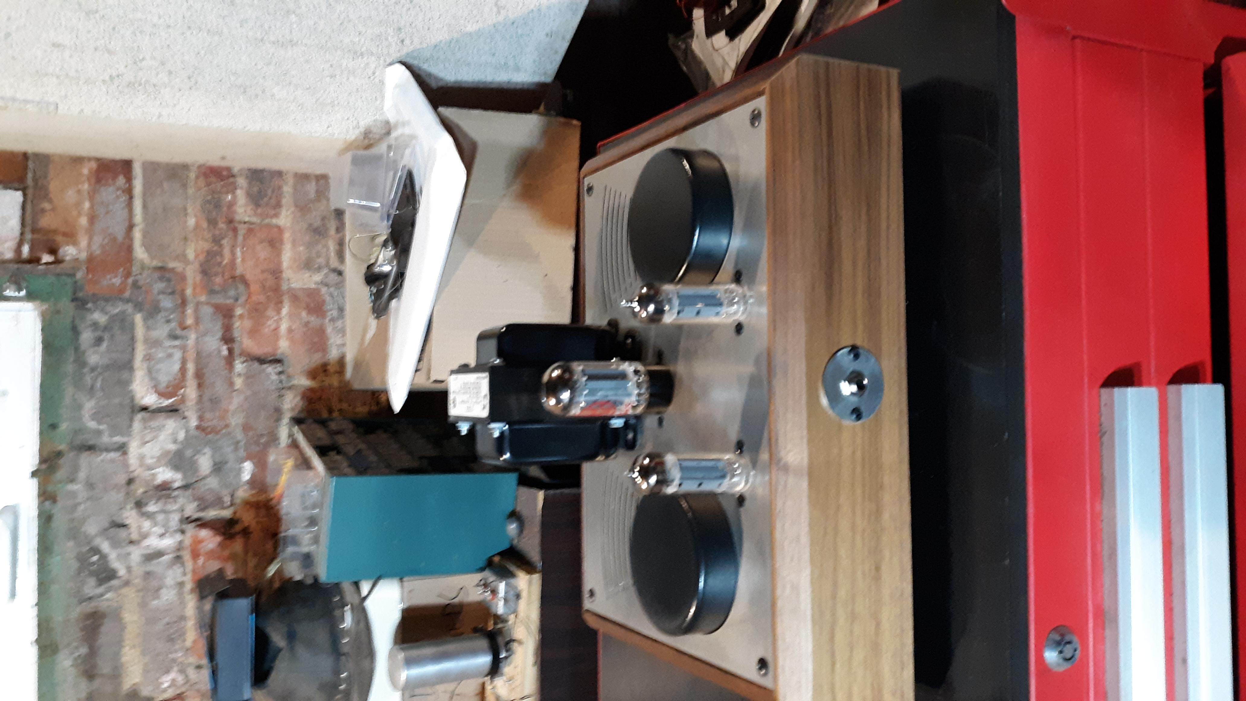

Here's one I made for a friend that can be done on the cheap... it's a 6p15p parafeed. Granted it is geared towards 55ohm headphones it wouldn't take much to optimize it to your cans of preference... especially seeing how the output transformers can be had for $10. Best sounding headphone amplifier I have ever heard. I am proud of this one. There is a small bug in the schematic... it doesn't show the center tap of the power transformer, and it should be grounded.
