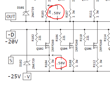

I should explain the process that led to the current operating stats of this amp. Several attempts were made to key on readings at various locations. The amp is essentially in two sections - 1. the front end (read pre) and 2. the output boards w/satellite bias PCB.
Each of those two section can/should be adjusted to it's optimum based on the designers specs with readings and targets at designated spots. That would include bias voltages across resistors on both sections. Difficulties arose when aiming for a particular bias value at the mosfet feed resistors. Several targets were suggested but never satisfactorily attained. If for example, something ~ 0.25A was set, the amp sounded weak and colorless. If adjustment on the front end were performed in an attempt to correct that condition the output bias values also changed.
Finally it was suggested to just set the front end to as close to optimum as possible (as described in the N. Pass design article) and ignore everything other than the DC offset at the terminals feeding the speakers. Doing that resulted in the most powerful, balanced and musical output from the build.
With some assistance/confirmation from Andrew :up:, it was determined that NP had indeed specified 0.58V to all the output transistors in the single ended version of this amp. I didn't use matched mosfets and resistors on the OBs so the feed resistors all came in between 0.59 and 0.62.
So working backwards, keying in on zero DC at the outputs also brought the power draw spec in line with the designer's published estimate:
