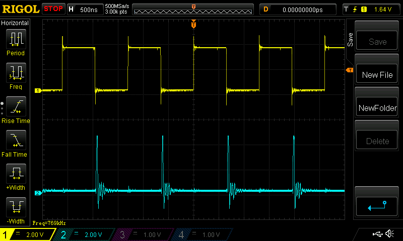

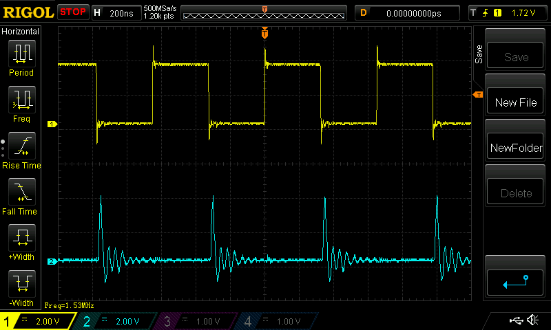

The output side - RPi4 I2S data output at 768kHz 24bit, both BCLK and FCLK slaved to an external clock generator. And just for the fun - 1,536kHz samplerate, the same I2S signal. But I have no DAC capable of 1.5MHz 24bit :)

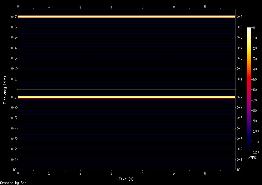

I2S loopback bit-perfect up to 1,024kHz samplerate and 48bit frame width (i.e. the same bitclock 49.152MHz as would be with 768kHz samplerate and 64bit frame width).
Recorded 341kHz sine signal played by the I2S-out and captured by I2S-in, connected at the pinheader.
No xruns, period size was 1024 which corresponds to 1k period_elapsed calls per second for playback and the same for capture. Since the two DMA-filled buffers in the PCM peripheral are only 64 frames long (and fill watermarks are set rather tight), we can assume several ten thousand DMA operations for each direction per second. All handled safely, no xruns, no CPU load detected.
The 1.536MHz samplerate (i.e. 73MHz bitclock) was already corrupted, maybe CM4 with extra short routes would do.

and look at the I2S loopback spectrum of 700kHz sine signal at 1,536kHz/16bit/2ch. If you have a DAC and ADC capable of these rates, the RPi4 (or better CM4 with shorter traces) gives you the I2S interface. REW runs perfectly on RPi4, the linux version already supports 1,536kHz samplerate and increased 4M FFT for this purpose. If you need windows, use the USB gadget mode (provided windows could handle the 1.5MHz samplerate advertised by the USB gadget, linux has no problem with it, of course). The packetsize (1536000Hz * 4bytes /8000 uframes = 768 bytes) is well below the max USB isochronous packetsize of 1024 bytes.
