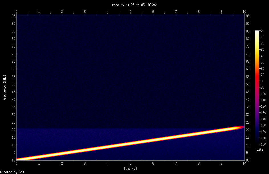

With optimum settings you can get rid of almost every artifact with sox.
I'm wondering how you'd use or choose the sox resampling parameters properly. There are endless options. I tried several different ( I wrote once an article on my blog)
I wouldn't be happy with just low,mid,high quality options or similar.
My current test was just using the libsamplerate API by libsoxr-lsr, i.e. the "emulation" of best, medium, etc. libsamplerate configs. I want to use straight libsoxr. Params would be either the pre-prepared combinations
soxr.h - audacity - Audacity: Free, Cross-Platform Audio Editor and Recorder - Google Project Hosting , or all the parameters soxr.h - audacity - Audacity: Free, Cross-Platform Audio Editor and Recorder - Google Project Hosting . That would require adding an option to the alsa-lib config code.

Have you played with different options for "best" to get the artifacts in your graphs out?
e.g.
rate -v -p 25 -b 93 192k
or similar? -v is pretty important parameter. Without -v all kind of artifacts will show up.
You might add dither -S. Though as far as I can see the src takes care on aliasing, if you don't specifiy -a.

Have you played with different options for best to get the artifacts out?
Those lines on the spectrogram are not artifacts but missing samples due to apparent bugs in the integration code. I will write the alsa-lib plugin from scratch anyway (using plain libsoxr), ironing out these inconsistencies.
You might add dither -S. Though as far as I know the src takes care on aliasing, if you don't specifiy -a.
The code does not use sox. Libsoxr is a standalone library inspired by the sox rate effect, similar to what the foobar sox plugin does. It does not offer dither, as of now. It was created by audacity team. Just check libsoxr out in google.
