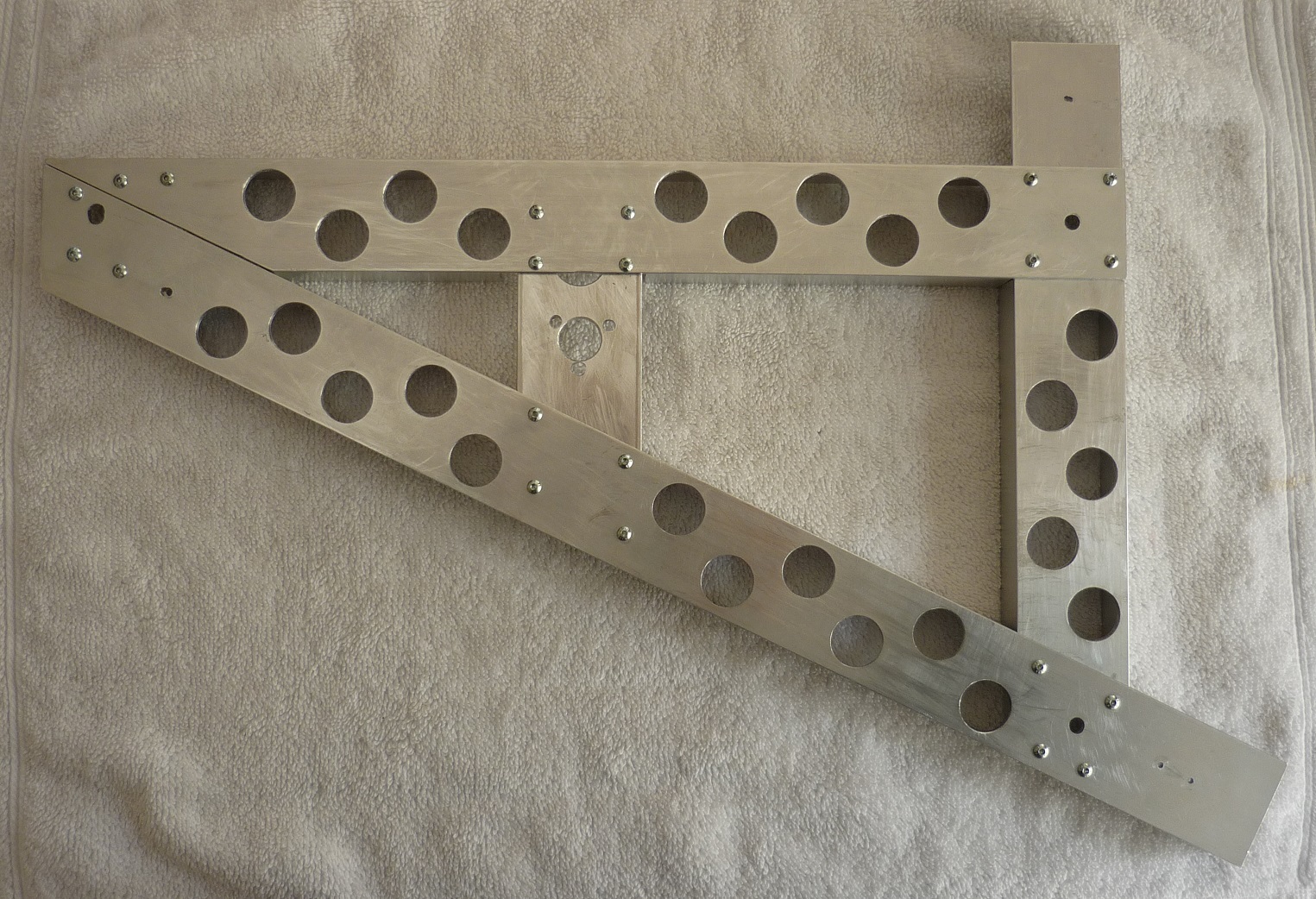

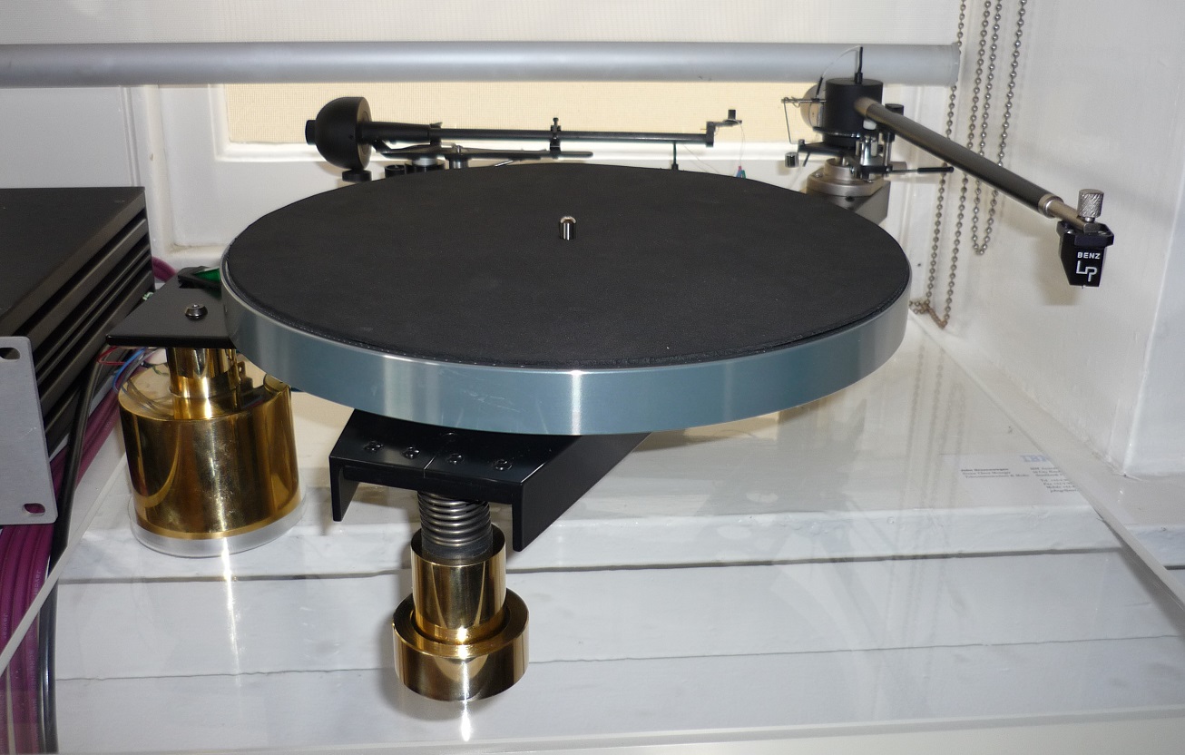

Hehe - here's my unique 'mod' for an LP12 ... which has definitely improved the sound which I had! :D So I sold my LP12 and Graham 2.2 arm and am a very happy chappie. :)
My 'SkeletaLinn'; it uses the following LP12 parts:
* Cirkus bearing / inner & outer platters
* springs & grommets
* motor & belt.
But no plinth and no top-plate.
The heart of it is a triangular 'chassis' made from aluminium U-channel. This sits on top of the 3 springs and, because the bearing and the arms are bolted to the chassis, it avoids the lossy connection which the standard pressed-steel chassis and armboard has - so delivering better low-level detail retrieval (just as the Keel does).
The motor is off-board - on a heavy, 3" brass 'pod' which acts as a vibration sink. With the 12" 'Univector' UP arm (made here in Melbourne - BTW a 9" one has just been fitted to a 'Keel'), it produced a significant increase in SQ over my LP12/G2.2.
Andy

clearly that was not an afternoons work:D
Haha - indeed El d! :D
I listened to the 12" Univector arm just before Christmas 2012 (mounted on an SME20) - and fell in love with it. So I spent most of my 3-week Christmas break trying to figure out how I could fit one to my LP12. It soon became obvious that I'd have to butcher the LP12, to do this ... which I wasn't prepared to do.
So I started sketching out a triangular chassis, which I decided would be made from bolted-together pieces of aluminium U-channel, 40x25x3mm (knowing that Linn had chosen ally for their Keel!), as this should produce a very stiff, light structure.
I then ordered the LP12 parts from a dealer in the UK and by June 2013 had v1 working - that's when I realised that it was a worthwhile result, so I began the process of breaking up my LP12 and selling the parts, individually.
Now, as with most things, v1 had a minor flaw ... just as with the LP12, one spring was more heavily weighted than the others! :( In the LP12's case, this is the spring nearest the arm; in my case, it was the spring nearest the platter. The solution was obvious - move this spring further away from the bearing ... however, calculating the right distance proved difficult. I eventually got some good advice from the Tweaks/DIY Forum on Audio Asylum (from an engineer who knew his trigonometry! :) ) and when a mate of mine agreed to buy v1 off me, for the cost of the parts, I started to build v2.
This was completed last October - the result (taking into account the weight of the 2 arms I have mounted on the chassis, as well as the weight of the platters & bearing) is that the weight distribution is 36% : 33% : 33%. So almost perfect - and better than what an LP12 achieves. ;) (The heaviest weight is still on the spring nearest the bearing - I should've moved it out another 1/2".)
Andy
