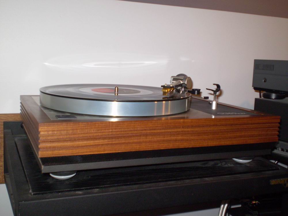

I recently had my Linn apart to fix the power supply. When I put it back together I wondered about leaving the flimsy bottom off, or adding a Trampolin or one of the other after market solid bases. My final decision was to take an old Mission Isoplat I had laying around and machining it to fit the inset where the old baseboard was fitted. The Isoplat is made of 5/8 MDF and is quite dead. It works and sounds great. The bass is tighter and the stage is more open. My table also sits on a Target wall mount stand so the mechanical isolation was already quite good.
The Isoplat used to sit under my CD player but I really didn't notice any significant benefit from it. I measured the Isoplat and it was just the right size to sit under the Linn. After cutting an inset all the way around, it fits tightly into the bottom of the plinth. The Isoplat is then screwed into the plinth. It reminds me of the old Mission 775 table with the Sorbethane feet.
