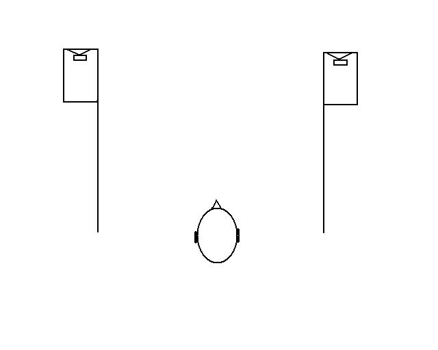

I once got funny results with speakers mounted on standard-size floor boards (OSB) that way:
BTW, wasn't there something called "super stereo" or "ultra stereo" that involved a second pair of speakers and some signal processor?
