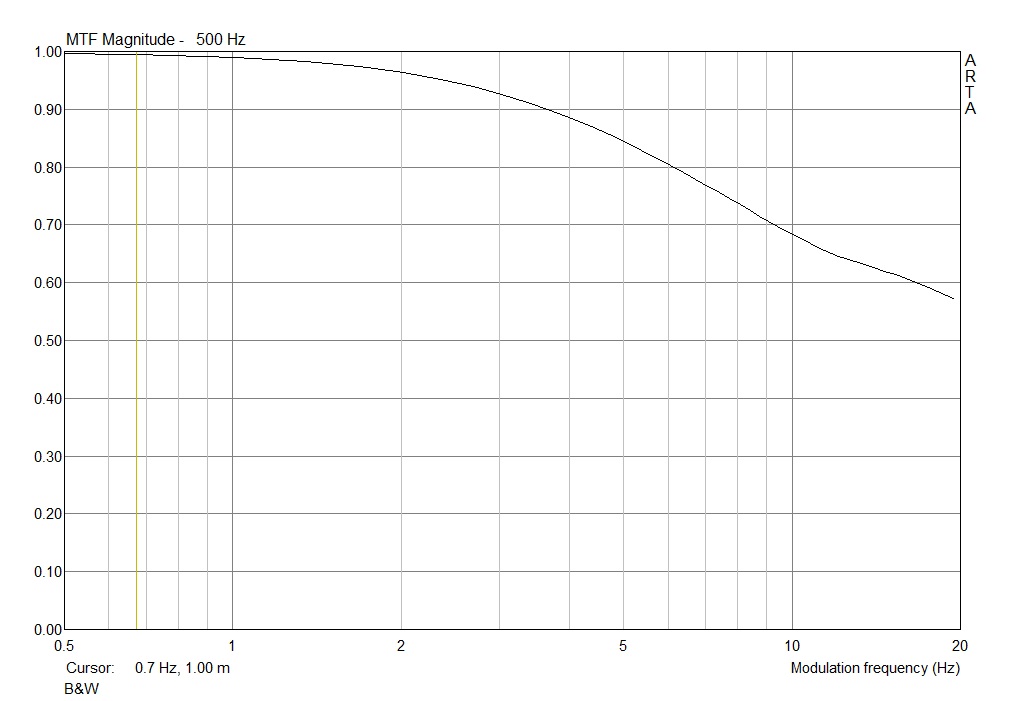

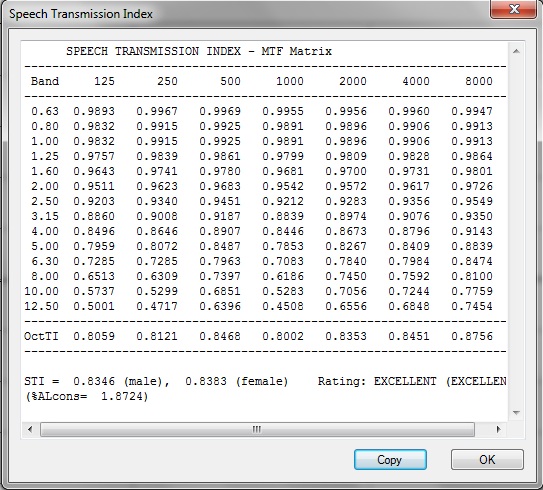

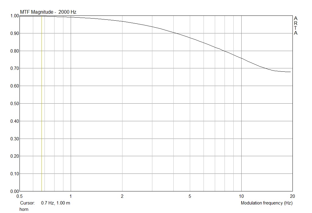

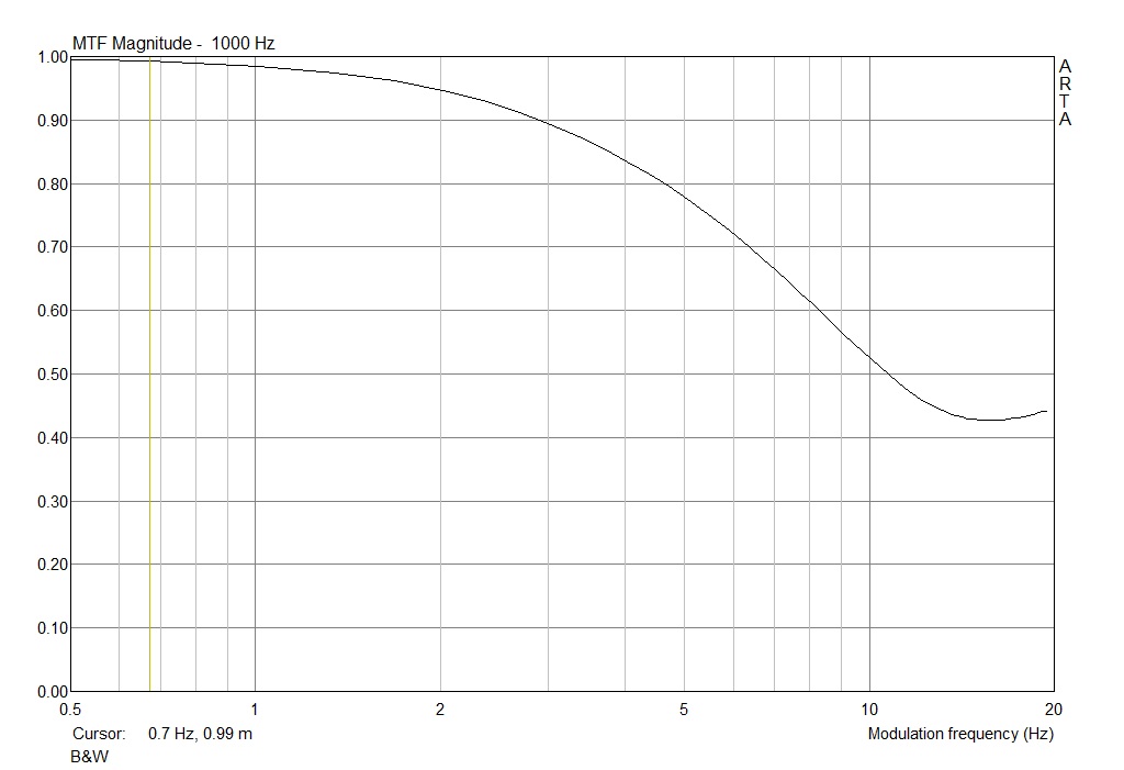

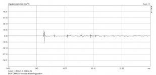

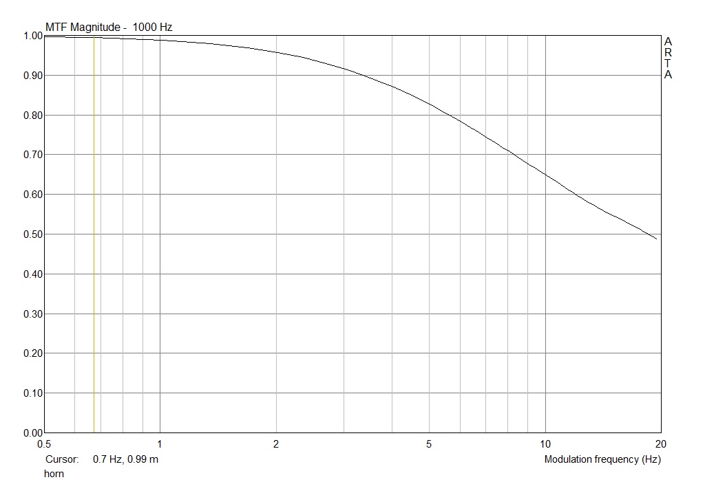

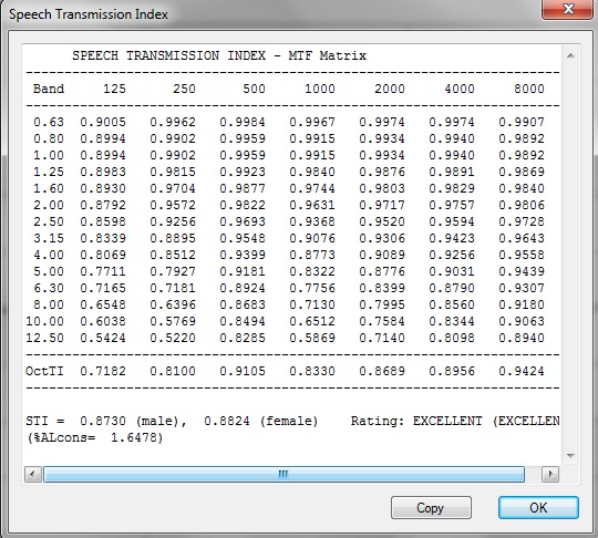

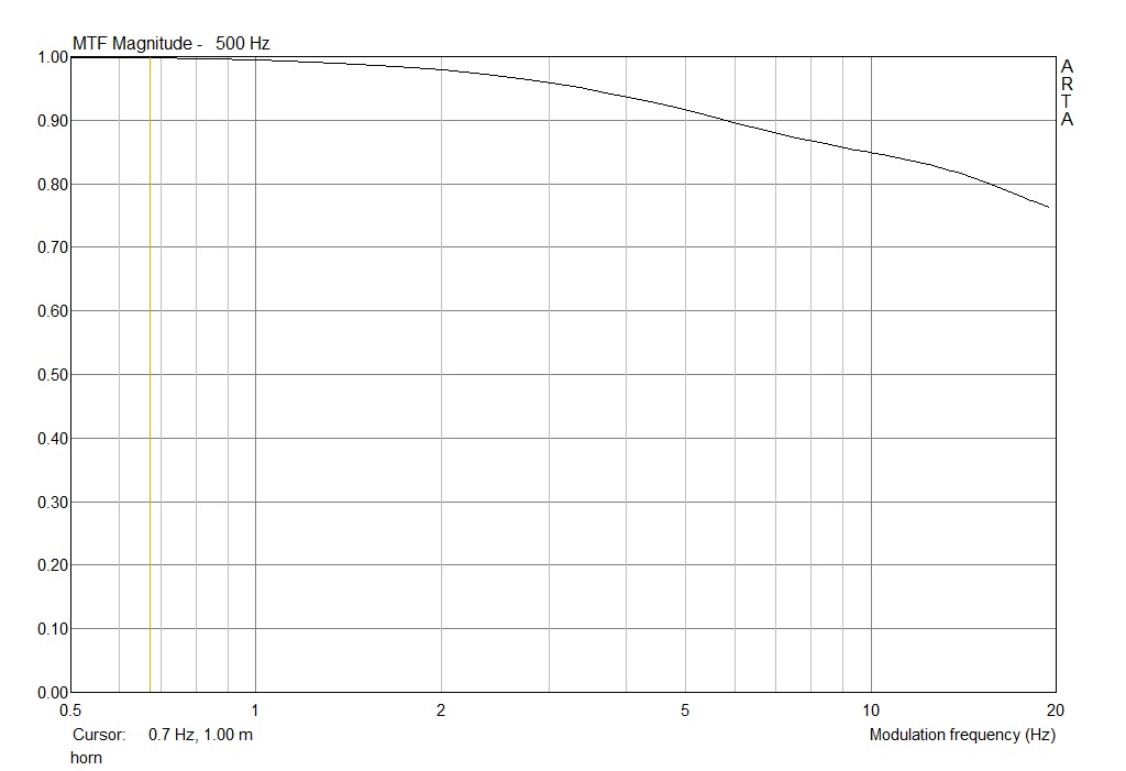

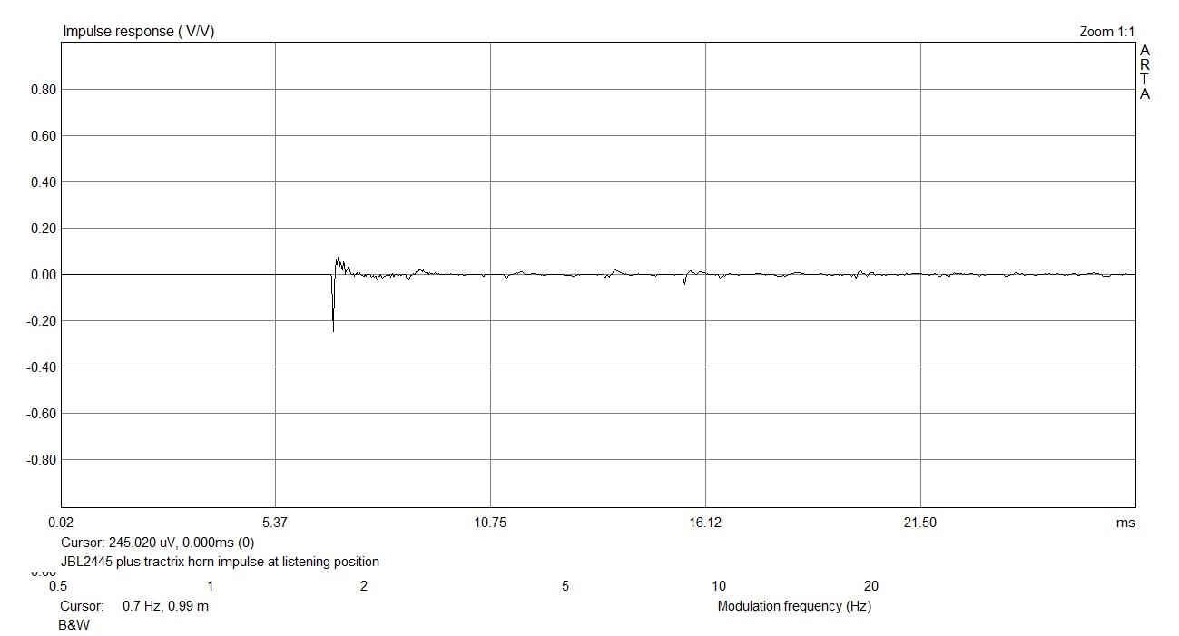

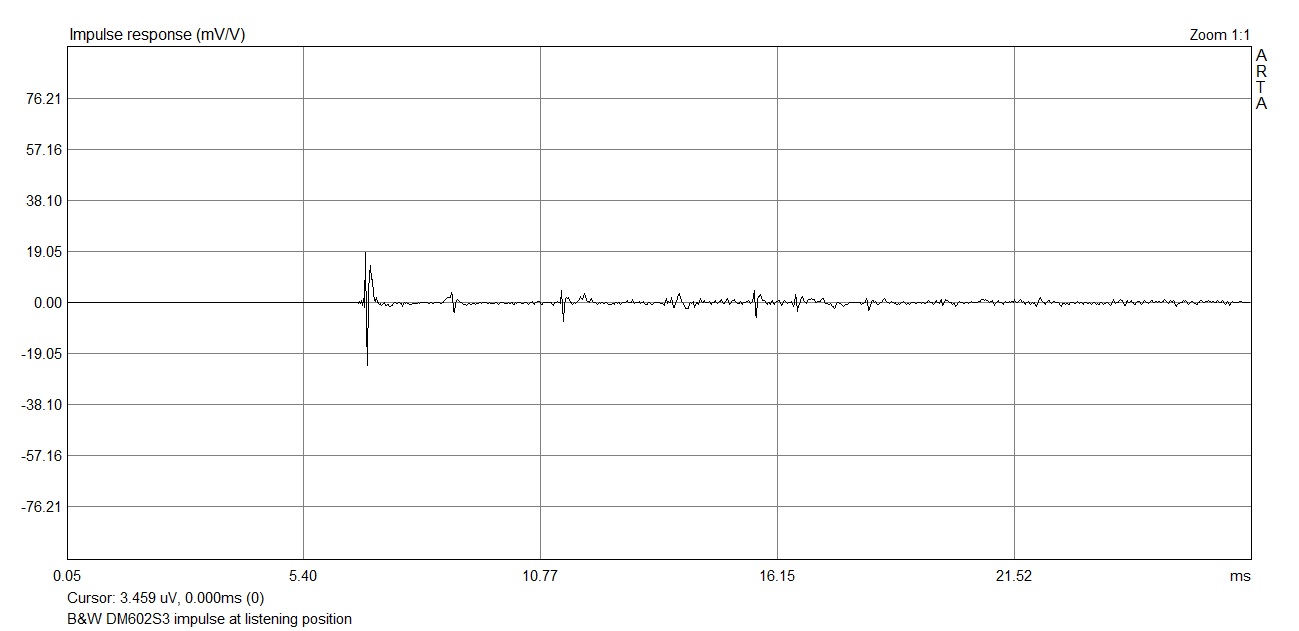

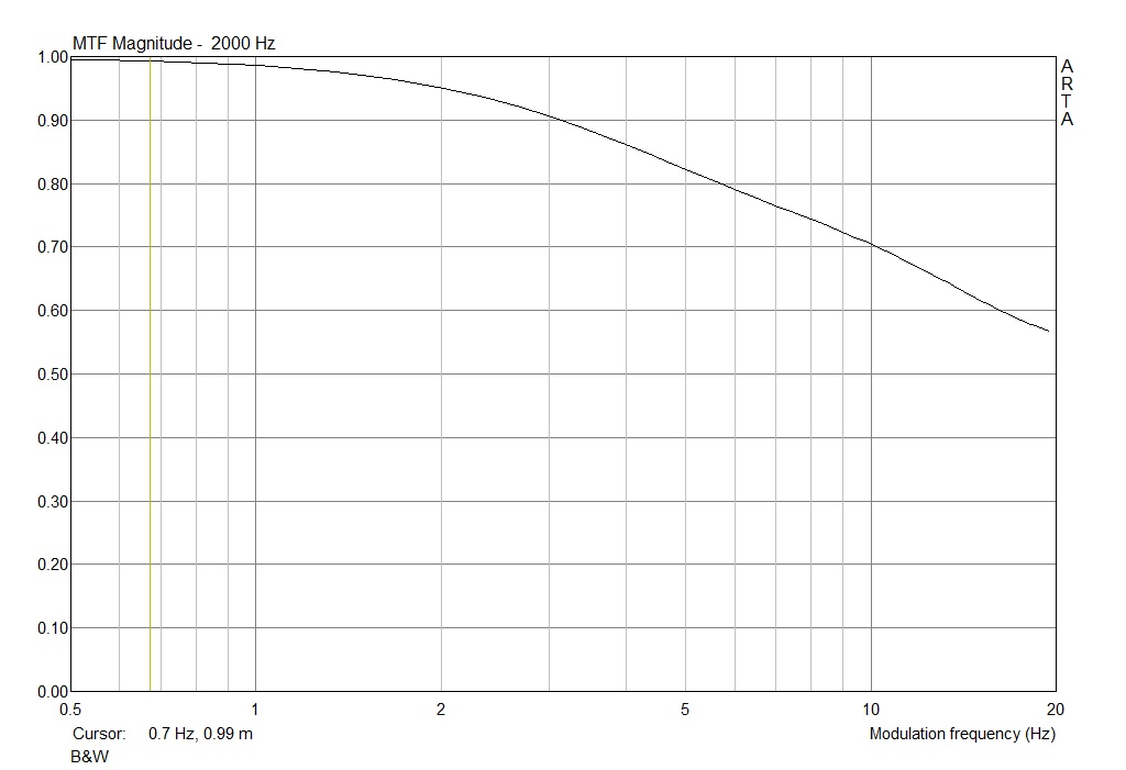

Here's some data on MTF as promised.
Again, the two speakers are JBL2445 on a large tractrix horn and B&W DM602.
For making these measurements, the speaker is in the normal position where they would be if I was listening to music and the mic is the listening position pointing straight ahead (between the left and right speakers).
ARTA says the STI should be measured at 68 dbA. Unfortunately, this was not possible because the minimum level in the impulse window is -20 dbFS. This means the hugely efficient horns were pretty loud, about 80 dbA. And so, both speakers were measured this level.
First couple of pics show the two impulse responses measured at the listening position. The horn impulse clearly has reflections at a lower level than the B&W. (The first pic is the horn impulse, even though it says B&W)
Next pics show the MTF for each speaker. Again, ARTA doesn't allow overlay in these charts, so they have to be exported one by one. Not much difference here between the two speakers. Speaker identity is in bottom left corner of charts.
Finally, we have the STI chart. Again, not much difference between the two speakers. Last chart is the B&W.
I can send the pir files if anyone is interested.

RA7, thanks for the measurements. It's easy to see the differences - but which speaker do you think sounds more dynamic? Or are they basically equal? I've often wondered if a dynamic passage were recorded from 2 different speakers would they actually show differences in amplitude? I mean average to peak amplitude.
Pano, the horn sounds infinitely more dynamic than the B&W. And no, I don't mean "loud" by this, as has been suggested. But its hard to find a measurement that correlates with this perception.
At lower volumes, it is easily more intelligible than the B&W. Hmmm.... maybe there's something there.
