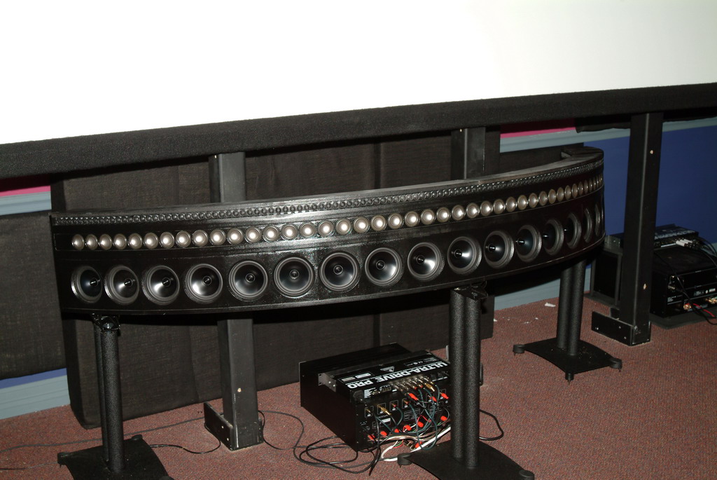

But some have made a laying center of CBT. I wouldn't have done it like that though.
That center will exhibit a radiation pattern that is vertically very wide (which in turn will send a lot of energy to the ceiling and the floor) and horizontally very narrow? How can this be desirable?
That is not the speaker that I entered in the Challenge. It is my first prototype. It was pretty good, but very large and cumbersome and I wanted to make something so simple and cheap that it would prove my point about radiation pattern being the main design factor in creating the AS. I was just as surprised as the rest of them that it won.

Perhaps a modified beamform/shading technique is used here?That center will exhibit a radiation pattern that is vertically very wide (which in turn will send a lot of energy to the ceiling and the floor) and horizontally very narrow? How can this be desirable?
It may have been modified differently. I haven't had time to read about it (se links). I would personally use a standing CBT behind a screen.That center will exhibit a radiation pattern that is vertically very wide (which in turn will send a lot of energy to the ceiling and the floor) and horizontally very narrow? How can this be desirable?
Center Speaker
CBT array center speaker data
Gary Eickmeier
Thanx for coming by Gary. I thought it looked different to the one in the challenge, but like I said, there is no info on the web other than some pictures.
So, whats the configuration of the one from the challenge?
I would much rather have it this way than rotated 90 degrees. But of course I'd rather controll the directivty in all planes not just one.
Center Speaker
Bjorn Thanks for that link - the first time that I have seen decent data on a CBT. Not very impressive to me and not surprising either. A polar map of that data would look very bad.

What prevents it from becoming omni below 300-400 Hz like other box speakers of the same width do? And what prevents dips in the 90 degree response from cone cancellation? The vertical pattern on the forward axis may be well controlled, but I'm not seeing anything in the design that controls horizontal pattern . . . (and I didn't hear any such control, either).The absorbent behind the speaker does little. The frontwall contribution is well below -20 dB with no treatment and short distance.
