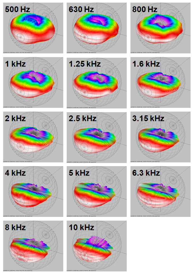

It's a polar of a smaller CBT prototype speaker. A larger and taller CBT will have controlled directivity much lower in freqeuncy then this one.
Vertically the speaker is almost perfect. And you avoid early reflections from floor and ceiling to a large degree. The CBT disperses wide but the response is very uniform. So one can choose between lateral contribution for a spacious soundfield or choose to dampen/redirect them in order to get the sharpest image. You don't see the typical beaming here, hence the power response is more uniform and with less colouration.
It's not necessarily the best speaker in every environment though. Like several has pointed out, the room and treatment always needs to be taken into the account. The CBT can overload a small and naked room with it's dispersion and all it's drivers. It can end up sounding too hot. In those cases a speaker like horn or waveguide with a more narrow ray may be a better choice IMO. Vertically, a horn and waveguide can not compare to the CBT however and the controlled directivity will not go as low unless it's encredible large. So the result will be some beaming and colouration.
