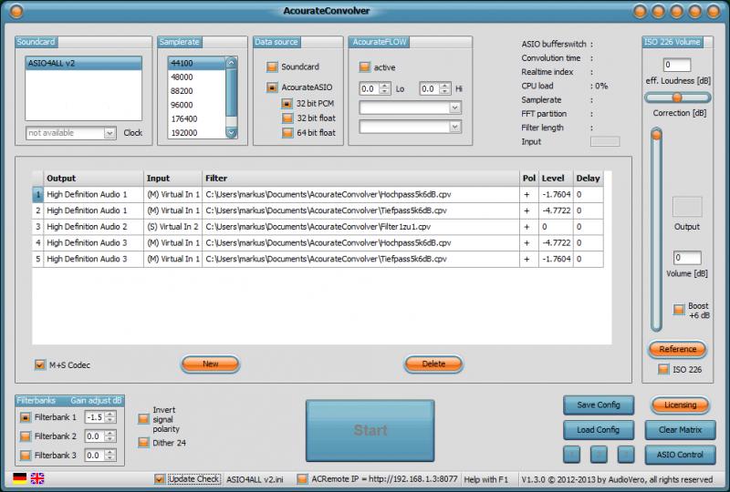

By the way, there will be a software matrix decoder available soon. Please see:
AcourateConvolver - AudioVero
This is what it will look like:
