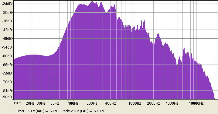

I can clearly hear the upper and lower parts of the split, which indicates that localization is still happening <700Hz for me. I don't know what other people would hear, or where the cutoff might be. FYI, that voice has almost no content below 80Hz. See below.The voice can be heard either from the centre or the side with a fair amount of credibility, by choice.
Voice is only one part of music, I am sure that different instrument spectrums will yeald interesting results, and anything will count to some degree, the question really is how all this effect a design, which really is up to the designer to decide. If the designer cannot make sense of any difference, and associate it with technical issues, then designs generally may not have consistency in sound characteristics, and even more difficult to achieve improvements.
