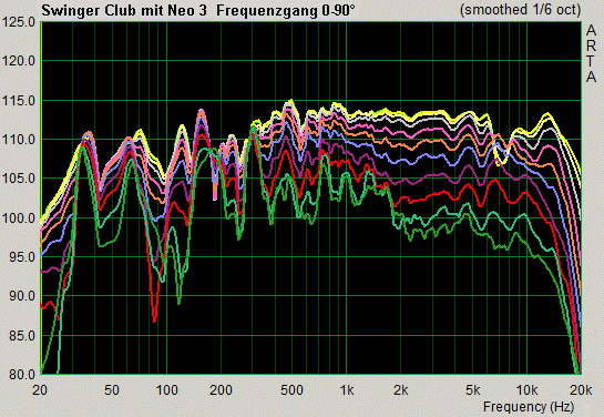

Is your 500 Hz (and below) system dipole (with a decent null at 90 degrees)?
In-room measurement - which shows that below 300 Hz modes are ruling everything.

At two meters? At one meter? At half a meter? At a quarter of a meter?
In any event, there does appear to be quite a lot of pressure loss just below 500 Hz off-axis.
Have you tried rotating the <500 Hz portion with the most extreme condition of pressure loss nearly facing your position (with music)? (..say, 80 degrees - outward or left of left speaker, right of right speaker?) And from there eq.ing it flat from your position?
