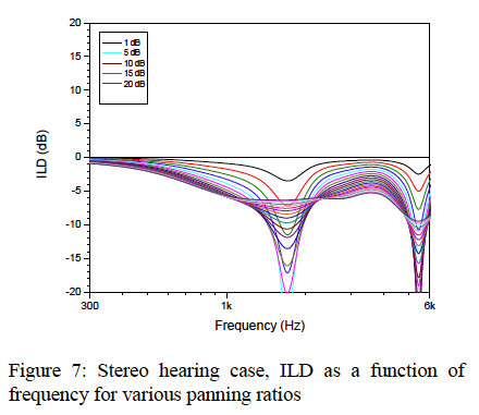

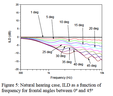

Now this one is interesting. It shows how different interaural level differences look between natural hearing and 2-speaker stereo:
attachment.php
attachment.php
From Benjamin, Brown, AES Convention Paper 7018

The important data is in the Benjamin/Brown graphs I had posted. It uses a diffraction model. The data shows that there's a huge error in localization cues around 1-2kHz. This might be the explanation why the barrier works.

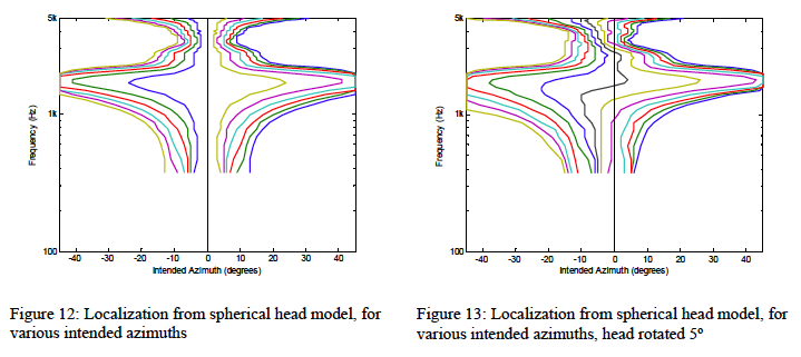

What could explain that in a barrier situation the head can be turned quite freely without the same kind of image collapse as in stereo triangle ? Did you notice this effect too ?
Yes I did notice the effect too. Benjamin/Brown show the impact of 5° head rotation:
attachment.php
We would need to do our own measurements at the ears to get comparable data with and without the barrier.
