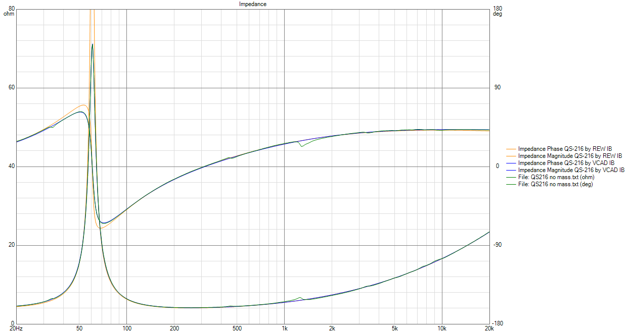

Already shown differences by simulating driver in infinite baffle and comparing to free air measurement. VCAD is the closest match full range. speakerbench.com very good match at LF, but small differences at HF due to differences in extended Z model parameters. Worst match with T/S by REW. Qm looks way too high. I've not verified has Ritter 3PC something to do with this.

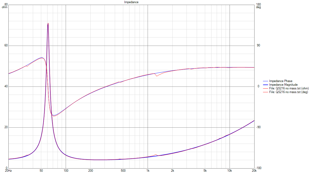

One more comparison: impedance response in IB with standard T/S (LOG model unchecked -> beta=0) by VCAD compared to free air measurement. This is also good enough for typical radiator simulations.
Comparison is easy to repeat with any other simulator supporting IB and extended impedance model with Le, Leb, Ke and Rss.
Kimmo, impedance curves of the same loudspeaker measured under the free air condition and in the infinite baffle should be different because the air mass loading to the cone in IB is twice as in free air (i.e. IB lowers lodspeaker resonance).

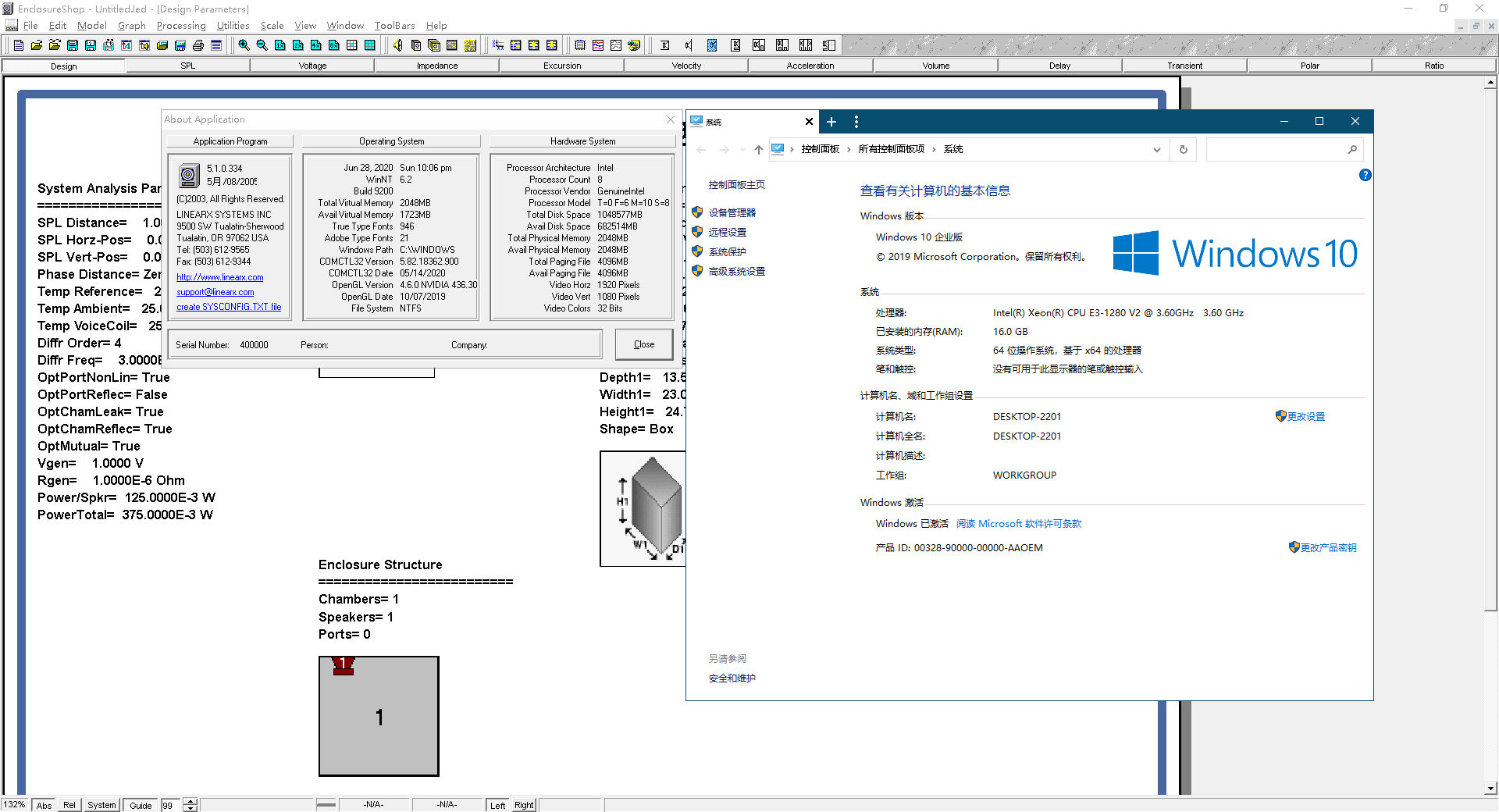

I got the Enclosure shop working. Is there steps for Filter Shop to work?
Glad ES is working. I don't have FS. If it has a USB dongle, you may be able to test-sign the driver and run in the test configuration as for ES & CS.
If you try that, please share your results.
