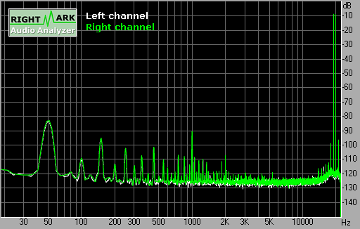

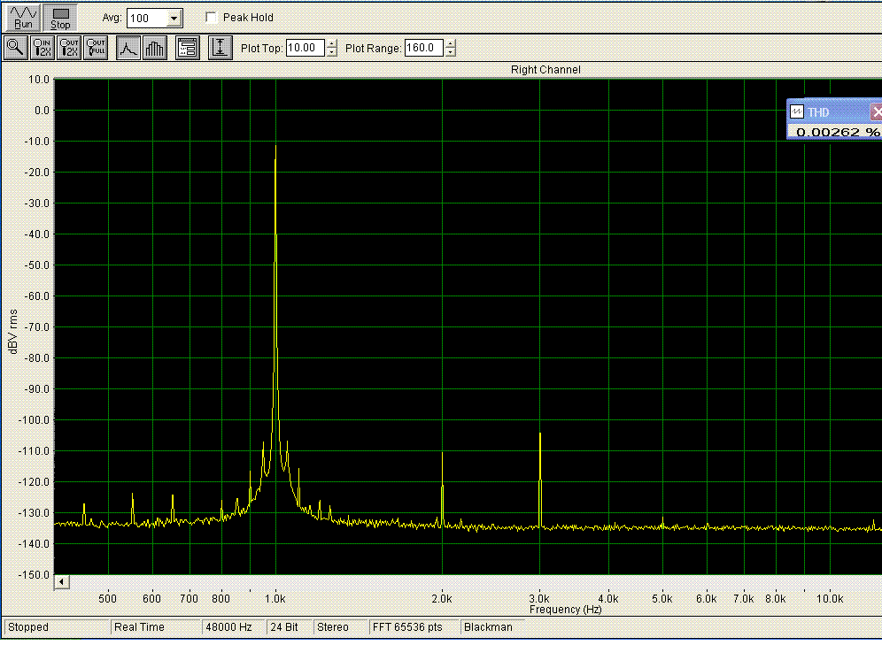

Gordy said:
The results state Noise as -98.6 , but then the graph shows a noise floor at approximately -130 . I do not understand... what am I missing?
There is a difference between noise-level and noise-floor visible in fft.
For example, a full scale white noise would give a noise-floor typically at somewhere between -30db and -40db in the fft (depending on the window size).
Mike
You are missing the FFT basics. Narrow band noise floor depends on number of samples in the FFT record.
Theoretical SNR noise floor is:
SNR = 6.02N + 1.76dB + 10 log(M/2)
N ... number of bits
M ... number of samples in the FFT record
This is just narrow band noise floor.
