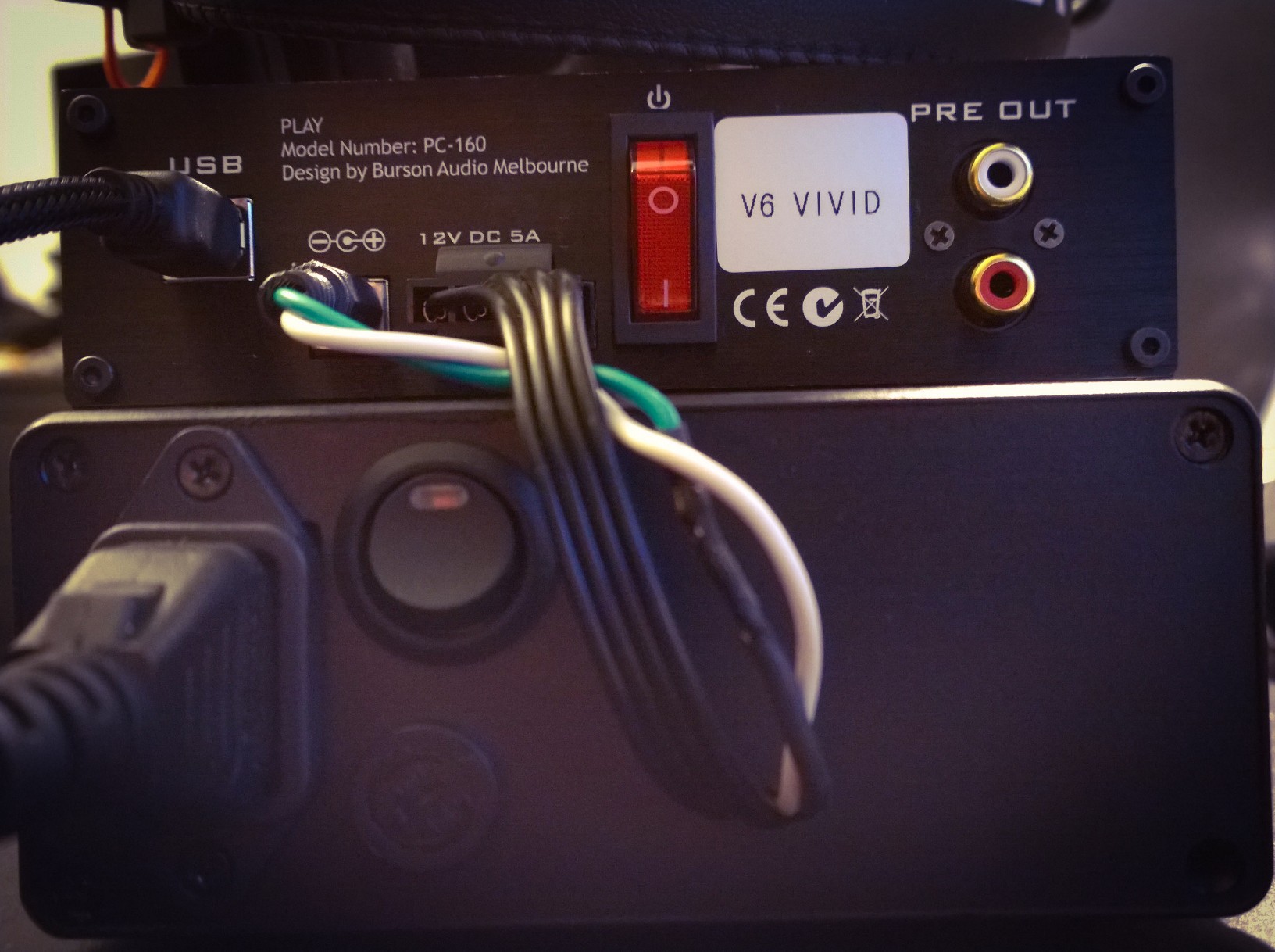

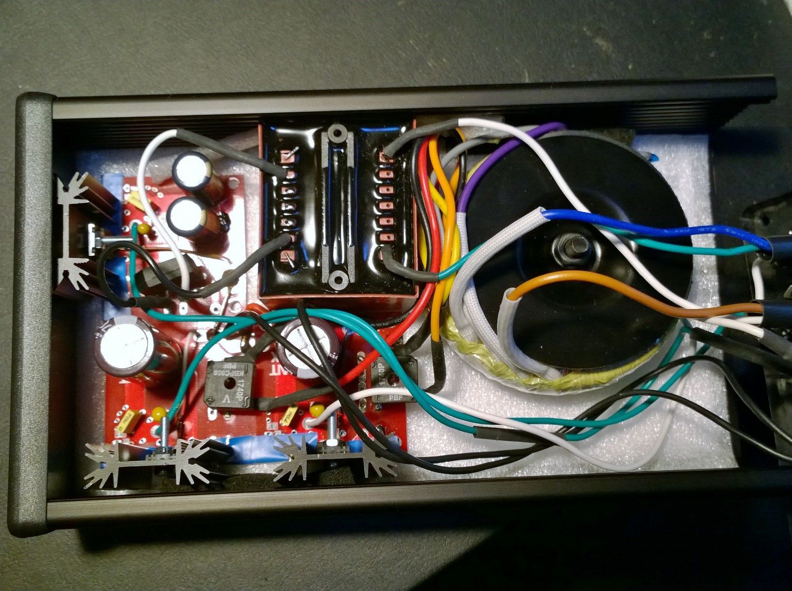

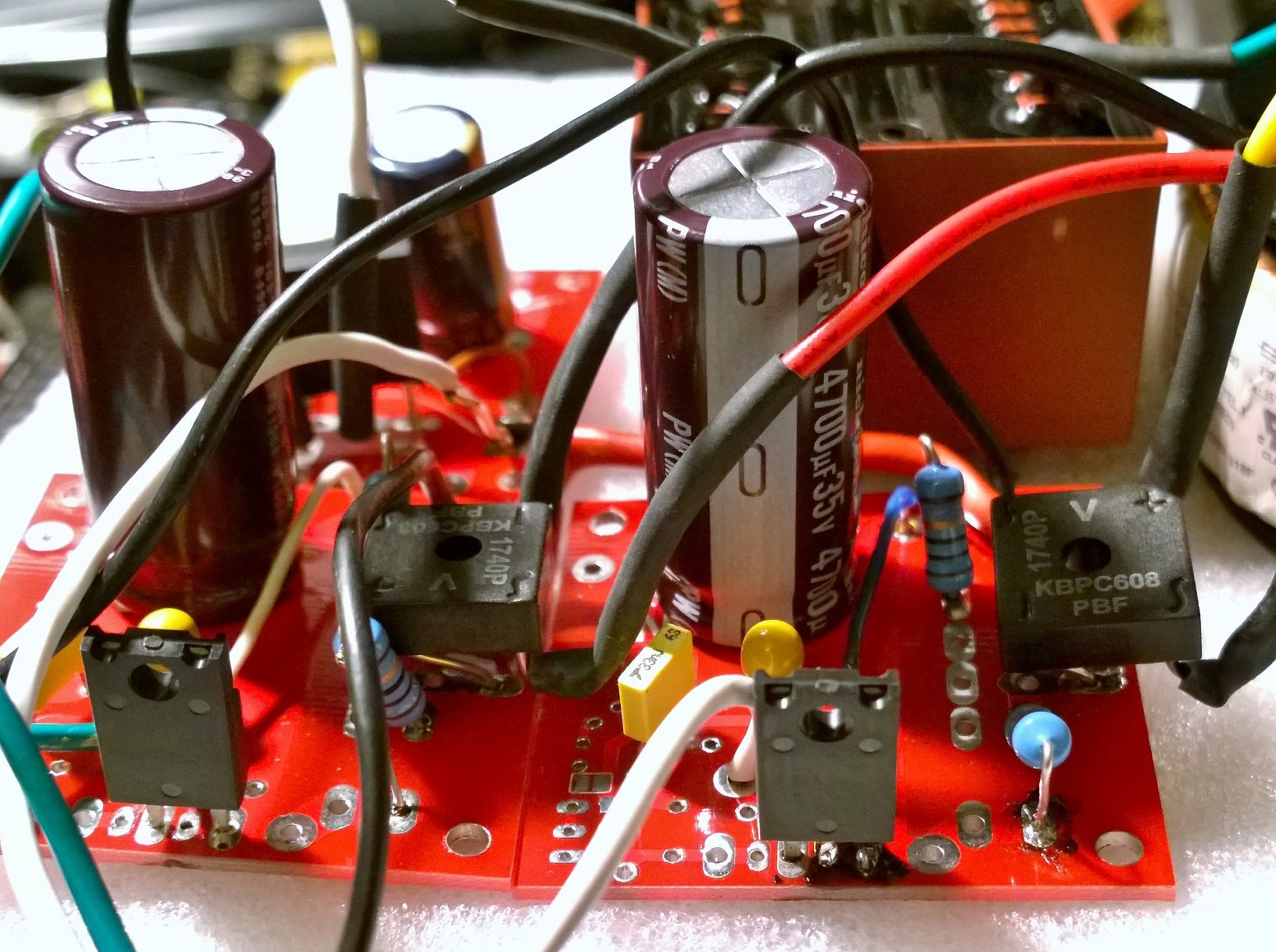

I've also attached few pics with the test PSU I've made almost 1 year ago to test a PCB board from a piece of equipment (PLAY V1.6 from Burson). There are 3 linear regulators: LM7812, LM7815, LM7918.
Not the best looking PSU, but everything worked as expected, so I'm quite happy! This replaced the power brick and internal XLSEMI boost-converters.
L.E.: Regulators are Japanese NJM, because I've seen better specs than similar regulators from ST, TI etc.

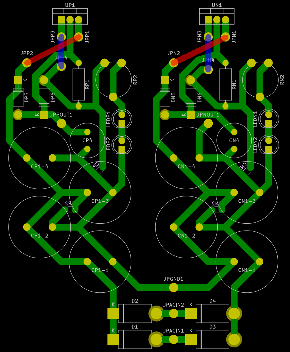

Could you help me please?
I'd like to use it in a symmetrical variant with an one-sided panel.
Is my schematic OK? (Changes: 1*4 4A diodes instead 2*4 2A; 2*4 2700uF caps instead 2*1 10000uF.)
I need +-25V output. Is 29-0-29 input correct? (29=25+1+1+3 (output + rect.diode + rect.diode + lm338))
Is my PCB layout right? Blue and red lines are jumper wires on component side. SMD caps are on copper side.

Sorry for my english.
I apologize for my previous post.
I realized my mistake and modified the original design to a multi-capacitor version.
The panel is rough because my ability to make PCBs at home is limited.
I left a gap between the capacitor columns so that the fixing hole of the IC could be accessed with a screwdriver.

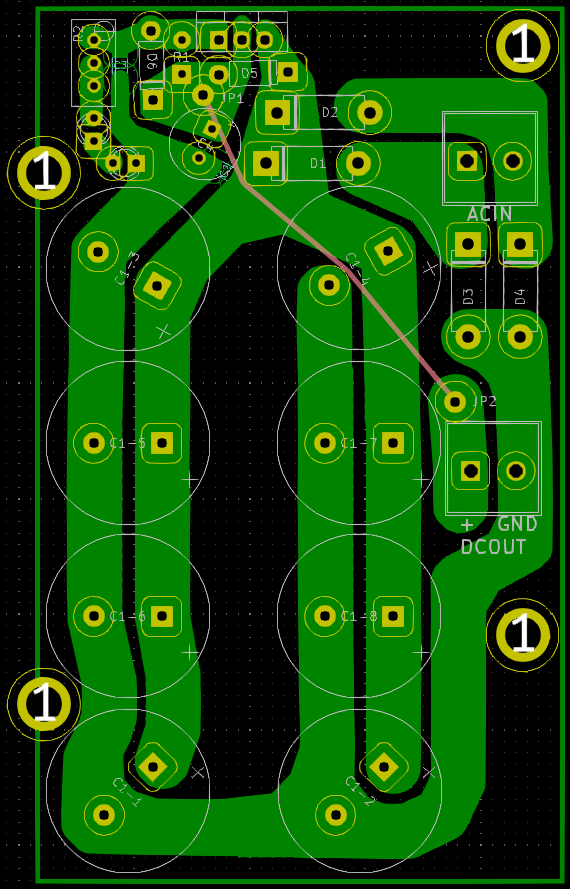

I do have some PCBs and I use them for fixed or variable voltages too. All you need os to respect the main schematic, based on the regulator used, while double checking the PCB traces and measure everything with a DMM.
Thank you. So looking at the schematic, do you just short C1 ground to C3 ground and ignore D5, R1 and D6 (as well as the adjustment section)?
Not sure, I don't have the PCB in front of me, but by looking to 1st page pictures seems that these caps are already paralleled. If you have such a PCB, just use a good light and check the traces, then simply follow the schematic from your regulator's datasheet. Depending on the regulator used, some small modifications might be needed, but nothing not to be handled with ease.
