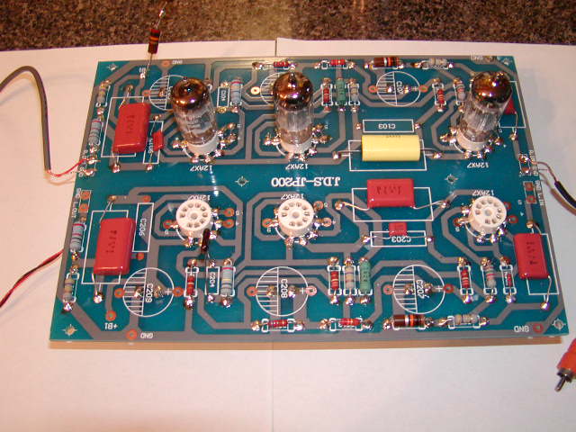

Line stage board off from overseas. problems
Jan
I don't have many values on hand but I found that this one got rid of the problem of the voltage ramping up and down on the output. It looked like a strange oscolation(sp). When I disconnected it the problem went away so I assumed it sure wouldn't hurt to try a different value. When I tried the 27K it acted correctly without a ramping problem and still gave me the same output. just running the output to the scope I get 29V rms out with 3 volts in, the same as before.

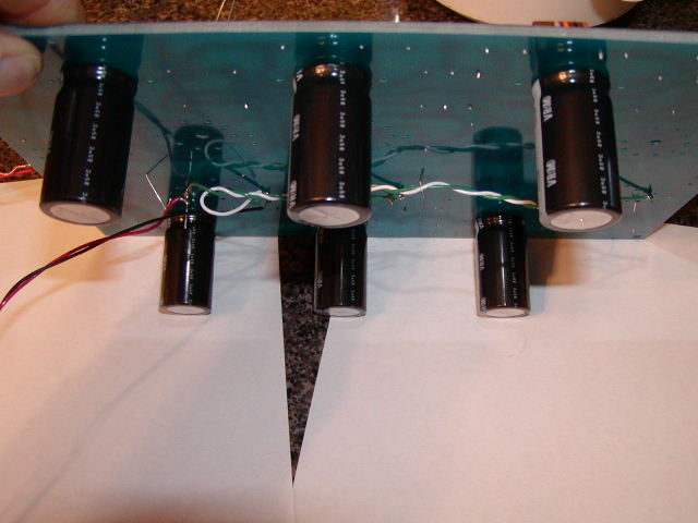

I made a twisted wire pair from 1" of #22ga wire and twisted the two together and soldered one end of each and floated the other end. Is this correct to replace the cap in the feedback loop?

Yeah, that 'cap' seems OK. It was a standard practise in the hf world long time ago, don't know if they still use it.

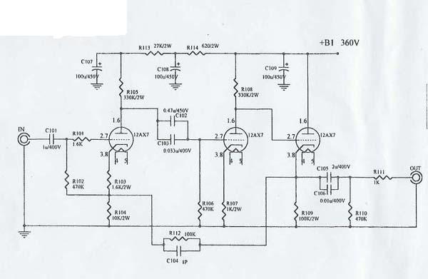

I thought that the change of R102 to 27k would *increase* the problem, as it give stronger bootstrapping to the input, which is a form of pos feedback. But there probably was some phase shift through that 330pF turning it back into neg feedback. Funny how complex simple circuits can be...

I am wondering if it would be of benefit to change the 470K R110 value to 100K?
It would speed up discharging the cap, yes.
As a side effect you may get somewhat better dynamics as well...
Where the heck does that dinosaur of a circuit come from anyway???
Geeeezzz.........:xeye:
360V on that CF's plate seems rather steep too....
If you'd use a split cap configuration on the output you could at least do away with the input cap (C110).
That should improve the sound.
I think Jadis reworked the thing later on to use a lower B+, a 12AU7 CF as the first triode followed by a 12AX7 direct coupled to a 12AU7 CF.
Still needlessly complicated IMHO.

Can you point me towards a link for the Jadis schematic?
Not sure where it was I found it...
Probably one of those Asian sites I guess...
Not even sure it's an actual Jadis circuit.
It did say so where I had it from but I'm starting to doubt these folks' sanity lately...(I'll leave it up to a guess as to whom I'm refering to......)
I took the liberty to add some comments.
No idea what it sounds like, you'll probably be running it with the handbrake firmly in the up position given the gain of the thing........
Cheers, ;)

I have hum in one channel as I haven't fired the other one up yet until all bugs are gone. It will have same hum I am sure.
Hum stays at the same level and makes no difference with tube swap. I have a box of 12AX7 tubes and have tried 9 with same result.
I would think that with DC on heaters it would be quiet.
I need a tall glass of red wine, maybe the whole bottle. Good thing I am on vacation now.
Any ideas?

If you feel ambitious, disconnect the feedback loop, short the input of the cathode follower to ground and see if you still have hum.
Ah, you are thinking that with about 20db of gain my problem may lie there? I will try it.
No, simpler than that- I'm trying to see in which stage the hum is originating by working backwards from the output. Thinking a little deeper (i.e., clearing my throat after saying something stupid), I realize that you can't actually take the CF grid directly to ground. Best you can do is take the second stage tube's grid to ground. So, OK, let's start there.

Check the 12AX7 CF output tube cathode voltage. If its above 100V you may need to cut some tracks etc. to float its heater supply (use the raw AC). By "float" I mean really float it with just a cap from one side to 0V or alternatively tie it to say +80 to +100V DC.

Voltages across the resistors: With 360V feed.
R103 .908, R104 17.4, R105 198, R107 .760, R108 246, R109 112
To me it would appear that the 112V was too high across R109, and I don't think the cathode voltages are correct in the first stage. Can I rebias both the cathode follower stage and the first stage or am I barking up the wrong tree? Can I re do the first stage and remove the feedback connection and jumper across R104? That would put R102 to ground(470K) and give me a cathode resistor of 1.6K.
