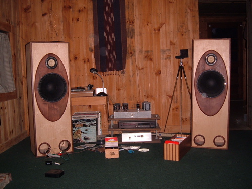

Yeah, sorry maybe I could have given more background info. Anyways.... I'll attach a picture. There are not many options for placement. I've tried different distances from the back wall, setting up the speakers to form a triangle with the corner as one point (this sounded best, but put the sweet spot somewhere between the kitchen table and the front door). I've also pulled them pretty far out into the room, farther than I could have lived with, still to no avail. The room is an old southern style log cabin which is made by stacking logs, then filling in the gaps with concrete (14'x22'x7'). I've had horns, and other BR speakers, all exhibit more or less the same bass issues. I'm now listening to MLTLs. I've thought of trying a more mechanical solution such as stuffing the ports to give it a more aperiodic approach, but I believe this will just cause a loss in most all bass. I like my bass, just not the 80Hz peak.
