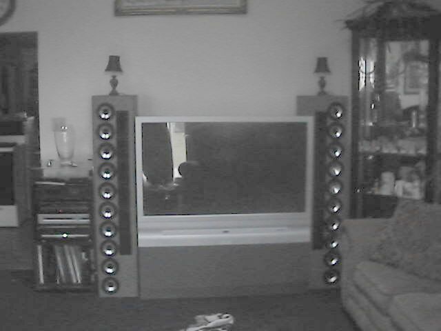

I know that this is not your intended Line Array.
With this setup I don't need a Center Channel nor Subs.
It's only driven by a 75 watt rms amplifier.
Jurassic Park & Lord Of The Rings just literally shake the room.
As far as seating goes, anywhere on the two couches in the room are fine. There is no sweet spot, just a sweet area. In fact I prefer to be on one side or the other.
Just letting you know a line array is ideal for home theatre.

something bigger than normal and people 'ooh and awe' at the
loudspeaker assuming it sounds good without even listening to it.
I've had people come over and freak out on the 90" towers
and they make the 'wow' comments and I haven't even turned on
the speaker yet.
/joke
Perception of sound quality = 50% design, 50% mind tricks.
/hehe
