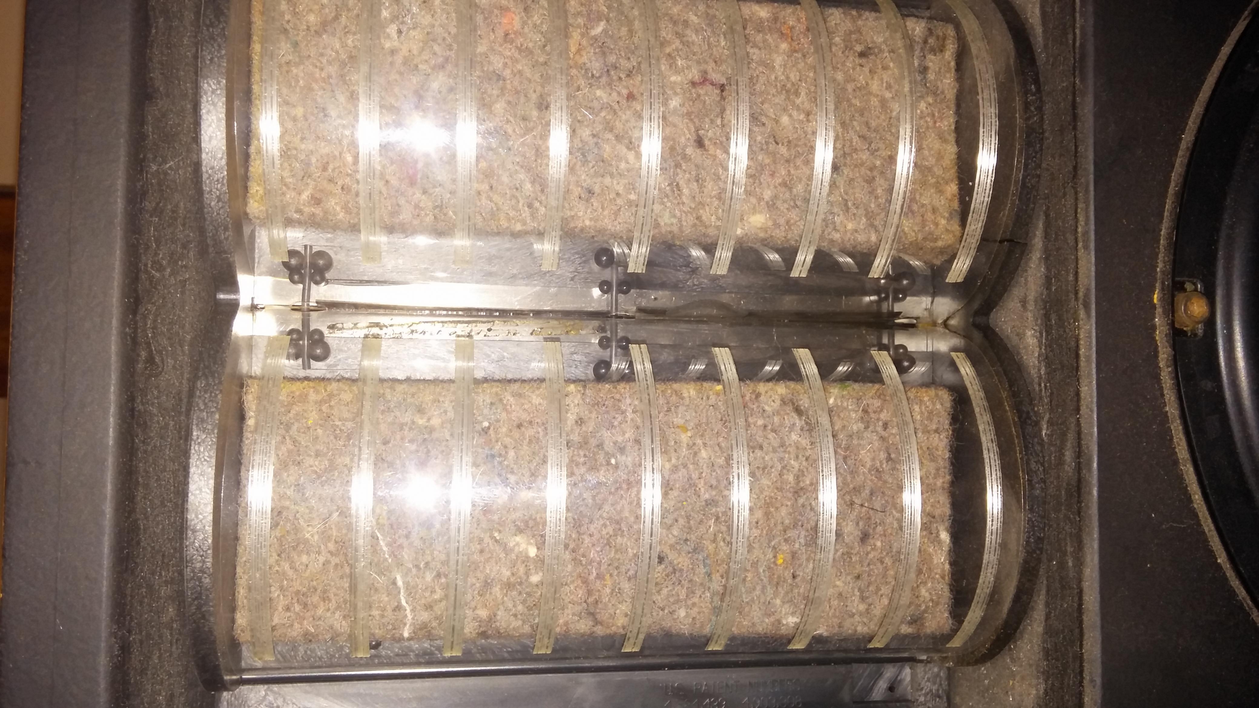

Picked up a pair of LT1000 with tweeter issues. They seem to have come out of the center seam. If I gently poke around with my finger they spring into life. I'm assuming where the two clear pieces meet, needs to be tucked somehow into that center seam? From that horrible description am I making sense and is this an easy fix? I've searched but find nothing on these tweeters.
AM slowly building a "stack" of these tweeter/mids and find they come in a number of different incarnations. Are these Monopoles? From the looks, I suspect they're equipped with ferro fluid which should help keep them centered L-R but maybe not front to back. Keeping/getting them centered (F/B) might be easier, I would guess, with dipoles than monos. Maybe a little tugging and hot melt (or super glue?). Possibly more ferro fluid. X over is comparatively low 500 to 1.5K (??) Have lived with two pair of LT1000 per side for a few months and am only moderately impressed but my electronics were marginal (TV system) and the woofers (which I will eventually discard) were dismal esp. in very small enclosures. I have heard these units sound very good. These days, I'd guess, they're a little weak in the high end … maybe a small fabric dome tweeter, ring radiator or more exotic ribbon/heil. I have a few small Radio Shack "Llneaums" which might also mate well. Good luck.

From what I have seen they just clamp into place. Perhaps they have pulled out or the bond has broken?
Looking at the picture..there seems to be a metal rod running up the middle has it come out of the top support or hole ? (left middle of your picture)

looks like its deformed from excess heat (overload)
or maybe it can be adjusted
any chance the felt have come loose and touching the diaphragm ?
